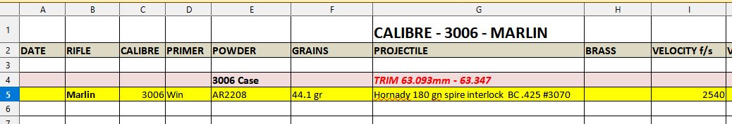

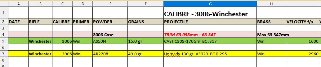

Post by Oldbloke » 08 Sep 2021, 3:22 pm
Here are my loads. Both pretty mild. I just use AR2208 for everything. Works. LOL Velocity is an estimate only.
Both are 0.020" off the lands

Oldbloke wrote:Here are my loads. Both pretty mild. I just use AR2208 for everything. Works. LOL Velocity is an estimate only.
seems very off to me, 30-06 running 130gn getting under 3000fps, nah... not at 49gn of 08, my 270 runs 3150 on the chrono with 130gn at 45gn at 300m above sea level. seems off to me.

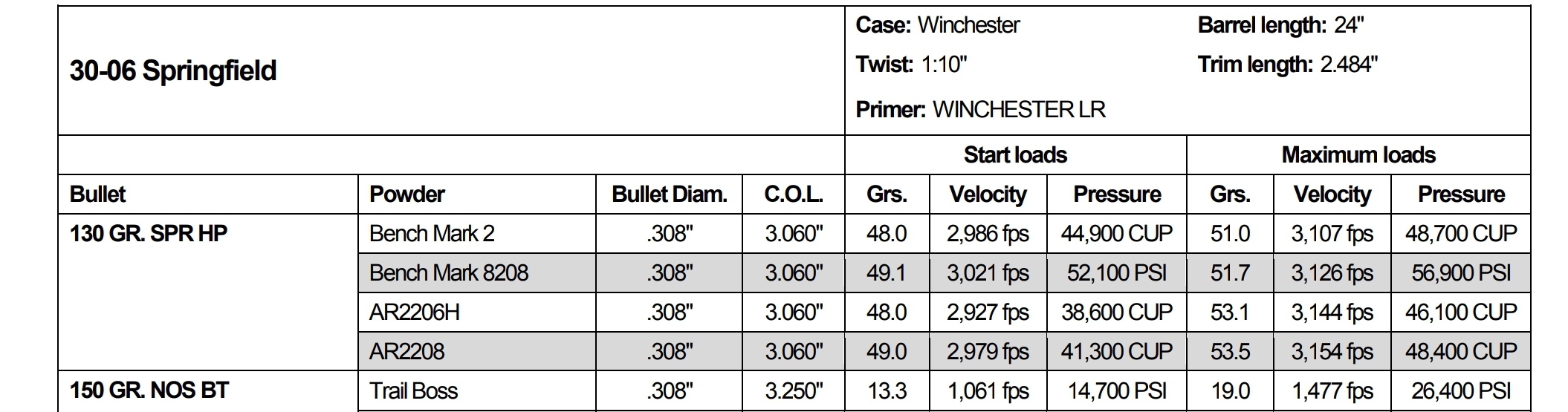

Mmm, well perhaps your right but the ADI 9th Edition guide says;
My barrels are 22", so, I knock off a bit.
Frankly I don't care if it's 100fps out either way. If I do my bit they seem to fall over without questioning how fast the bullet was going.

Post by Oldbloke » 09 Sep 2021, 12:00 am
Oh, ADI use 24" barrels in most cases.
