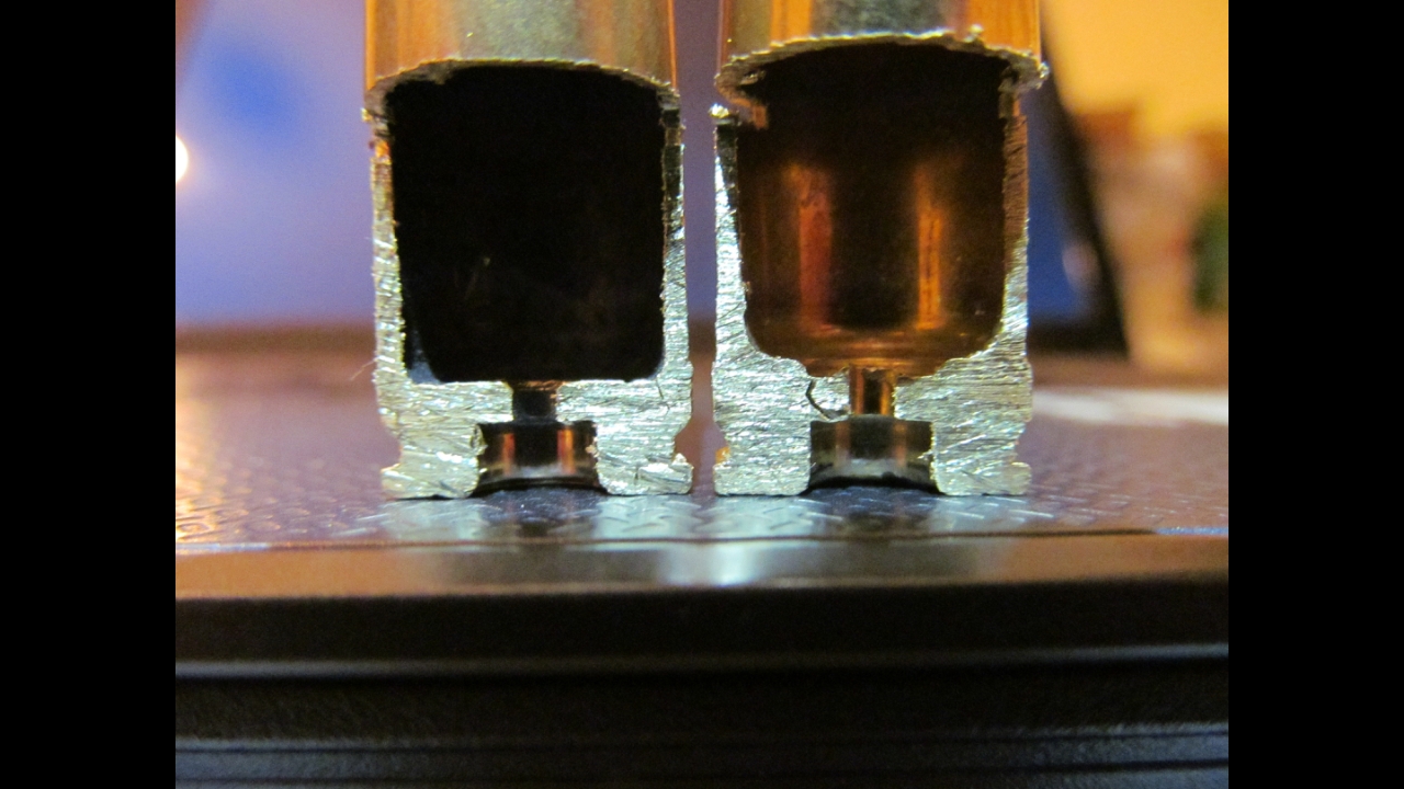

Thanks BR. That's all really helpful. I'm be sure to revisit this once I can actually start loading and shooting.
When you talk about the ring around the case body, does this image show that? I was wondering about this, and in the books they talked about rings there being bad. These are from Remington 150gr core lokt factory 308

Yes, that's where the case is no longer being forced out against the chamber wall.
Be aware that sizing dies often only size down the same area though, which can also leave a similar mark. It only becomes a problem if the brass starts thinning there as eventually it will tear apart.

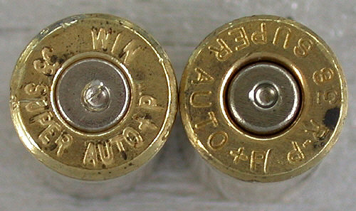

Post by Oldbloke » 08 Sep 2021, 10:34 pm
There are more experienced that me here. Im sure they will express an opinion. Lol But IMO the one on the right is a normal load.
The one on the left, more flattened and some "cratering" around the firing pin dent. IMO, about max. I would back off 0.5 grain.
The one on the left you would only need to seat the bullet out a bit far by mistake to get into trouble. I think case life would be short too.

Post by disco stu » 08 Sep 2021, 10:43 pm

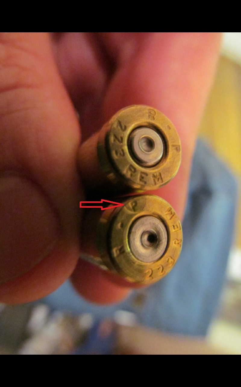

Post by disco stu » 08 Sep 2021, 10:48 pm
Oldbloke wrote:There are more experienced that me here. Im sure they will express an opinion. Lol But IMO the one on the right is a normal load.
(Pic is just off the www)
Sweet, thanks. What's with the mark seen in the "super" on the left and left to the "P"on the right? Anything to go by?
There are no other marks on the left hand case, and no smearing or similar. Do they normally come when going above the level seen here?

Post by Oldbloke » 09 Sep 2021, 12:06 am
Just "dings" from use I think. Perhaps been dropped on concrete.

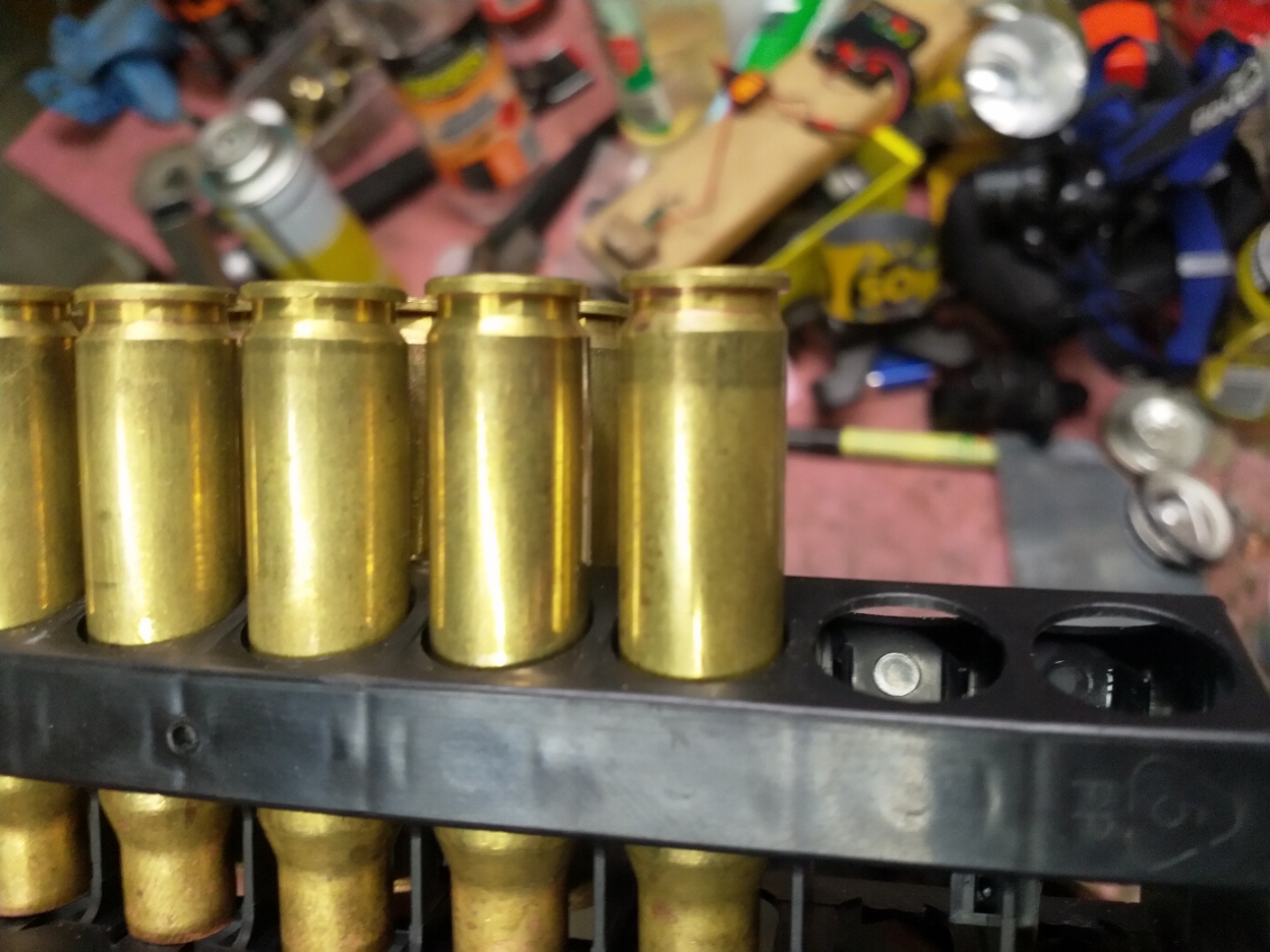

Yeah don't get too hung up about cratering I have a rifle here that will crater any load you put in it it needs the the firing pin reprofiled and sleeved .
The top one is a very mild load but the bottom is a load that was hot to test to see if it would Pierce a primer and you can see the ejector imprint on the case head (red arrow) you don't want to go here .
As long as your primer edges are still rounded like the top one is you are in good territory.

Post by disco stu » 09 Sep 2021, 9:48 am
Cheers deye243. Pretty clear comparison. Those rings you can see on the lower part of the bottom case, is that the "smearing" from lifting the bolt on over pressure load?

Post by deye243 » 09 Sep 2021, 3:08 pm
disco stu wrote:
northdude wrote:every one has their own ideas something I have found is some calibers be a little bit more tolerant of pressure. Also if you change the brand of brass that can sometimes cause pressure signs as the internal capacity of the case can be slightly different thats what ive found on a couple of occasions anyway.
Thanks. I was initially going to get a bunch of mixed once fired brass, but I now figure I really should grab a heap of the same brand for the reason you mention
Disco stu yes keep one brand of brass as you can see in this pic on the left is norma brass absolute rubbish if you want to run it in a 7mm Remington Magnum on the right is just a elcheapo Winchester case same Calibre far Superior Brass even though the case capacity on the Norma was more if you look in the bottom corners of the head there is no brass supporting just forward of the belt with causes it to expand excessively in this area and cause extraction problems you go mixing brass up different brands they all have different capacities which will differing point of impact.
