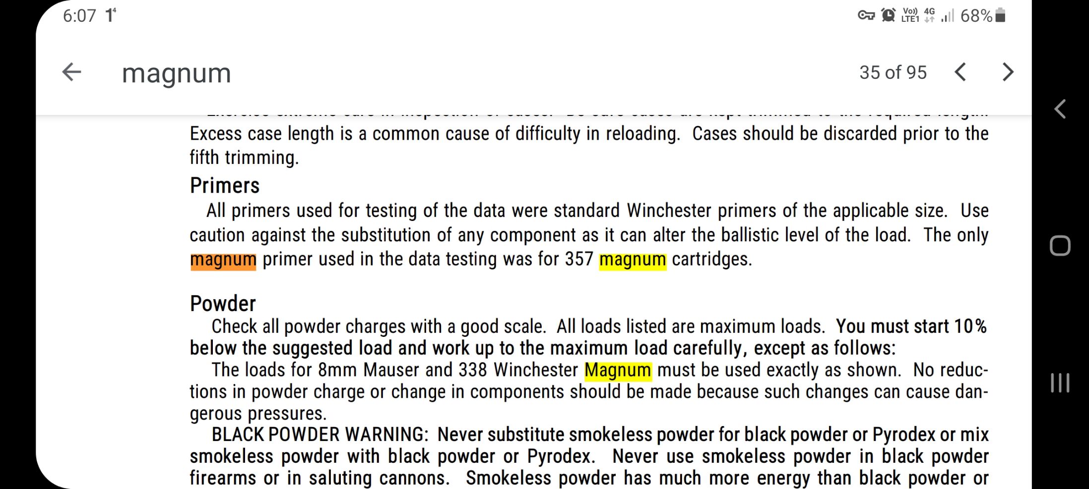

Sometimes the answer is staring you in the face. This is out of my old pdf Winchester loading manual.
Re: Win 748-magnum primers?
Post by disco stu » 31 Oct 2021, 5:25 pm
Thanks Old Bloke, again! I really need to read that manual more thoroughly
