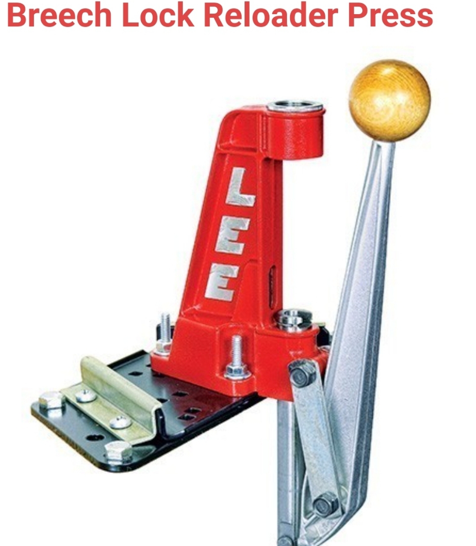

The vice die will work fine, you should only have to full length size every 3 to 5 loadings with brass from your own rifle. If you really wanted to incorporate a press mounted die you have 6 stations, go to a machine shop and have 1 station bored out and threaded to take 7/8th dies. Alternatively sell the Simplex and buy the Lee single stage then all your problems are solved, Cheers.
