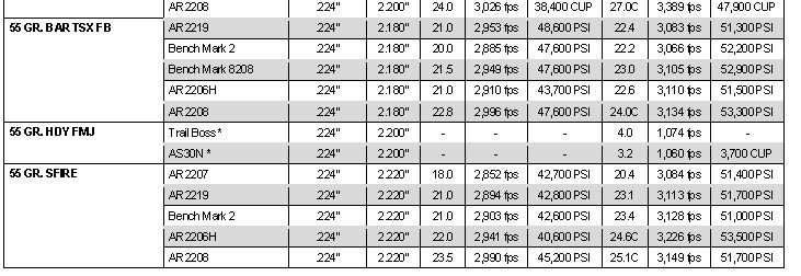

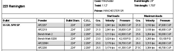

I see what he means. They list 3 different brands of 55 gr projectiles and the min and max is very different for all of them.
A Barnes max load is 22.6 gr while a Speer starting load is 25 gr. . I can understand the confusion
The Barnes is a copper bullet.
There will be a reason why, but there is a wide range . I can understand the issue.

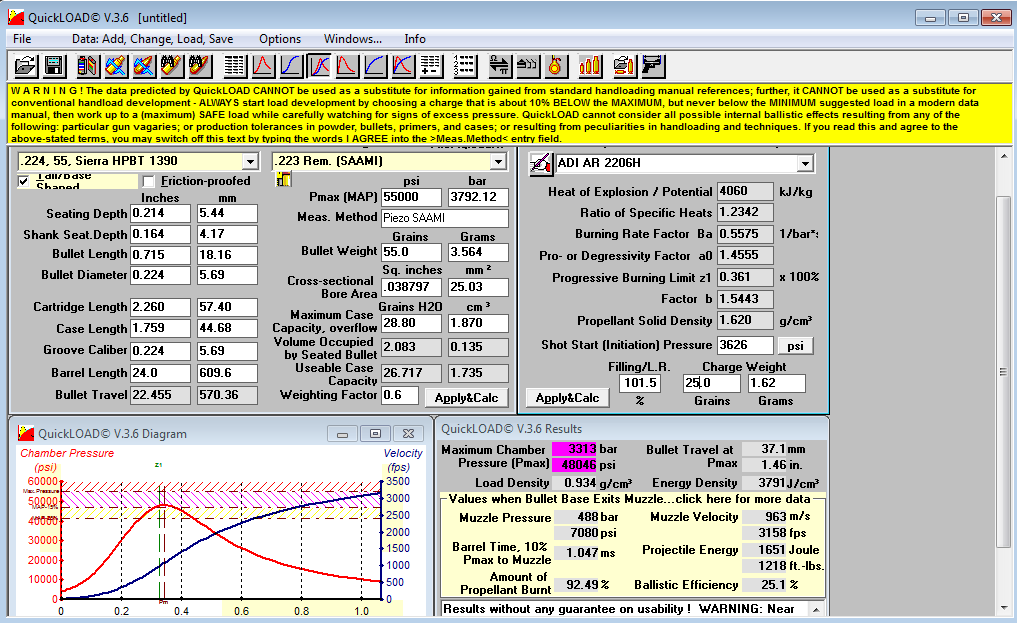

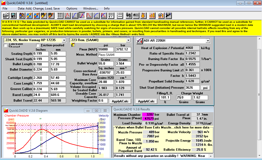

SpudLee, with the 55gr the limiting factor is case capacity, not pressure, so it's safe to go up to a full case of powder, which will be around 25gr (as already stipulated). Here's a couple of snaps for you from Quickload with your bullets:
55GRFBHPVARMAGEDDON
55GRHPBTSIERRA
To be safe, work up to this and watch the primers for pressure signs. But you won’t be too far North of 50kpsi. It's more the heavier bullets where the margin for error starts to narrow.
Down the track, you may like to try a heavier bullet, better suited to your 1:8" twist. You will likely still get decent accuracy with the 55gr, but technically the 1:8" is perfect for roughly a 70-80gr bullet.
