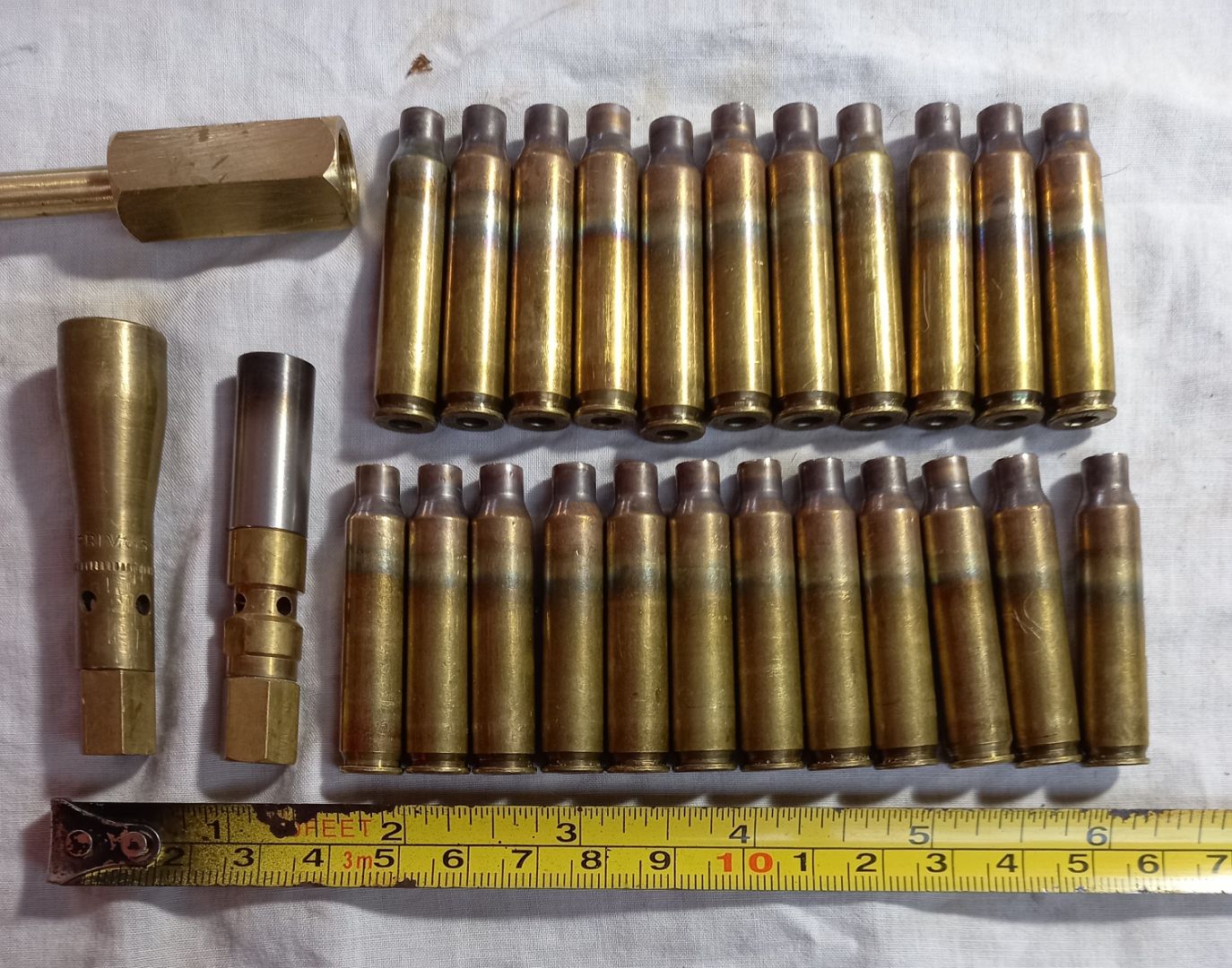

Yep, I sounds it, just 1 or 2 seconds. Blue or grey is the go. But if they are resizing OK just keep using them . After you fire & resize them they should harden up a bit and be OK.
No need to quench brass does nothing. I drop them on a damp rag to just speed up the cooling process.
I think there is a lot of miss-information out there about annealing. Ask a sheet metal worker. I can remember at Tech School we used to anneal copper by heating it up red hot in day light. Beat it a bit with a hammer and it started to harden again. So do it again. LOL I know it's not exactly the same but IMO a tad too hot makes little or no difference. ( might be different if you in the world championships. LOL) When I first did it it was the heat till red hot (during the day) and tip over into the cold water. Only ever had 1 or 2 crush the neck resizing.
All this stuff you see on youtube with $500 annealers is for blokes with OCD
https://www.betterhealth.vic.gov.au/hea ... e-disorder
I just count. Once you get it right just repeat.
Here is some I did a while back. Same method. 4 seconds for the 223 with the large burner. I'll use the small one next time for a bit more control.
223 4 sec.jpeg (265.07 KiB) Viewed 6799 times
