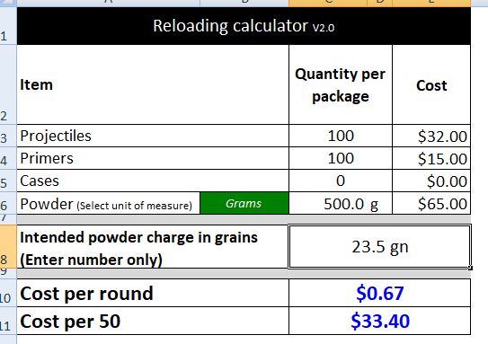

Post by Oldbloke » 03 Feb 2022, 9:20 am
Easy to work out.
Here are some current costs (aprox) but not including delivery if needed. You can work it out from there.
