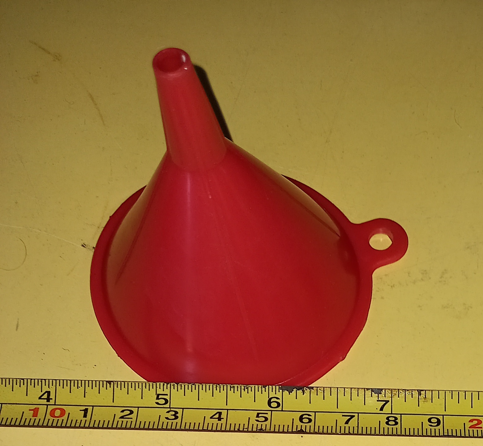

Small funnel.
Trim to size, cut some slots along the side and put it in up side down. Should work

Oldbloke wrote:Small funnel.
I agree mate. That would also work a treat.

Post by Oldbloke » 10 Apr 2022, 9:17 pm
lcpltac wrote:https://www.ebay.com.au/itm/265443198339?hash=item3dcda5c583:g:I2QAAOSwFUVhsTf~:sc:AU_StandardDelivery!6254!AU!-1
Bit small for a Dillon but good for most others.
Me thinks easy to make
