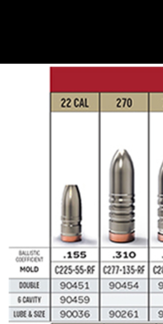

If you can find a .224 mold

bigpete wrote:Of course, you could also cast and powdercoat them instead for very little cost.
If you can find a .224 mold[/quote]
I have a .225" and an old .227" mould.

Post by bladeracer » 05 May 2022, 9:45 am
bigpete wrote:Hold that comment,I see CBE does a few
I think everybody does .225" moulds, including Lee.
Re: home made 224 projectiles
Post by Oldbloke » 05 May 2022, 10:12 am
Yep, Lee do a 55g.
How fast can you push powder coated bullets? 2500fps?

Oldbloke wrote:Yep, Lee do a 55g.
It's not written in stone as there are too many variables, but yes, 2500fps is common I think. I have seen people claiming over 3000fps with cast in AR15's though.

Post by Oldbloke » 15 May 2022, 3:51 pm
Was just killing time and noticed the Oz Gunmart have double molds for $49 + delivery.
Just add powder coating and gas check.
Post by bigpete » 16 May 2022, 12:06 pm
Oldbloke wrote:Was just killing time and noticed the Oz Gunmart have double molds for $49 + delivery.
Where would you get the gas checks?
Posts: 4190
Post by Oldbloke » 16 May 2022, 1:19 pm
https://support.leeprecision.net/en/kno ... i-need-one
Just shop around I guess. Or buy the tools to make them.
