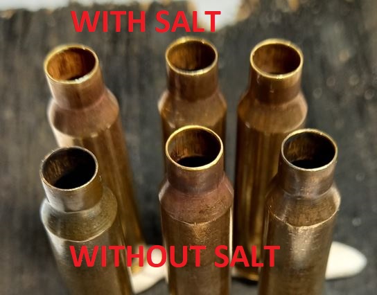

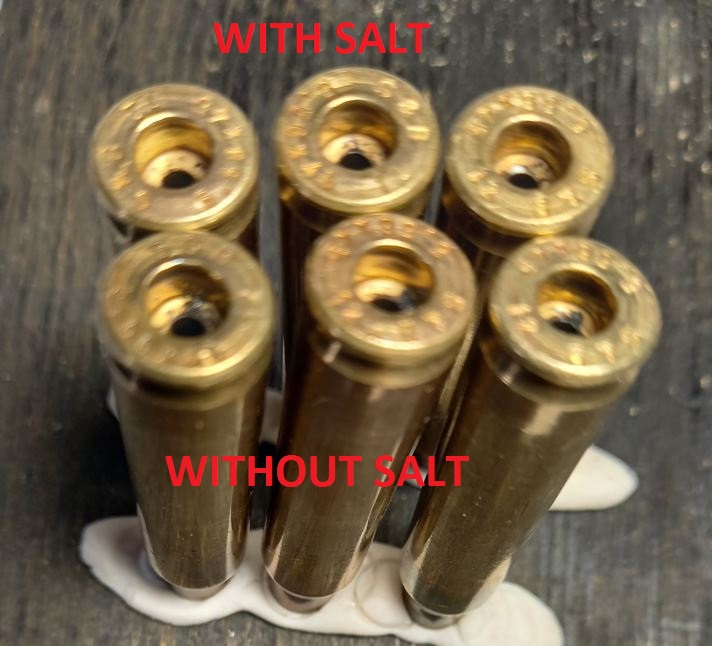

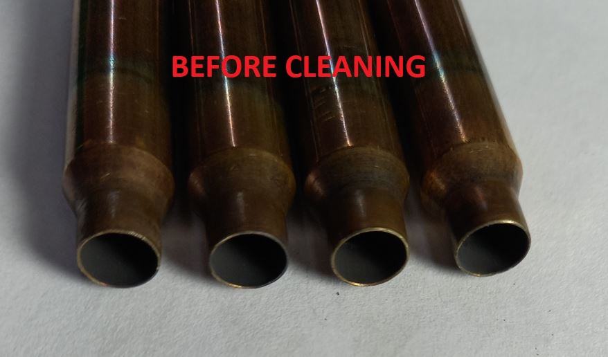

I did the cleaning test this morning.
Exact recipe used was
200 ml tap water (cold)
50 ml white vinegar
A squirt of cheap dish washing liquid.
1/2 teaspoon with rock salt OR No salt
Cases were 223. I clean each time I reload the cases.
Time in Aldi Ultrasonic cleaner runtime 130 seconds + about 20 seconds soaking before dumping in clean water.
Dirty - Neck sml.JPG (81.81 KiB) Viewed 19000 times
Cleaned-Neck Sml.JPG (62.9 KiB) Viewed 19000 times
Cleaned- Primer pocket SML.JPG (105.67 KiB) Viewed 19000 times
No doubt in my mind the recipe with salt does clean a fraction quicker. But does it matter in practice,,,I doubt it.
