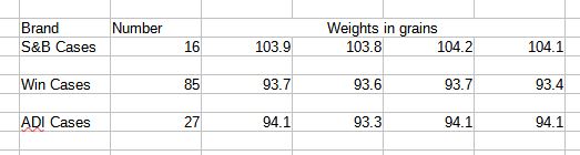

Post by Oldbloke » 31 Jul 2022, 11:28 am
OK. I'm a realist and understand that I don't need 0.3 moa. Happy with MOA or a tad less if doable. I don't target shoot so strictly hunting and sensible ranges.
OK. I did a bit of a stock take on all of my 223 cases and was surprised, almost all of my S& B cases were stolen. (bugger my original cases) And a few Winchester cases gone too.
Here is the result of the stock take and weighing exercise. BTW all cases weighed had been cleaned/sized and trimmed.
Case weights.JPG (23.1 KiB) Viewed 5526 times
I normally have a few "squib" loads so it looks like they will be the S&Bs. (don't use them much)
Winchester and ADI are surprisingly close in weight so I think I will test/develop loads in the Winchester cases and treat the ADI as being the same. This will give me over 100 cases. Plenty for my needs.
What do you blokes think?

Post by Lazarus » 31 Jul 2022, 11:57 am
I'm surprised at the extra mass of the S&B.
It would be interesting to see how parallel loads performed, ie same powder weight and seating depth in the heavier S&B compared to Win or ADI.

Post by Oldbloke » 31 Jul 2022, 12:07 pm
Lazarus wrote:I'm surprised at the extra mass of the S&B.
That's why I've asked the question.

Post by Larry » 31 Jul 2022, 12:36 pm
I think you are on the right track and getting rid of the remaining S&B cases might be the solution.

Post by Oldbloke » 31 Jul 2022, 12:54 pm
Larry wrote:I think you are on the right track and getting rid of the remaining S&B cases might be the solution.
The squib loads were developed back in 2015. Not long after I purchased the rifle. So pretty sure they were S&B cases.
