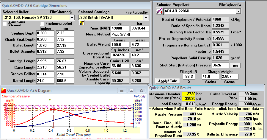

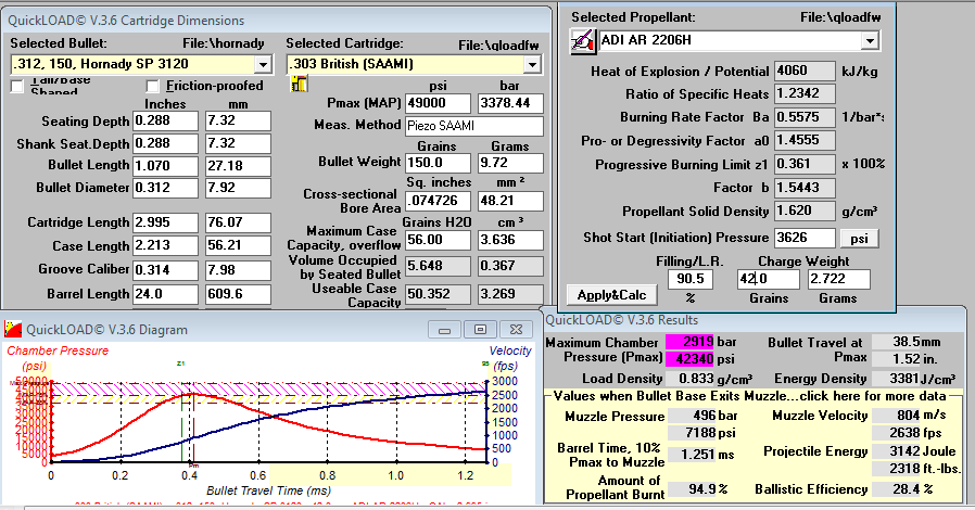

Post by dnedative » 10 Aug 2022, 5:32 pm
42gr of AR2206H/150gr is on the money for where you should call it a day;
Quickload reckons its in the 42k psi range

Post by in2anity » 10 Aug 2022, 9:09 pm
No1Mk3 wrote::D G'day in2anity,
Interesting data, now if you could post for 303 British, as OP was asking? (And lay off the "Happy Havelock", or Mum's cooking sherry :D )
:oops: :lol: oh dear No1Mk3 how bloody embarrassing,.. as you may have guessed, I've been helping a clubmate out with his new No4-762 Sterling, and forget we were dealing with ye olde 3-oh here... oops. Terribly sorry OP - allow me to rectify that. Please take look at my quickload grabs again for 303 data under a 150gr Hornady.
If it were a No4 action it could handle 42gr no dramas, I'd shoot it in a heartbeat. But considering it's a smelly no1, perhaps 41gr maybe a little safer? The seating depth in those grabs is kinda deep, same as ADI - if you seat them out a bit more, you'll wipe a K or two off the pressure.
41gr is going to be a very pleasant load to shoot - perfectly fine for 300m shooting. My mate runs that under a 150gr 30cal and he likes it better than an AR2208 load.

Post by in2anity » 10 Aug 2022, 9:10 pm
dnedative wrote:42gr of AR2206H/150gr is on the money for where you should call it a day;
That data was for 308 - look again. But yeah it's quite similar. Must say 42gr is warm for a No1 action, nothing for No4 action.

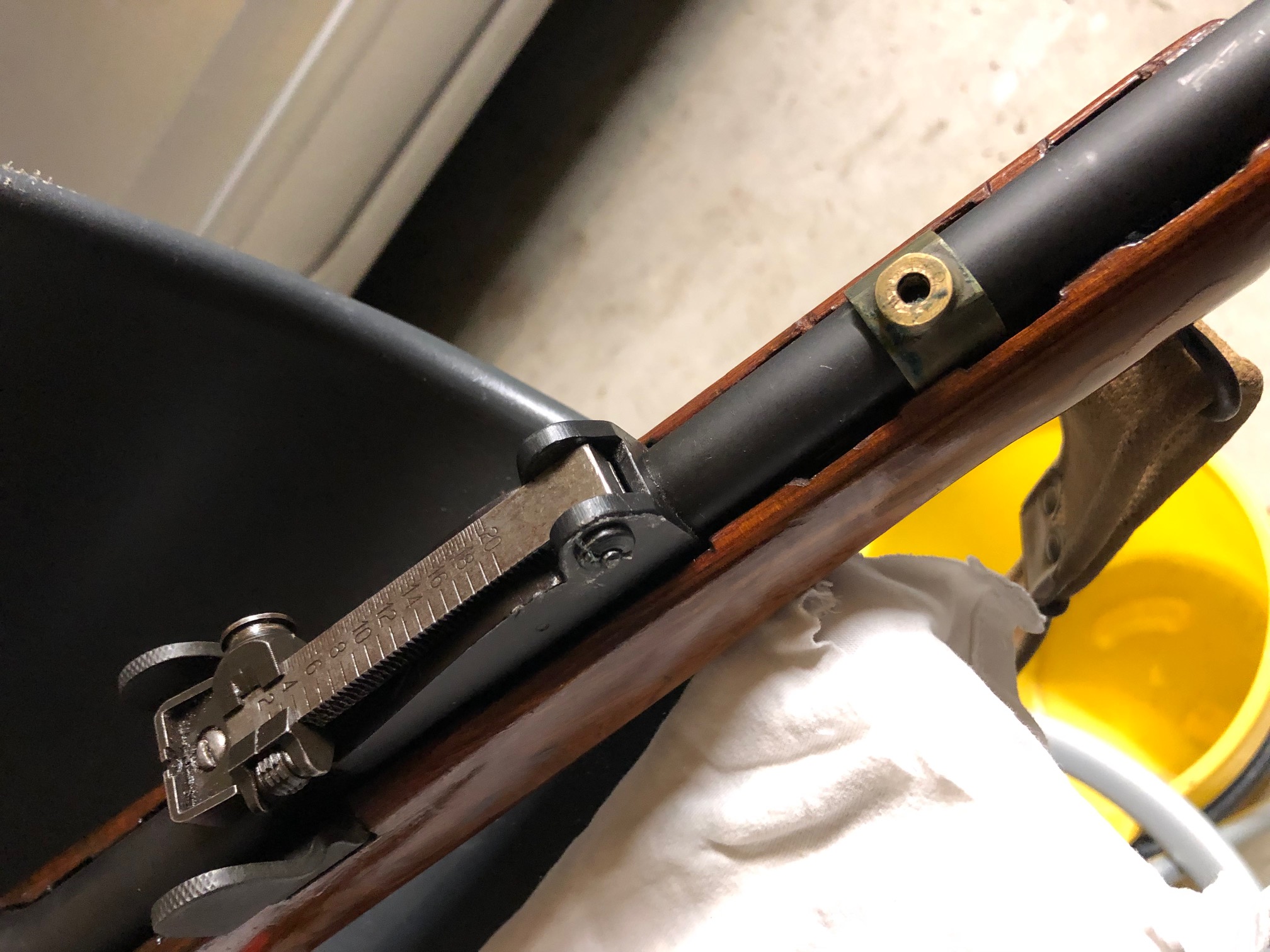

The barrel is actually in pretty good nick, despite a weird ring around it.
(top wood between receiver and rear sigth was removed for that picture)
