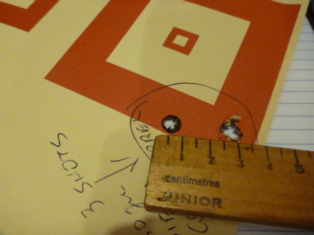

So, I went out today and shot both loads 44gn and 45gn mostly with Sierra 150 Game Kings. I also shot a couple of 3 shot groups with Nosler Accubonds. but I reckon the Sierra's will do anything I want, and the rifle seems to prefer them.
Even though they are fairly solid loads the primers weren't flattened, but I think I'll leave it at that.
