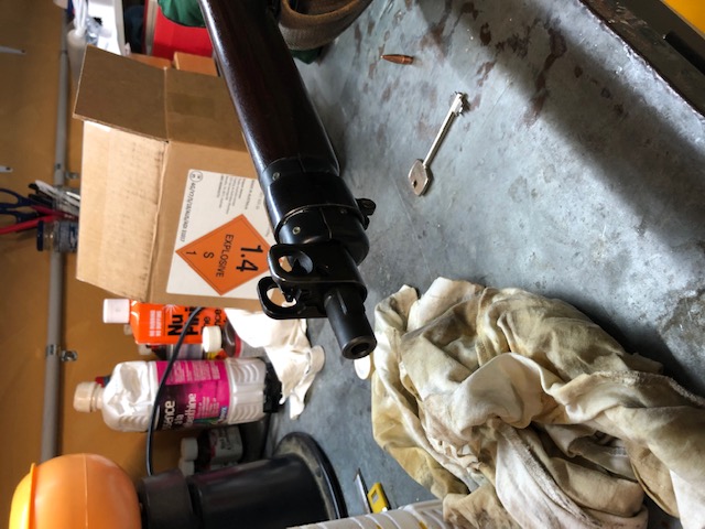

Post by Vince24 » 27 Sep 2022, 7:35 pm
Thanks for all the good comments, the beginner in reloading much appreciate it!!!
Here is the ammo in question, headstamp is only "16".
Haven't dismantled but the load seems to be around 42gn of an unknown powder (weighting the full round minus case weight and projectile). I can hear there is very little space remaining inside! OAL of the ADI round is 2.775. Cases lenght between 2.001 and 2.005 after 1 shot, not neck-seized yet.

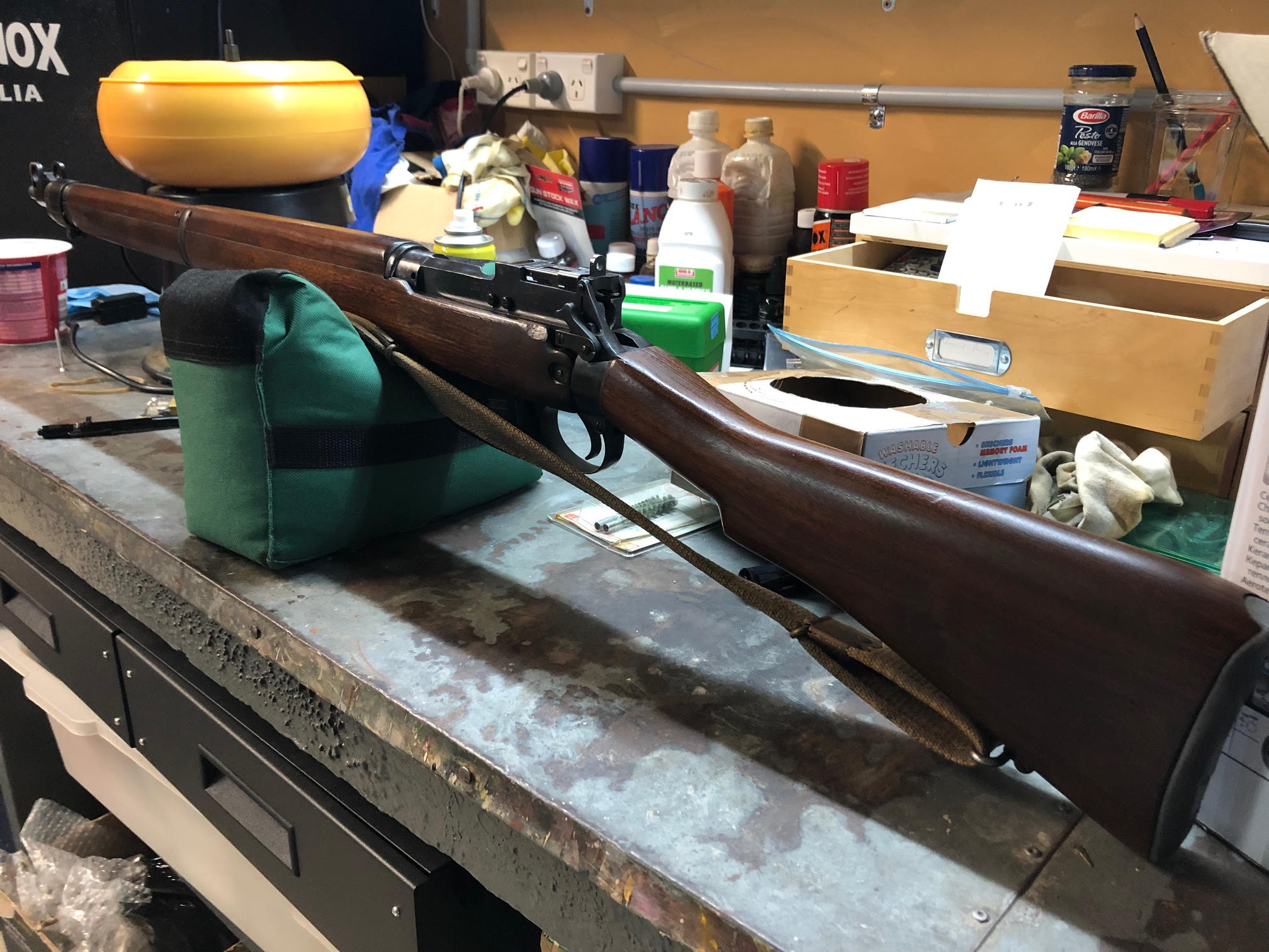

The rifle is an LB Lee No4 from 1942, no idea who made the conversion, it has a Sterling mag, feeds very well and shoots well enough at 100m, here below a quick attempt at a 10 shot groups at 100m with the ADI shots. Could be better with a few more attempts I am sure.
The barrel is slightly shorter than a regular 303 barrel.
