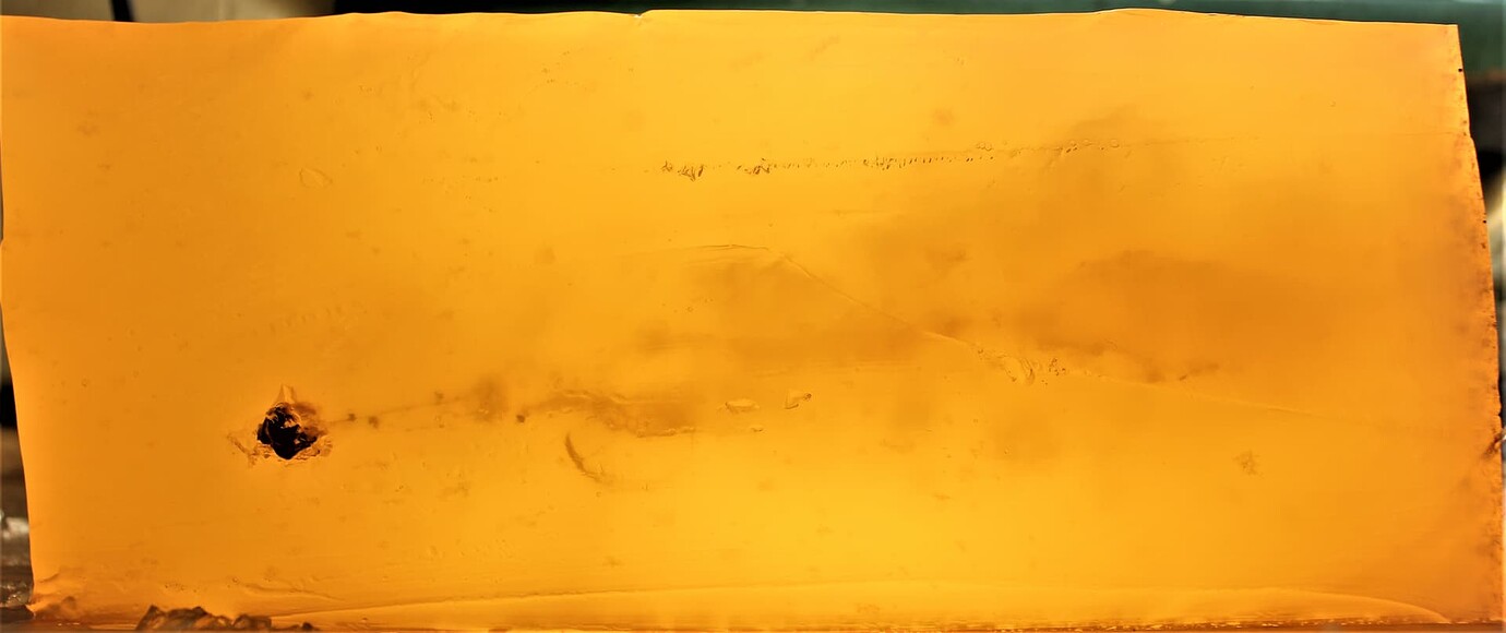

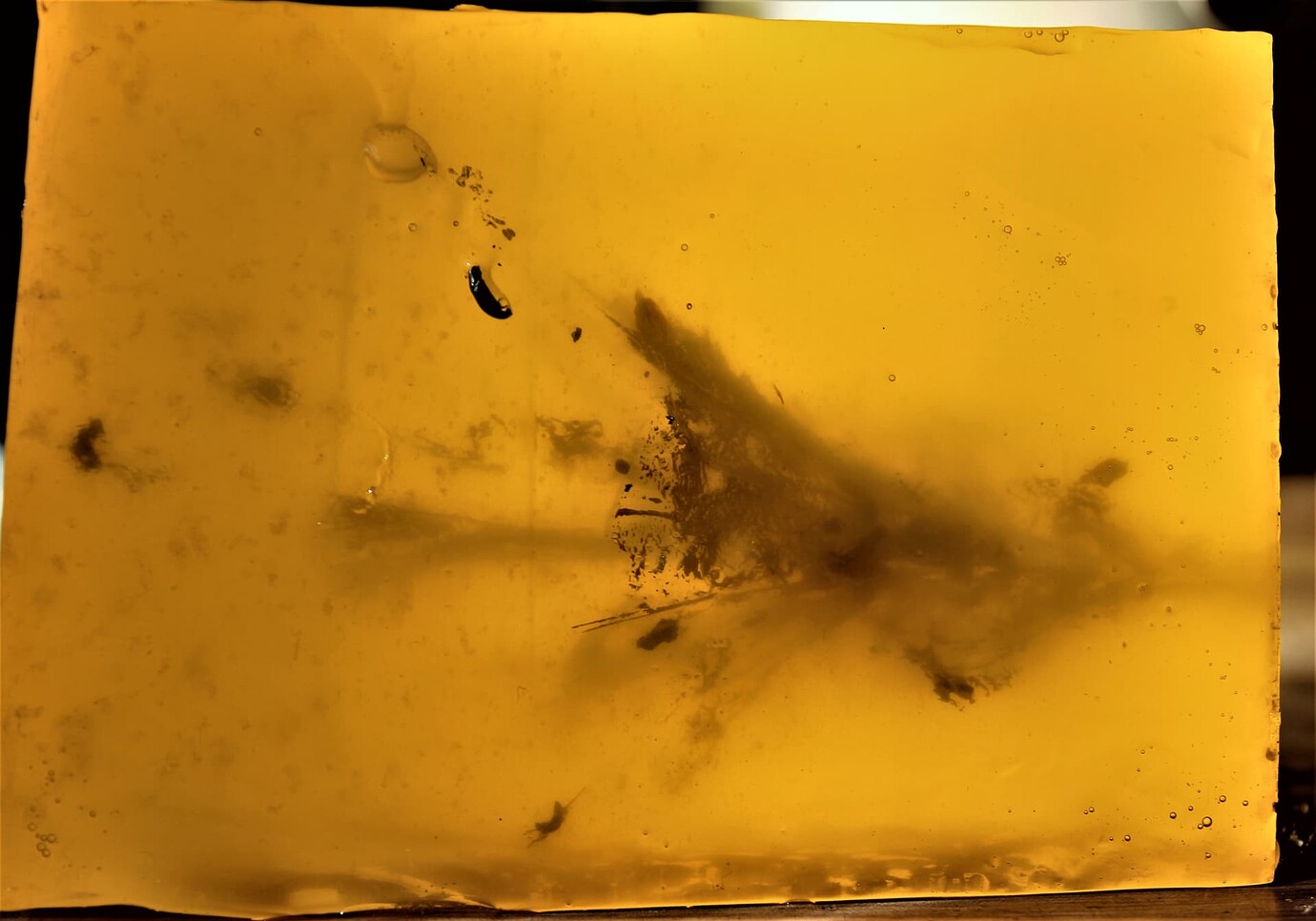

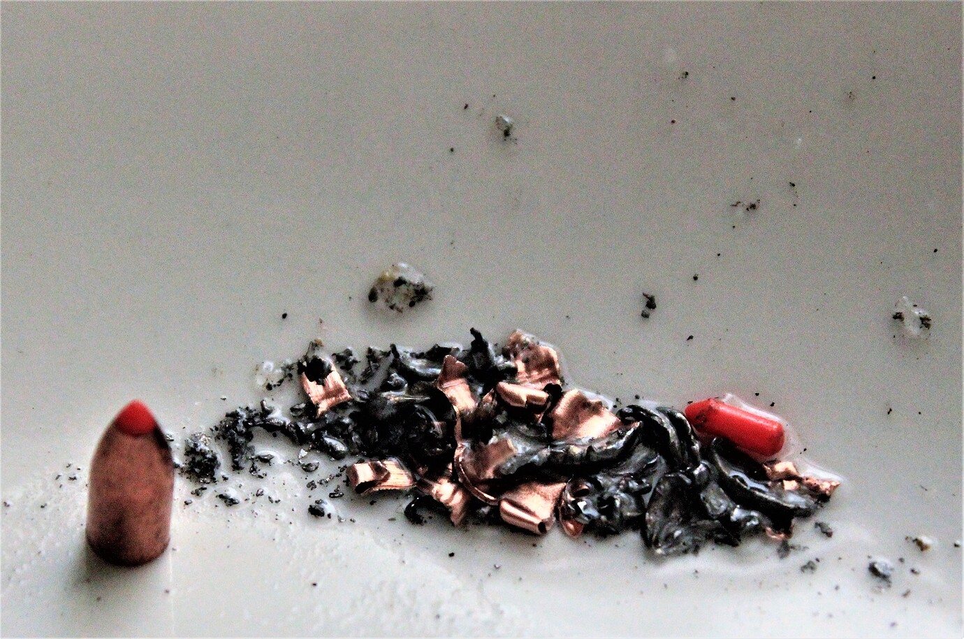

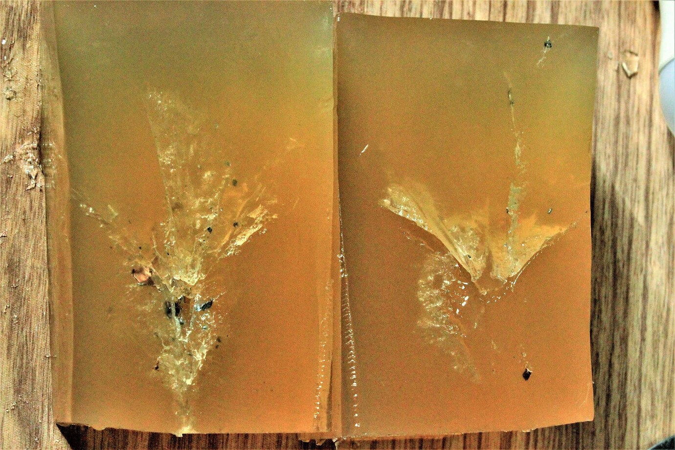

Post by Lazarus » 08 Oct 2022, 10:19 am

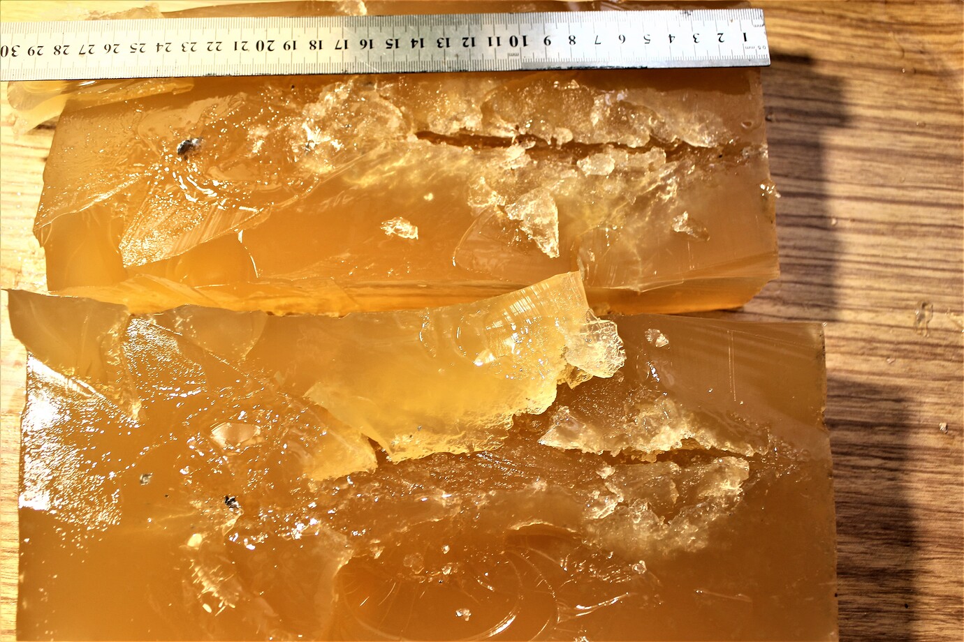

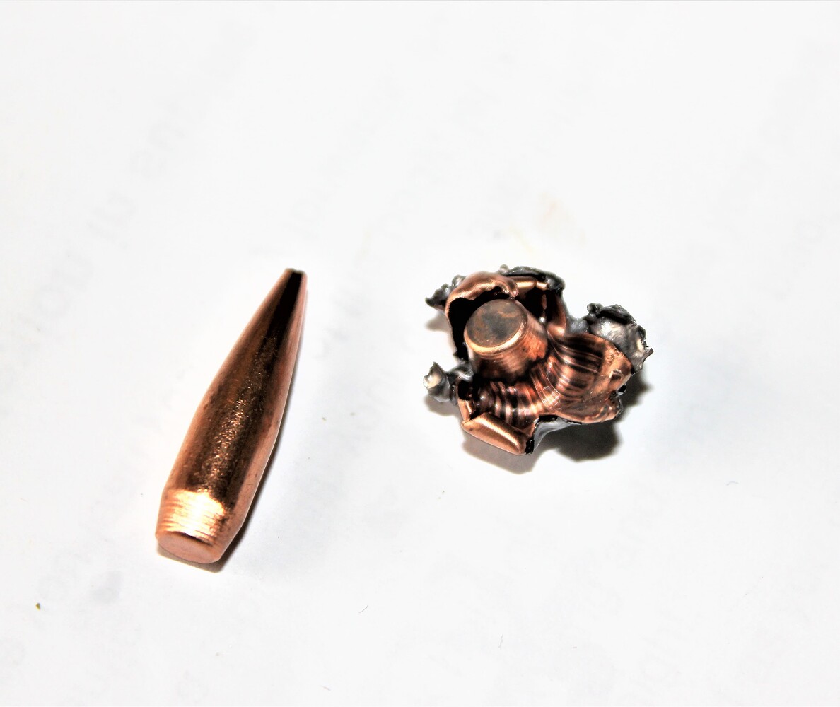

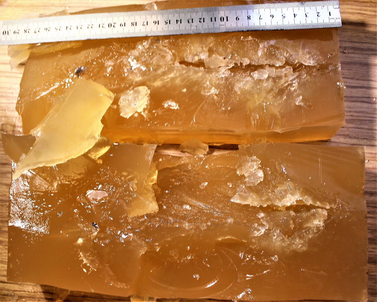

I have been doing some ballistic gel testing of various projectiles over the last month or so, from .22lr to .223 and 12g.
I have just completed testing the REXEM 62gn F-Bombs.
I was impressed with the damage that OO buckshot did to my 30kg gel block from 20m, it split it in two.
I have seen nothing that comes close to the damage these REXEM F-Bombs do though, they destroyed the block completely.

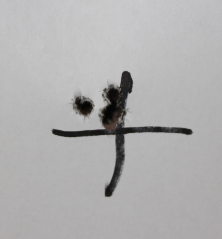

My first pleasant surprise was how accurate they are.
I didn't bother looking for the "ideal" load, just put the minimum, 23gn of 2206H under them and got the 5 round group below at 100m.
The flyer is doubtless my doing.
I did two tests, in the first test the block was somewhat dehydrated from sitting for over a week waiting for a break in the rain and I attributed the extra damage to brittleness from dehydration.
The results were quite impressive as below, with the projectile expanding explosively on impact and leaving a 20cm permanent wound cavity and the main body of the projectile travelling 36cm into the 41cm long block.

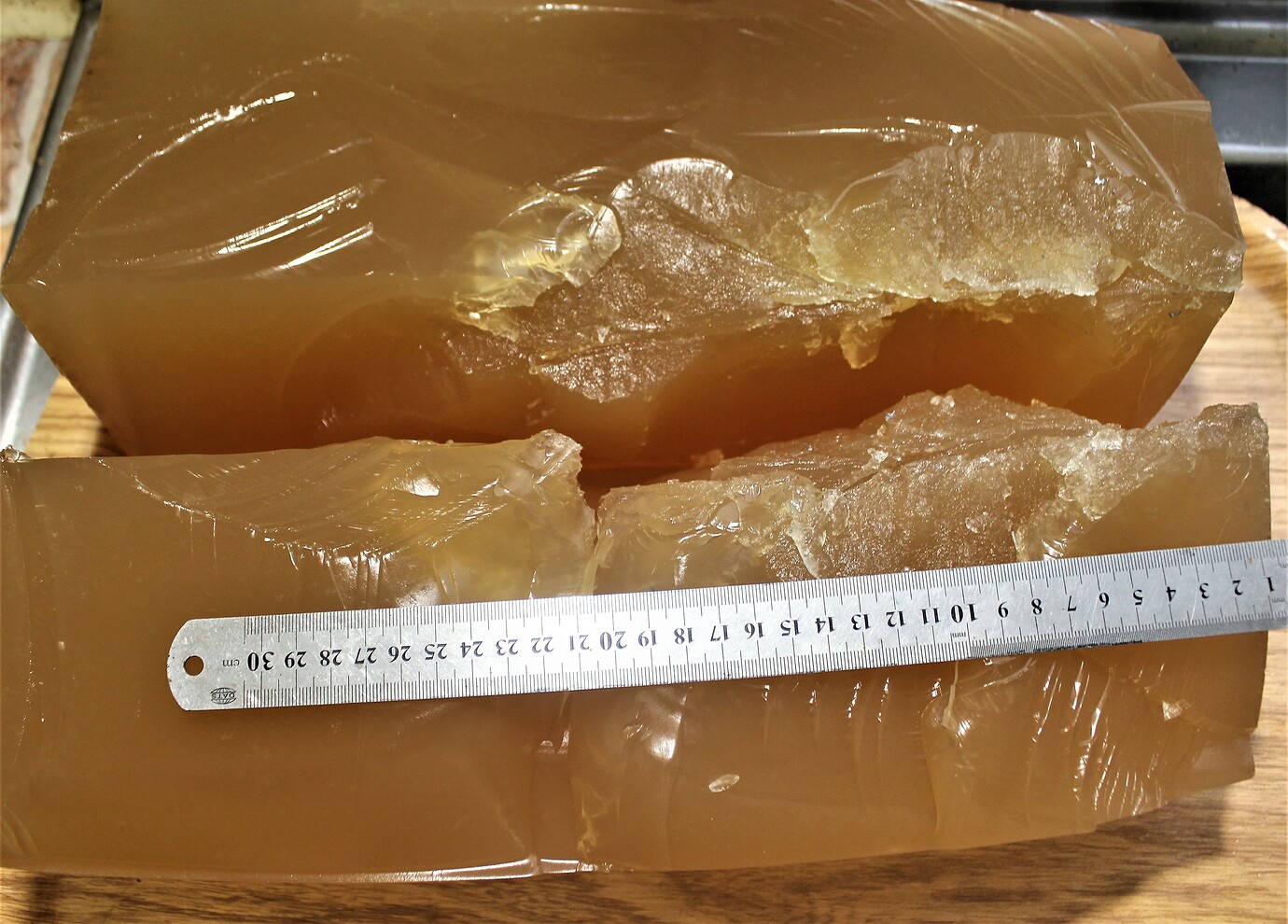

After rehydrating the block and giving it 2 days to set, I tested again today.
I didn't think I could have been more impressed than with the last result, but today's blew both the block and me away.
These are the most accurate and destructive projectiles I've ever used and I can't recommend them them highly enough.

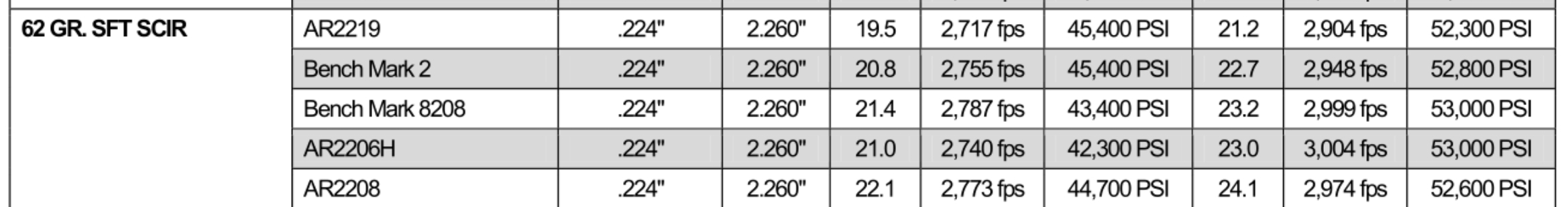

For the record, and thanks to SpudLee for asking and getting me thinking, the load for this round was NOT the minimum but the maximum.
I've been trying to work out how I made the error and have it.
Instead of looking at the ADI load chart for 62gn projectiles, I referred to my range notes for the ADI 62gn SS109 because it was, to my mind the closest.
The best load for that turned out to be the maximum of 23gn 2206H.
My apologies for any confusion.

How do you know it was the maximum load? Were you getting a sticky bolt and flattened primers?
Posts: 3245
Re: REXEM 62 & 69gn 223
Post by Lazarus » 11 Oct 2022, 6:29 am
SCJ429 wrote:How do you know it was the maximum load? Were you getting a sticky bolt and flattened primers?
No, just going by the ADI load chart for the nearest equivalent using 2206H
I'm not into pushing limits, it was also the most accurate in my rifle.

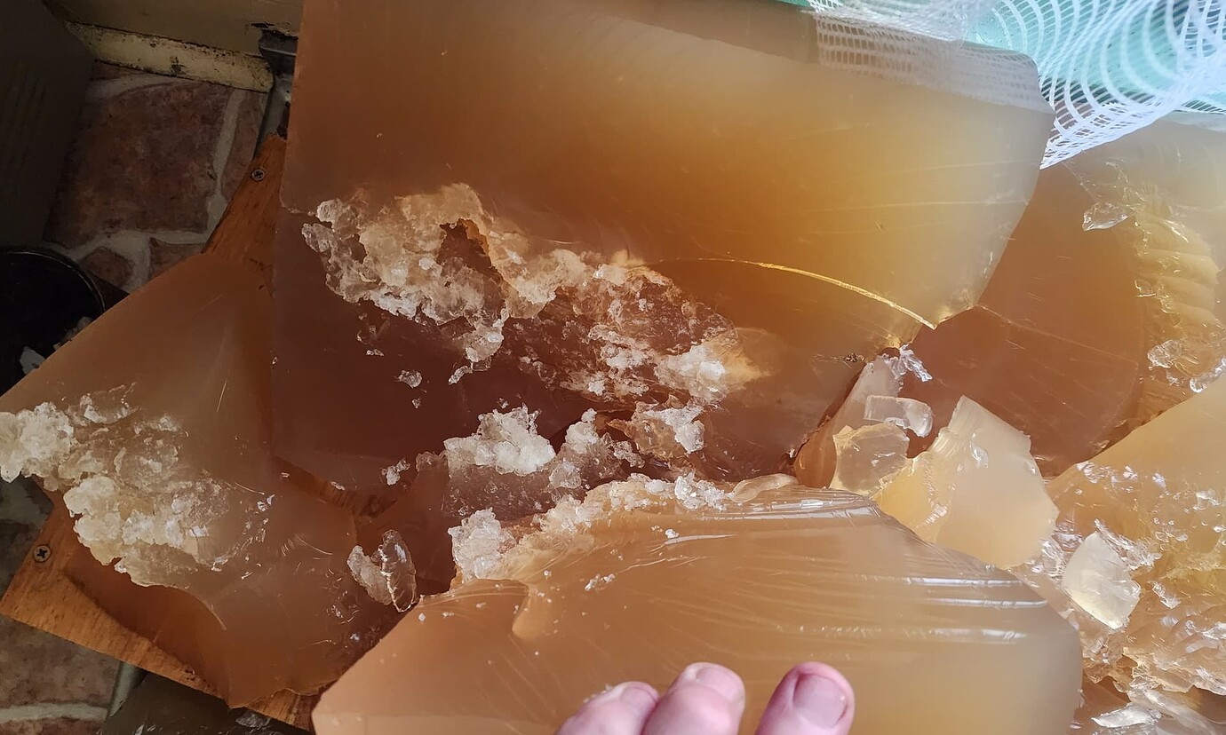

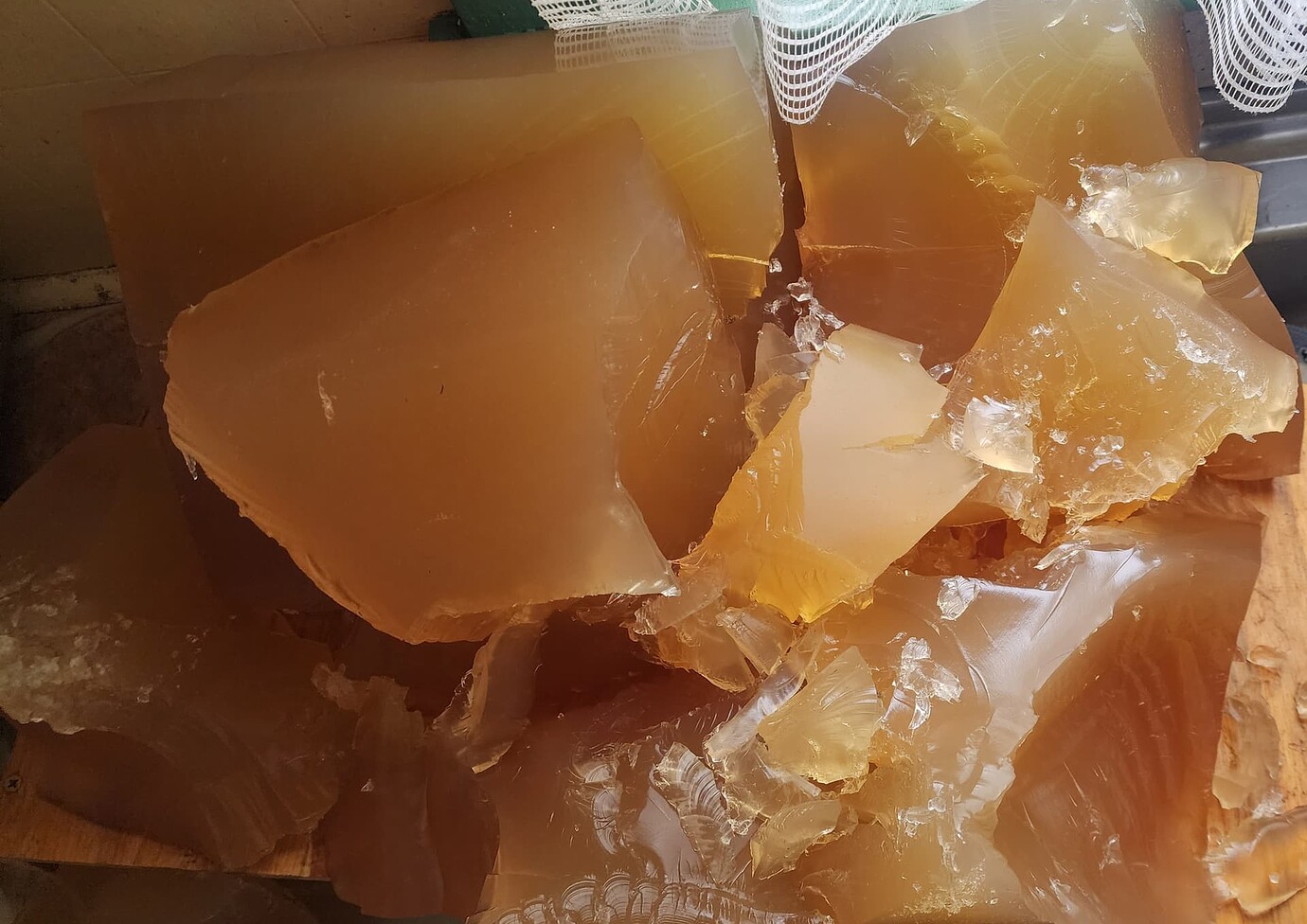

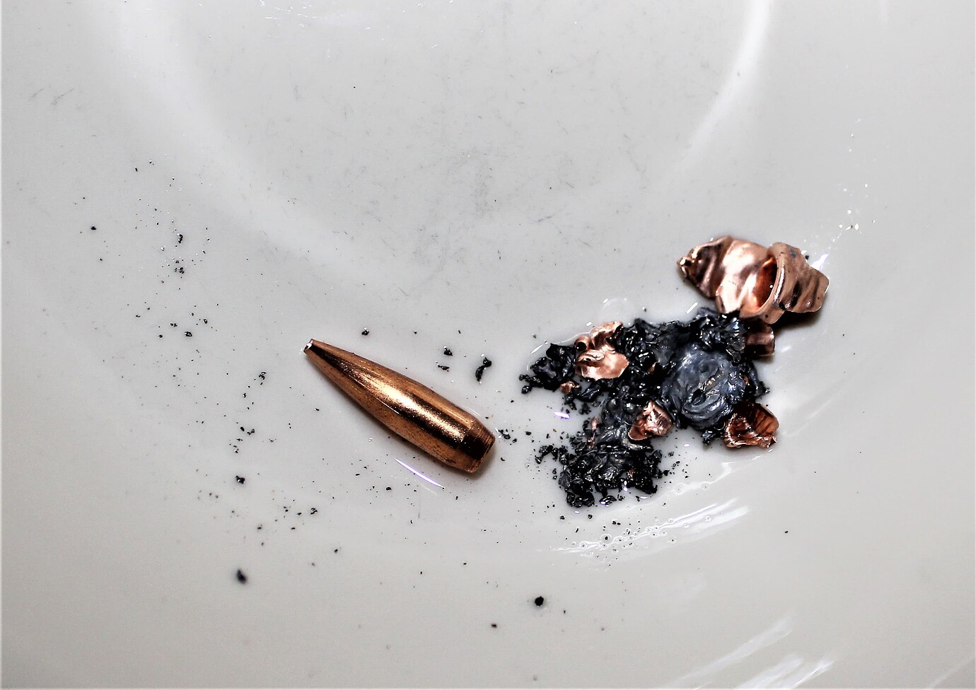

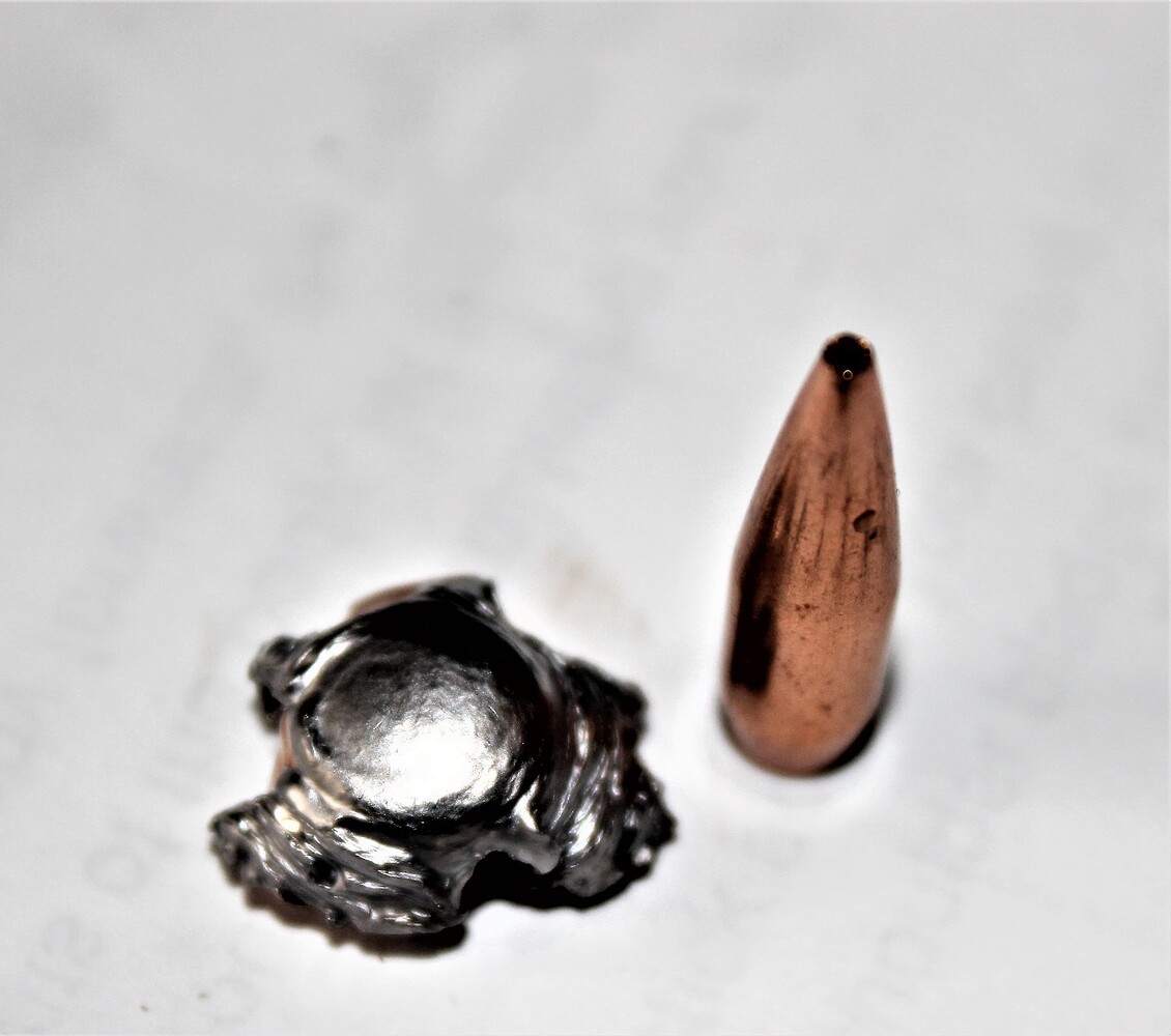

I tested the REXEM 62gn F-Bombs at 200m today.
Despite ~20kph of crosswind they only drifted about 3/4".
They once again delivered an amazing hit, creating a permanent wound cavity over 20cm long
The pictures say more than I could.

23gr 06H is far from the max load under a 62gr - that load is for the swift scirocco, which is unusually long for a 62gr. For that data, length mag length is probably the limiting factor, which probs eats into the powder space. But serious you could work up to 25gr I’m sure

The Swift Scirroco bullet has such a heavy jacket I would use load data for copper bullets rather than jacketed bullets. As far as I understand the Rexem is a jacketed bullet so try the 63gn SP data.

in2anity wrote:23gr 06H is far from the max load under a 62gr - that load is for the swift scirocco, which is unusually long for a 62gr. For that data, length mag length is probably the limiting factor, which probs eats into the powder space. But serious you could work up to 25gr I’m sure
You are no doubt right, I use 24gn under the much longer 70gn RDF, but to what end?
The group above is good enough for my purposes.

Lazarus wrote:You are no doubt right, I use 24gn under the much longer 70gn RDF, but to what end?
Very true Lazarus, very true. Was just pointing out the ADI tables were a bit misleading around 62gr and 06H. Don't worry, I'm also a big advocate for running my target rifles "just hot enough" where I can get away with it. For the various Australian Service Rifle comps (often limited to less than 500m), there's little need to run maximum loads; the group size is far more important...
