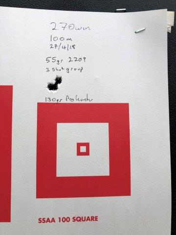

Post by Bello » 17 Oct 2023, 4:49 am
Hi Mate
I use AR2209 in my 270.
I chose to use 130gr Prohunter projectiles. (See below pic) (My load data is on this pic for my rifle and me, please work up loads in your rifle and NOT use my load data as this may be dangerous in your rifle configuration)
I found the Hornady SST to be a little too soft (The SST projectiles I used, exploded at close ranges, that is; within 100 meters on game). I found the SST to be quite accurate on paper.
I have tried several other projectiles, but I realised, ALL of my hunting is done with-in 200 meters, so I just need a projectile that would work for me.
Depending on what YOU will be targeting and at what RANGE you intend to target this game, may depend on the type of projectile you use.
Good luck. :thumbsup:
