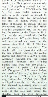

I had a look through my hard drives and found an article about the .303 Wildcats...in German :-)
Luckily I also had an English translation of it.
This may be entirely a hearsay story but the implication is that the .303-270 originally used standard .303 charges of cordite propellant. They simply pulled the military bullet, ran the charged case into a .270 neck die, and seated a .277" bullet back into it. Whether that continued into the smokeless era I have no idea. Considering the bullet is significantly lighter it is possible though.

bladeracer wrote:I had a look through my hard drives and found an article about the .303 Wildcats...in German :-)
Blade racer,
You are absolutely correct. Not hearsay at all. I still have my dad’s 303-270 P14 with a sportco barrel, and a heap of ammo, including some still with cordite sticks. He came to Australia in the early 50s from Germany and was a roo shooter in the late 50s and early 60s in western nsw.
Peter

Post by bladeracer » 16 Nov 2022, 8:26 pm
Peterwho wrote:Blade racer,
Peter
Thanks Peter, it's nice to have that confirmed as it implies you could very likely use standard .303 load data. Do you know what bullet weights they would've been doing this with, I would assume 130gn? With the old Berdan brass they probably didn't care at all about brass life though, with modern boxer brass I would still load down from full-power .303 loads if you want the brass to last more than a few loads.

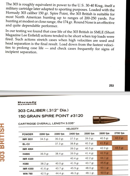

Post by bladeracer » 16 Nov 2022, 9:04 pm
As it may well be viable to use standard .303 174gn load data for the .303-270 (probably 130gn bullets) I've been looking through some old manuals.
1967 Edition of Hornady's Handbook doesn't list W748 or W760 loads for the .303 at all. They do suggest the Hornady 150gn SP is the best bullet for hunting in the .303 out to 250yd.
The 1985 Edition does list W760 down to 150gn bullets (42.5gn up to 50.0gn max under the 150gn bullet), they also suggest loading short of these levels to increase brass life.

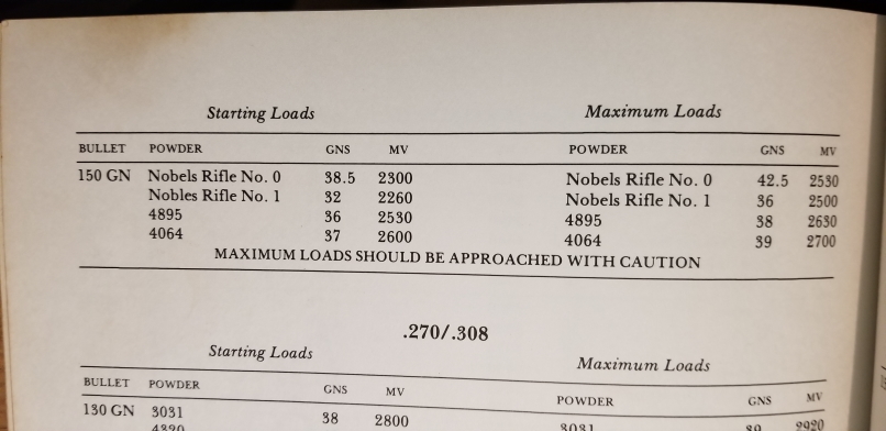

I have got an old Nick Harvey manual that I bought when I was chasing W748 .303 data but it came long after we started shooting it so I didn't need it, if I can find it, and it has any .303-270 data I'll add it here.

Post by bladeracer » 25 Nov 2022, 2:27 pm
I found my old Nick Harvey manual, and he does list ".270/.303", but not with W760/H414. This is a first edition I think, 1980. I thought I had the same green manual I had when I was a kid, but I don't seem to.

Post by animalpest » 25 Nov 2022, 2:40 pm
Yeah, I have Nick's first manual (green). It lists 748 but not 760
