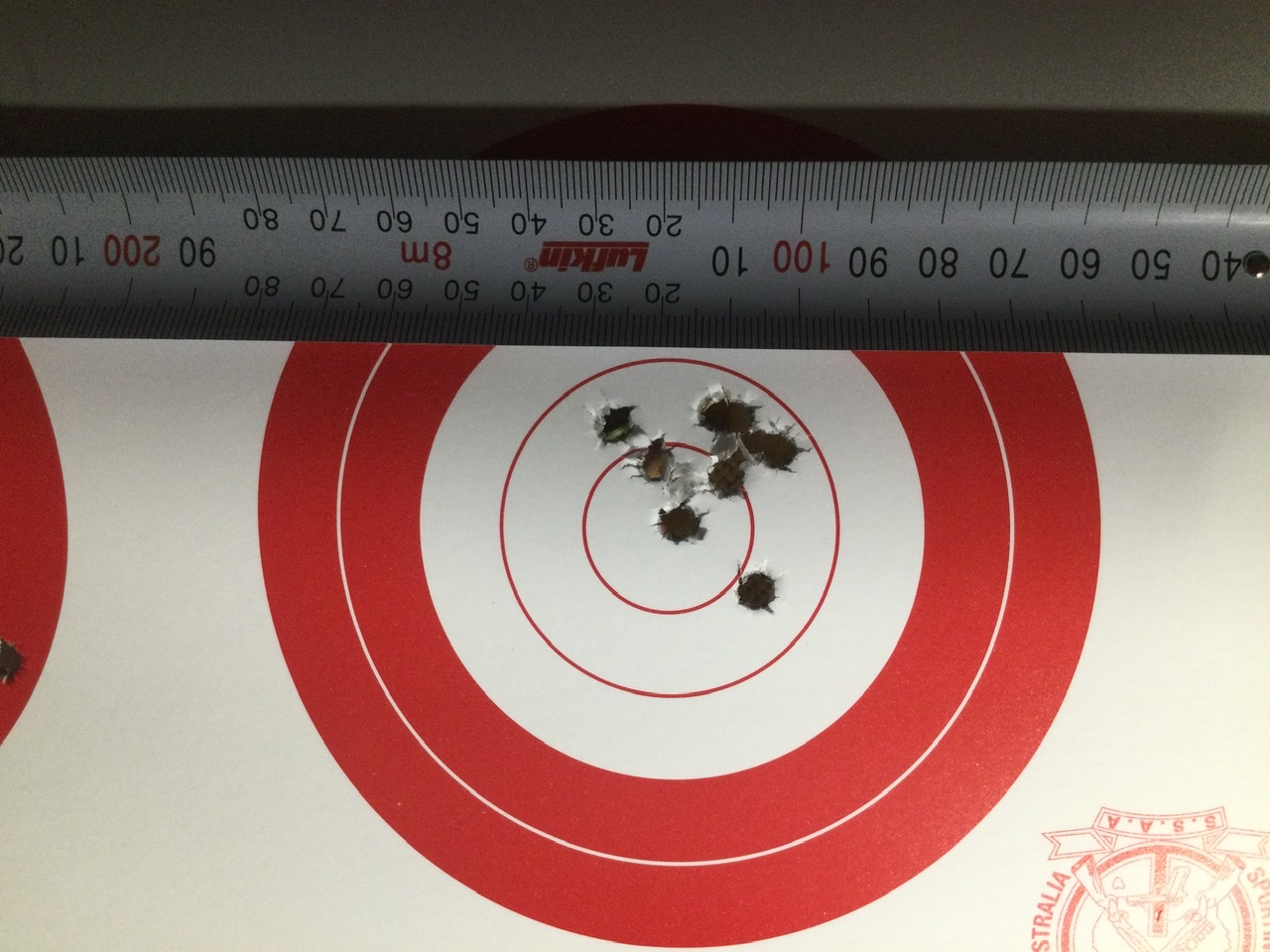

Here are my rem 700 in 243 results from yesterday at 50 metres. My first rifle after 3 decades of shooting nothing. Scope is a Nikki nighteater 4-16x50. Got lots of other calibres but enjoying shooting paper with this one
Peter

Post by Apollo » 05 Dec 2022, 8:42 pm
You have a lot of work to do....
Practice with something other than the .243W or you will wear the barrel out before you get even close to accurate.
The 243W can be very accurate and should shoot 1/2' 5 shot groups at 100 Yards easy with the right rifle.and load.
I've won 300m competition with a Sako 85 using 90gr BT's and shot 2/3" to 3/4" groups. The 70gr are even more accurate at shorter distance overall.
I shoot to test with a proper homemade Bench, Front and Rear Bags.

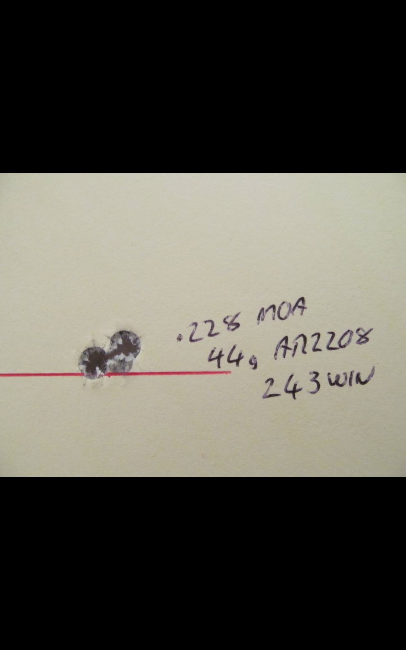

I had a 243 Winchester now my mate has it that would do this with monotonous regularity the load was with a 65 grain Vmax velocity was around 3850 amazing all the way out to 500 best varmint cartridge I ever shot .
