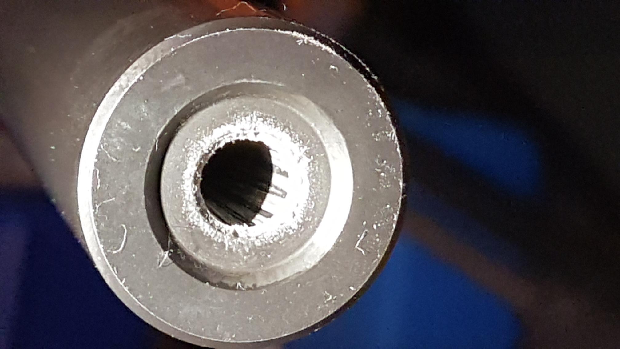

With ADI powder and my long-range rifles as I only clean when I need to i used to be able to put them in the safe for months and not worry about having to clean them something in the old recipe kept moisture away don't know what it was this new stuff absolute bloody rubbish I am not impressed this is 2 days after using the new powder.
I noticed the change in the ar2209 but it was not this bad it even smells a lot different it has lost it's beautiful sweet ether smell it is now very acidic and hard on the nostrils especially when you open a new 4 kilo jugg.

What is it that white stuff ? Looks like a chemical reaction has occurred.
What's the rifle and cartridge.

Thats whats doing it. I was wondering what the white fluffy stuff was that forms around the muzzle...

northdude wrote:Thats whats doing it. I was wondering what the white fluffy stuff was that forms around the muzzle...
That is the powder residue it used to be just a grey colour.
Billo wrote:What's the rifle and cartridge.
Howa Varmint 223 Remington 80 grain burger vld.
