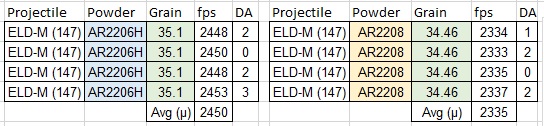

Post by ash_hendo » 02 Feb 2023, 10:07 pm
I'm a bit of a reloading newbie, so this may be a stupid question, however.....
I've just created two loads which shoot very well (maybe 1/4 moa at 100m), one with AR2206H and one with AR2208 and the AR2208 is 115fps slower.
I was wondering if there is any advantage of the slower speed load?
Would it make much difference to brass life? Is the slower powder less "harsh" on things in general? Will the 115fps make much of a difference? Balistics calcs seem to indicate only an inch difference either way at 500m which doesn't seem too much to me.
Any thoughts to assist me choose one over the other will be greatly appreciated!
<edit> the Cartridge is 6.5 creedmoor.
Below is the load details with chrono results.

Post by rc42 » 02 Feb 2023, 10:44 pm
So, 2208 is a little slower than 2206H but not by much, typically more powder is used as the powder burn rate slows as you can get both higher muzzle velocity and lower peak chamber pressure at the same time. This is great but if the powder is too slow you'll run out of case volume before getting a usable load and if it's too fast you'll have a big air gap with the powder moving around and inconsistent results.
In terms of brass life I wouldn't expect any difference between your loads, nor would the extra 115fps cause any measurable reduction in barrel life.
Personally, I'd try to match muzzle velocities and get the same zero point for both and choose between them based on group size, it's certainly good to have load options with different powders.

Post by bladeracer » 02 Feb 2023, 10:47 pm
ash_hendo wrote:I'm a bit of a reloading newbie, so this may be a stupid question, however.....
I would go with whichever is more accurate.
Less heat and pressure is easier on the firearm and the brass, but that's a slight enough difference I doubt it would matter. If I don't need the velocity to knock down a silhouette or beat heavy winds for example then I prefer to load lower.
I also prefer AR2206H generally for its versatility but if you're only loading one cartridge it doesn't matter.

Post by Oldbloke » 03 Feb 2023, 4:57 am
Yep, nothing in it. Go AR2206H unless your already using AR2208 for something else.

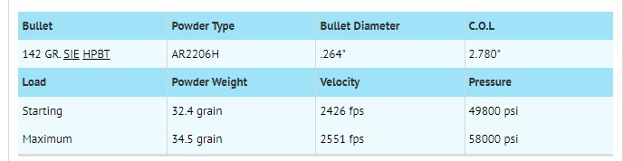

Mate can I ask where you got your load data for using 2206H and 2208 in the 6.6 Creemoor?
I load mine with 2209.

Post by bladeracer » 03 Feb 2023, 1:21 pm
JimTom wrote:Mate can I ask where you got your load data for using 2206H and 2208 in the 6.6 Creemoor?
ADI website has load data.

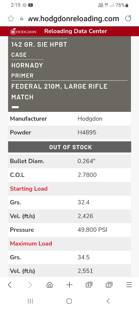

Post by ash_hendo » 03 Feb 2023, 4:55 pm
I did look at the ADI website first but they only went up to 140gr. I took a very safe load based on the figures there and worked up looking for pressure signs. Although this works for me with my brass and rifle and bullet seating, there is no guarantee it will work in another.

Post by bladeracer » 03 Feb 2023, 5:18 pm
You didn't mention what bullet weights you're using :-)
I use AR2206H in all my 6.5mm chamberings with 160gn jacketed bullets and 170gn cast bullets.

Post by Oldbloke » 04 Feb 2023, 1:23 pm
Hodgden list a 142gr
Rebranded ADI Powders.jpg (419.3 KiB) Viewed 11188 times

Oldbloke wrote:Hodgden list a 142gr
The attachment Rebranded ADI Powders.jpg is no longer available
The attachment Resized_Screenshot_20230204-141903_Samsung_Internet.jpeg is no longer available
Same data as ADI has.
