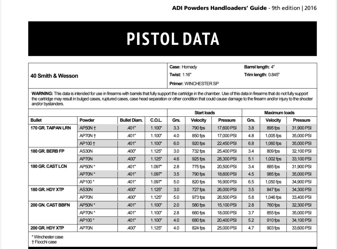

I would use them for reduced loads, not full-pressure rifle loads. .222Rem is a 50,000psi cartridge.
Re: Using small pistol primers in a rifle???
Post by Oldbloke » 07 Apr 2023, 8:28 am
No experience but what blade said. Reduced loads.
As a starting point, I just had a look and pistol ammo using SP seem to max out at about 35, 000 psi.
But be careful. Do some home work.

As others have pointed out, they may be used but pressures must be kept to modest levels.
Although FPS might be reduced you may be surprised to find little difference in real world performance.
Unfortunately in a primer and powder drought, sometimes the only option may be to make do with what one has.

The official answer will always be to use only the primer specified in the load manual, thanks to lawyers it has to be.
In reality small primers have a lot of interchangeability options as their external dimensions are all the same.
It varies by manufacturer but for CCI, small rifle and small pistol magnum are the same thing, they have the exact same primer material and cup thickness of 0.020"
Their small pistol have less primer material and are 0.017" cup thickness, great for pistol firing pins with their weaker springs but have a reduced ability to cope with high pressure loads before they blow back out through the primer.
CCI small rifle magnum use even more primer material and have a 0.025" cup thickness, those will hold up under very high pressure rifle rounds but need a substantial firing pin hit, certainly beyond that of most pistols.
Numerous tests have shown that different primers have no effect on powder loads, magnum primers burn hotter and longer so are better suited to slower powders but the energy they release is insignificant compared to the powder.
If using small pistol primers in a rifle load just treat it like a new powder and work the load up, signs flattening and pressure stress on the primer will be visible well before loads get dangerous.

The principal danger with a small pistol primer in a rifle cartridge is at the higher pressure in a rifle cartridge the thinner pistol primer is more likely to split at the sharp corner formed against the bolt face leaving a tell tale pit on your bolt.
Bladeracer
Not a good idea if a 223 head sized case is involved as there would be very little thickness of brass over the primer in the extractor groove which is pretty well unsupported.
