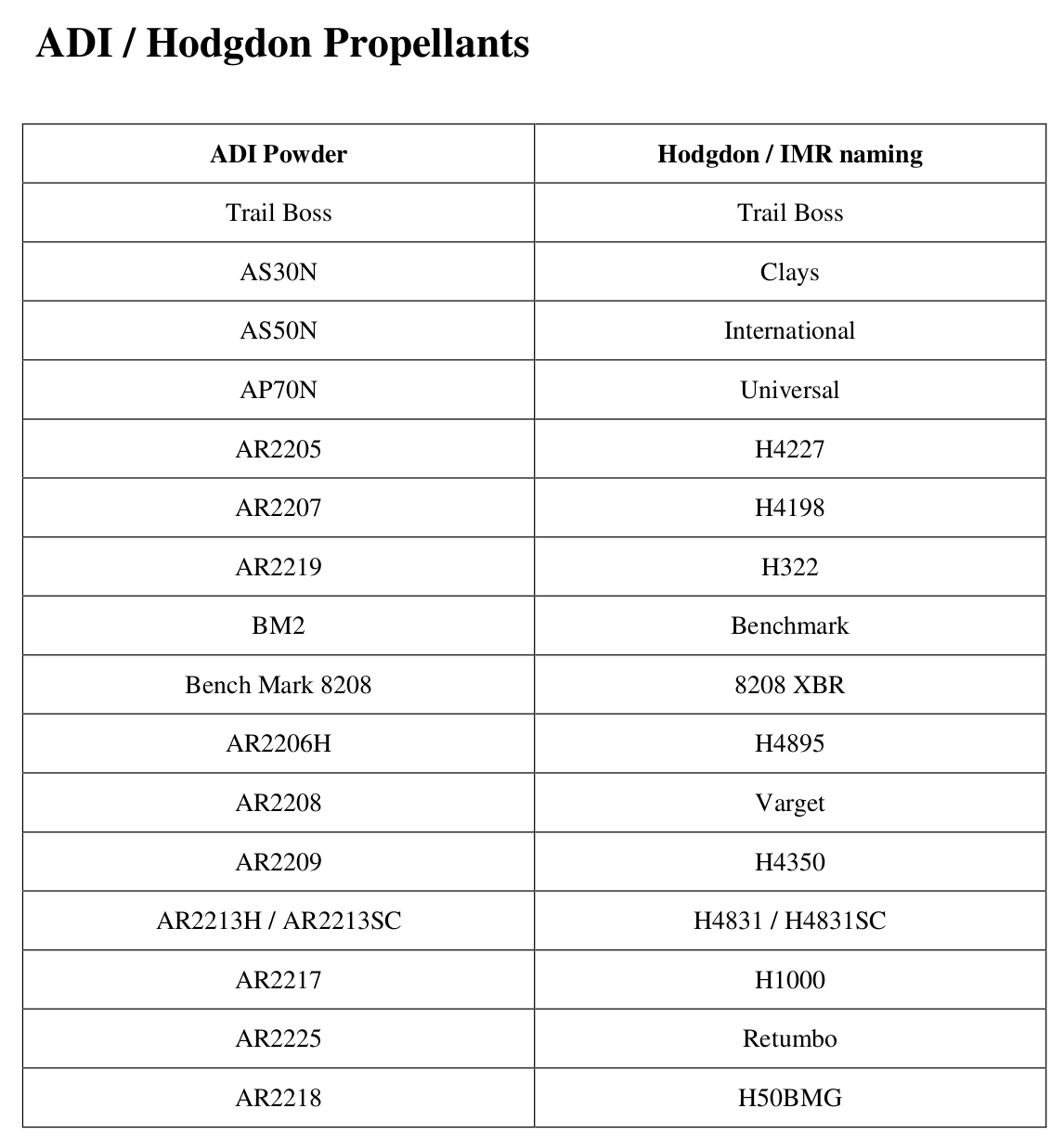

It's not similar to 2207 it is the same adi make it for Hodgden

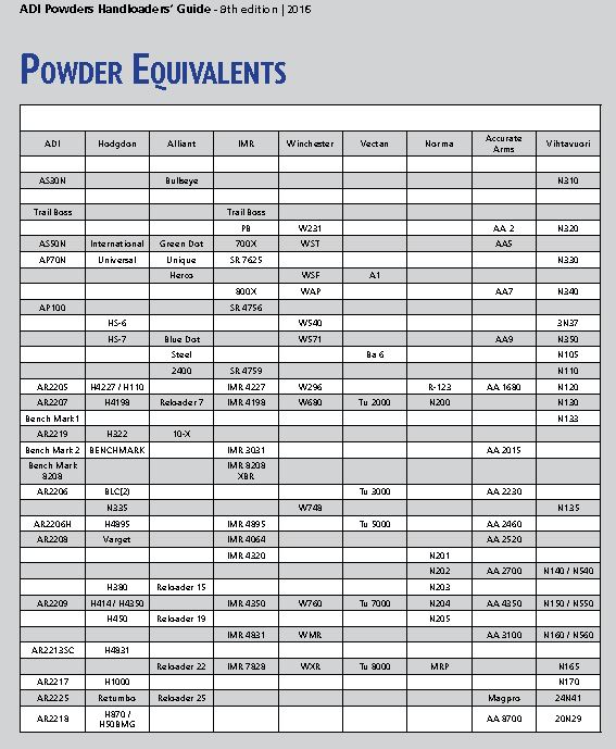

Post by Oldbloke » 18 Apr 2023, 10:35 am
This might help.
ADI Equivalents 2016 9th Ed.JPG (98.33 KiB) Viewed 9795 times
Some of Hodgen powders are just rebounded ADI powders.
