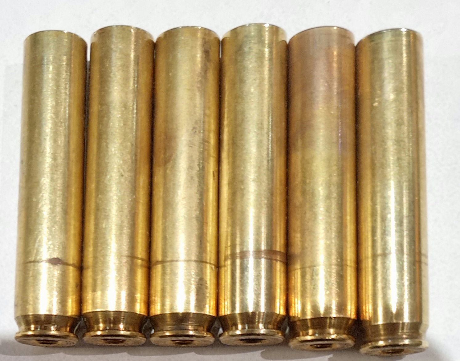

Post by madang55 » 28 Jun 2023, 10:43 pm
So. .358 projectiles do not work. after seating they cause an 'over-size' of the case and will not chamber. .355 projectiles do work. However, the case mouth MUST be lubricated prior to running through the expanding die prior to seating. If not, the process causes a minute collapse of the case and unwanted increase in the case dimensions, again causing difficulty chambering. So much fun this 350.....

Post by straightshooter » 29 Jun 2023, 8:07 am
madang55 wrote:So. .358 projectiles do not work. after seating they cause an 'over-size' of the case and will not chamber. .355 projectiles do work. However, the case mouth MUST be lubricated prior to running through the expanding die prior to seating. If not, the process causes a minute collapse of the case and unwanted increase in the case dimensions, again causing difficulty chambering. So much fun this 350.....
Does your die set have an expander die with provision for case mouth flaring.
If it does then learn how to use it judiciously.
If not then you will have ongoing problems.

Re: 350 Legend
Post by madang55 » 29 Jun 2023, 12:15 pm
You knew the job was dangerous when you took it.
Dangerous....nah...just a challenge. Trial and error at its best.
Expander die yes. Judiciously, definitely. A couple I tried ended up looking like the big end of a trumpet and when I tried to seat, the case mouth was too wide to enter the die. I think the inside of the case still needs just the smallest amount of lube. I only had one of 20 fail, and I only found that out when I chambered the loaded rounds. So I do like the idea re the shot and graphite dip

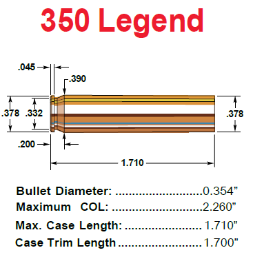

Post by stihl88 » 19 Jul 2023, 6:40 pm
There's several youtube videos on reloading the .350 Legend, I've not reloaded myself however have gathered some documentation in preparation for it.
I'll be having a go at developing a subsonic load using Trailboss also, will only be useful inside 100 but will still pack a punch.
See attached reload data, case dimensions etc.
Hope this helps.
