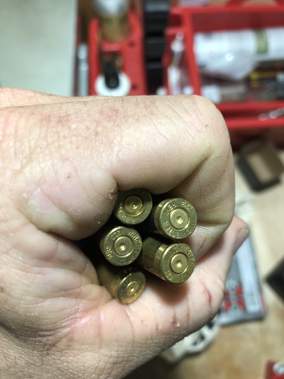

Post by kransky93 » 05 Aug 2023, 8:44 pm
Just wondering if someone could confirm if this is primer cratering or not?
Thanks guys

Post by JohnV » 05 Aug 2023, 8:55 pm
No not really a true pressure crater . Some bolt faces have a bit more clearance between the firing pin and the hole so they get that slight ring even when pressures are quite safe . Also softer primer cups will also help the ridge form . The outside radius on the primer cup is still well rounded that also indicates a safe pressure as the whole primer face has not been squished flat which would indicate higher pressures . The primers show some flattening so pressure is getting up there but still safe .

Post by Billo » 05 Aug 2023, 9:04 pm
Look OK from here

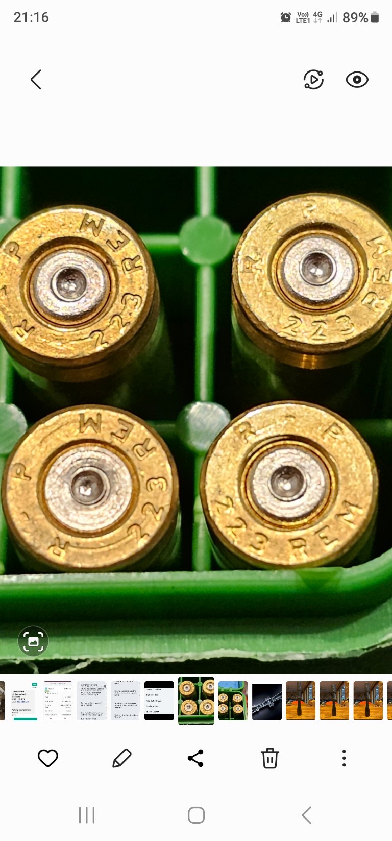

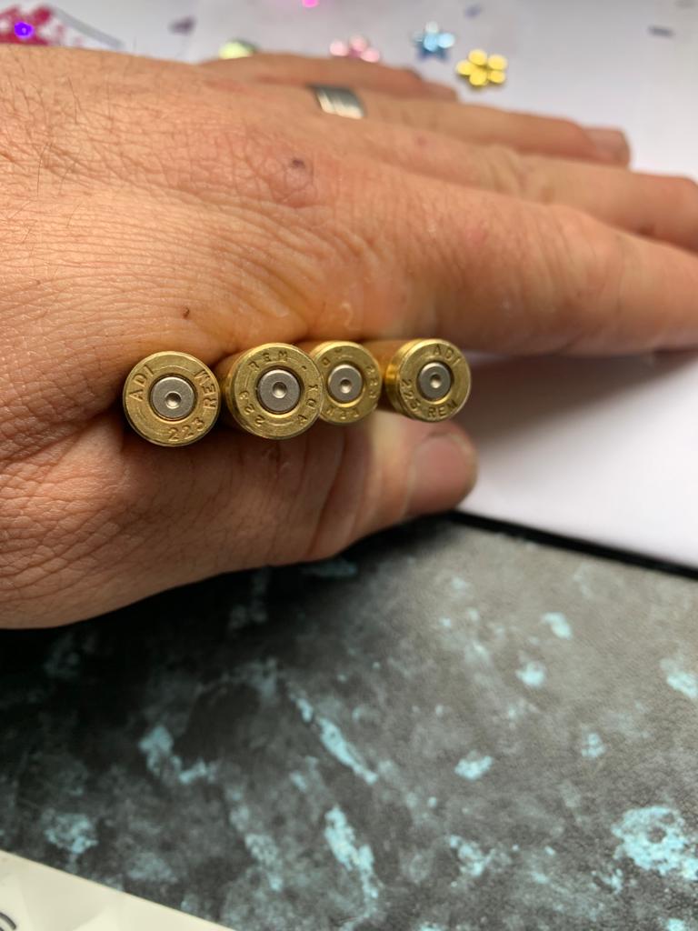

Post by kransky93 » 05 Aug 2023, 9:13 pm
These are some factory loads I have shot in the past and they don’t seem to look the same.
I had reloaded some other loads with the same primers but with 1 grain less powder and they didn’t look like the primers in question
I’m new to reloading so just making sure that’s all

Post by deye243 » 05 Aug 2023, 9:20 pm
Edges of primers still have a radius so all good .
Have a look at these they are mild loads but it as the wrong diameter fp and the fp hole needs to be sleeved

Post by JohnV » 05 Aug 2023, 9:21 pm
Those brassy looking primers are most likely Remington and they have hard cups . So they will take more pressure . If you look closely you will also see the firing pin indent is also shallower . I am not seeing anything unusual or unsafe .
Staying in a safe pressure zone is also a function of staying with powder recommended loads and not chasing max pressures especially while you are learning . If your loading manual says it's a starting or just a bit above starting load and the primers also look good and the empty case has no bolt lift problems or extraction problems . Then you are good to go .

Post by bladeracer » 05 Aug 2023, 9:24 pm
I'm not seeing any indications of pressure there.

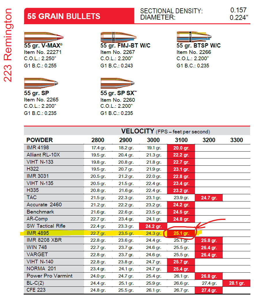

Post by stihl88 » 06 Aug 2023, 12:35 pm
223 - 55gr.png (179.26 KiB) Viewed 4441 times
25.1gr is the upper limit for this powder using the 55gr pills.

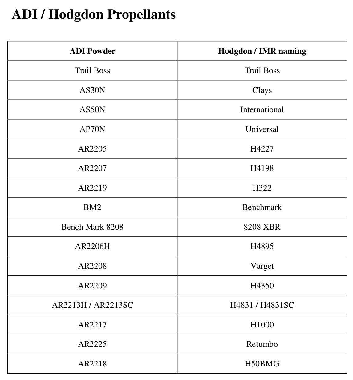

Post by Oldbloke » 06 Aug 2023, 12:44 pm
stihl88,
Can I ask where that data comes from?
Posts: 13399
Re: Over pressure
Post by deye243 » 06 Aug 2023, 1:21 pm
Hornady and imr4895 is not the same as 06H ...... H4895 is
Posts: 2610
Re: Over pressure
Post by Oldbloke » 06 Aug 2023, 2:44 pm
deye243 wrote:Hornady and imr4895 is not the same as 06H ...... H4895 is
Good pick up.

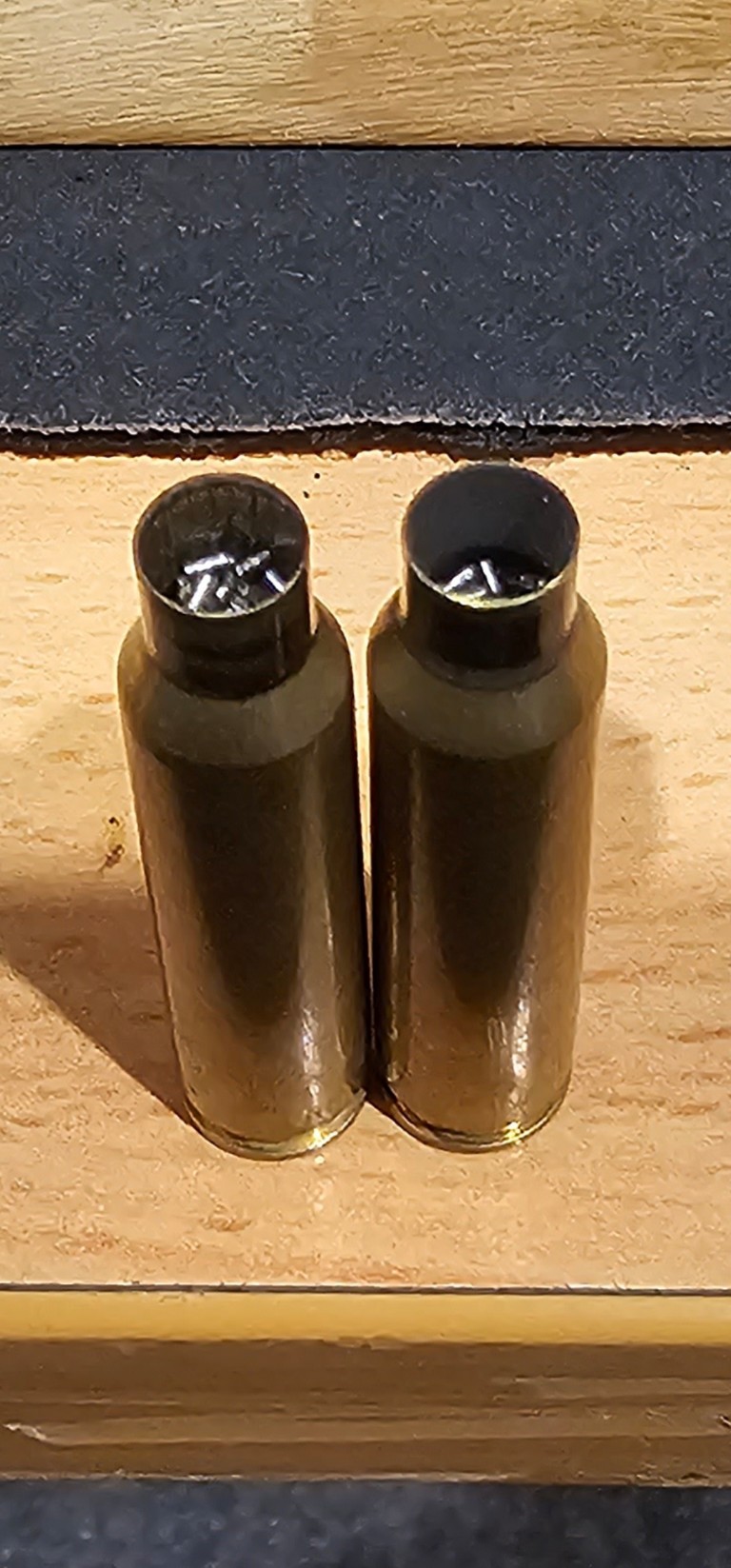

Post by deye243 » 06 Aug 2023, 6:29 pm
I load 26 for 3242 wich is a mild load and it sits just below the neck shoulder Junction in rem and adi brass .
Case on the left was dumped in the funnel the one the right was pored in so there was no bunching in the funnel.

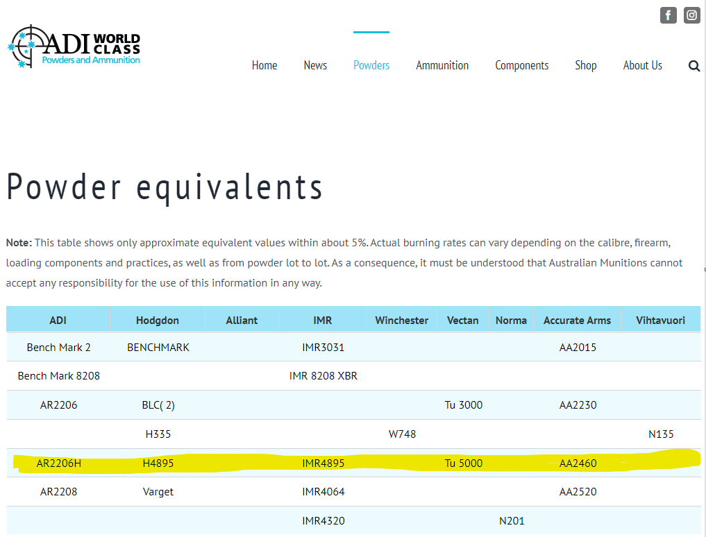

Post by stihl88 » 07 Aug 2023, 9:57 am
Correct but it is equivalent and I only have Hornady load data on hand, refer to ADI chart > http://www.adiworldclass.com.au/powder-equivalents/
ADI Powder Equivalents.png (58.83 KiB) Viewed 4354 times

Post by bladeracer » 07 Aug 2023, 10:46 am
Correct but it is interchangeable and I only have Hornady load data on hand, refer to ADI chart > http://www.adiworldclass.com.au/powder-equivalents/
Equivalent does _not_ mean the load data is interchangeable, it means the powders are designed to operate within similar parameters.
But, for all practical purposes I don't think there is much if any difference between H4895 and IMR4895 load data.

Re: Over pressure
Post by in2anity » 07 Aug 2023, 10:56 am
Can confirm, it's not. I bet it's just a howa.
Posts: 3107
Re: Over pressure
Post by kransky93 » 07 Aug 2023, 11:18 am
in2anity wrote:Can confirm, it's not. I bet it's just a howa.
Lithgow la102
kransky93
Posts: 14
Re: Over pressure
Post by in2anity » 07 Aug 2023, 11:33 am
kransky93 wrote:Lithgow la102
Is there a difference in firing pin size between small rife and large rifle la102s? The factory howas use the same size, so it's a bit large for the little fellas, and often will yield that outcome. Truth is, a lot of guns running hot, will yield that. Heck I've seen brand new Sakos do that.

Post by stihl88 » 07 Aug 2023, 11:54 am
My bad, I meant "equivalent", they're different powders with slightly different burn rates...
