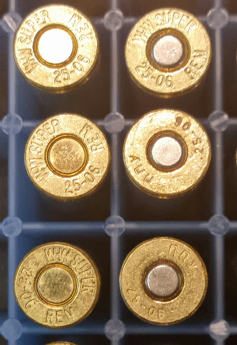

Amazing response re cleaning cases. Taking just fired and deprimed cases ,into sonic ckeaner ,with tsp of creme of tartar and enough water to cover ,results are absolutely thoroughly clean, dry carefully, economical and quick. Cases as shiny inside as outside.

Post by johnblackpigs » 12 Aug 2023, 7:54 pm

Post by bladeracer » 12 Aug 2023, 8:26 pm
johnblackpigs wrote:Amazing response re cleaning cases. Taking just fired and deprimed cases ,into sonic ckeaner ,with tsp of creme of tartar and enough water to cover ,results are absolutely thoroughly clean, dry carefully, economical and quick. Cases as shiny inside as outside.
He's asking about cleaning ammunition, and primed brass, not empty cases.

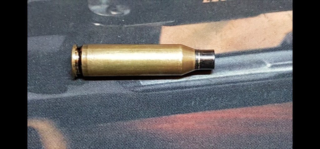

Post by madang55 » 17 Aug 2023, 11:49 am
And, while we're on the subject...I've got some Bertram projectiles coming. Apparently they're not shiny (pretty) like the big commercial brands. Could I give a few of those a quick dry tumble and see if improves the look? Or, those who have used Bertrams, are they that different?

Post by JohnV » 17 Aug 2023, 12:12 pm
Bertram look like they are just guilding metal ( Copper Zinc mix ) jackets so normal cleaning would work except for any soft nose bullet , Tumbling can damage the soft nose and ding up the lead . In that case just use the CLR wash method above and no chance of damaging any lead nose . It's not an experimental idea I have been using it to clean empty jackets and finished bullets for decades .
