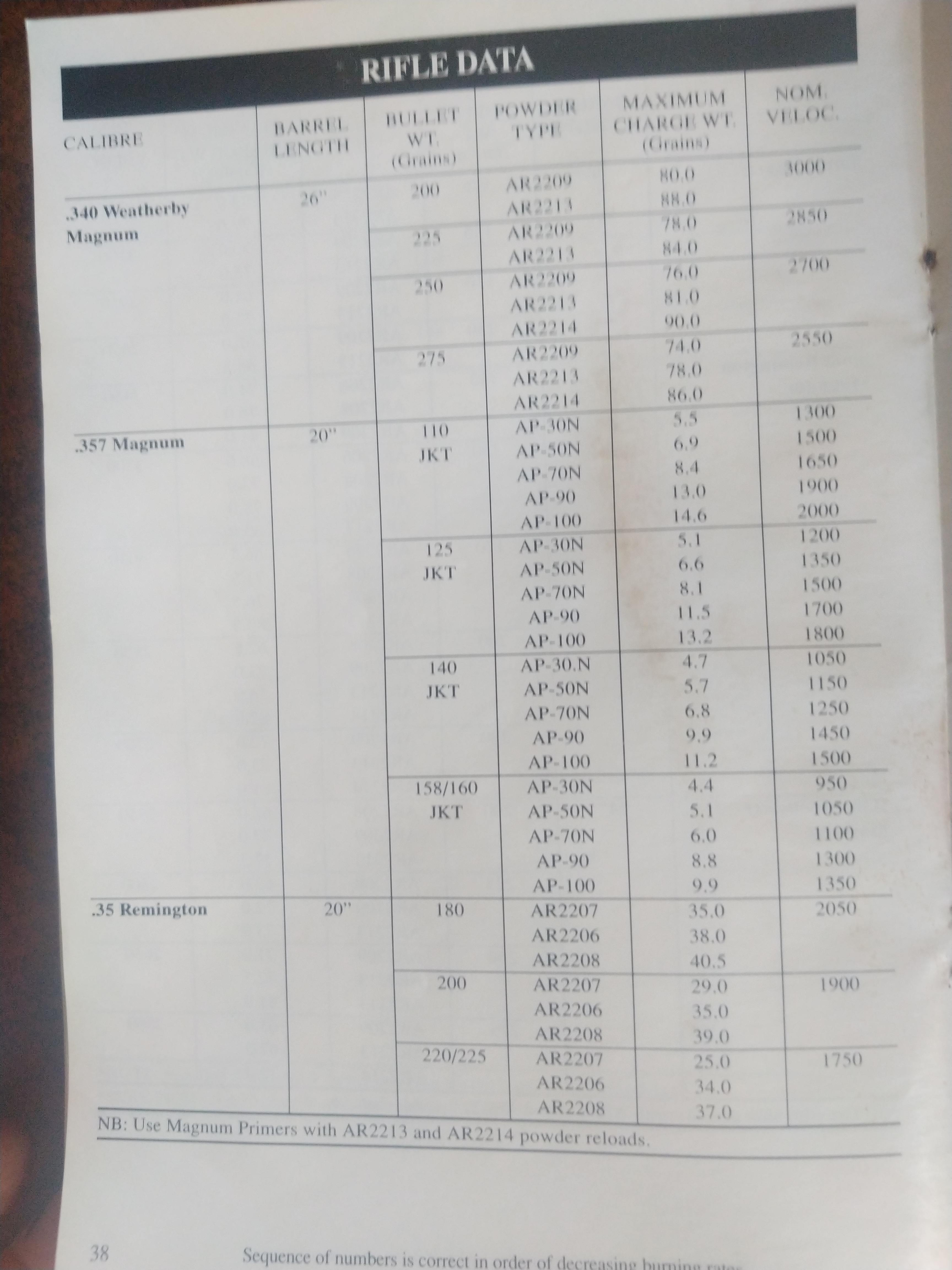

You could be excused for being confused about load data from different companies, I didn't say manufacturers because a lot of the powders available are made by ADI. I believe Hogdon never made powder just resold other brands. I was looking through a 1996 ADI handloaders guide and AR2205 isn't even listed for the .357.
