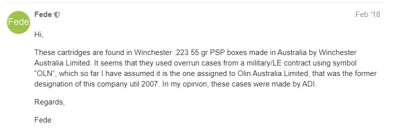

If it doesn't have "223" stamped on it then it's probably NATO 5.56x45mm (primer will be crimped), and OLN would lean me toward OLIN Corp, or Winchester.
I did find this:
https://forum.cartridgecollectors.org/t/unknown-5-56-headstamp/27294
Screenshot 2023-08-27 111322.jpg (34.18 KiB) Viewed 2268 times

Never seen OLN 13 headstamp that I can remember . Manufacturer code 13 is Cuba .
I did find this:
https://forum.cartridgecollectors.org/t ... tamp/27294
BladeRacer,
Thanks for that; Ties in with the handful of Winchester Brass in the bag.
I had wondered if it might be OLIN, but my searching didnt come across that article you found.
Many thanks.

Winchester Olin may well have initiated a contract and ADI could well have loaded the case but the case was likely made in Cuba or there was also one European company that used the 13 code . Don't think that Cuba would be out of the question as they have 230 arms factories managed by 16 Research and Development groups . Their arms and ammunition manufacturing is way bigger than ADI Australia .
