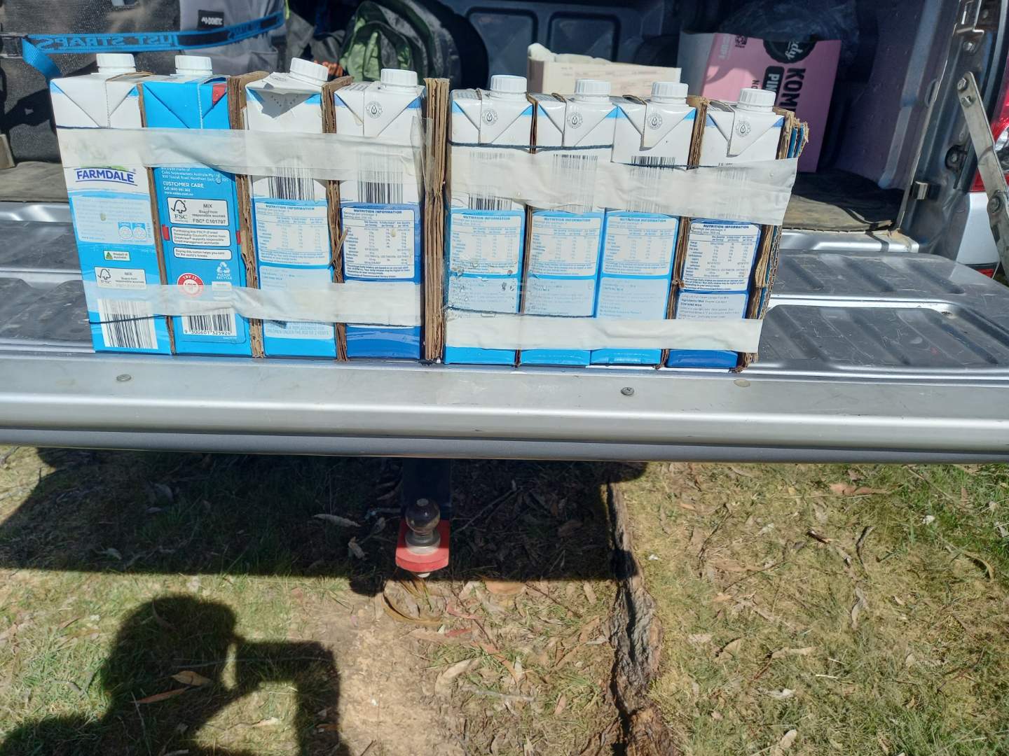

Last week i wanted to check if a bullet would mushroom on game. At least get an idea. So, i set up some long life milk containers filled with water along with some carboard between them.
125gr bullet at abt 2700fps.
Bullet passed straight through! Bullet lost. And little sign of mushrooming.
I know wet news paper was popular once but not much of that around these days. Lol
Planning another test soon and adding some additional cardboard. Perhaps some light plywood.
Is what i did a fair test?
Any ideas, suggestions?
KISS
Not interested in mucking around with gel
Edit. Forgot image. :unknown:

100 mm pvc pipe 3 m long. Not the thin walled 90 mm stuff. About half way along put a t junction Leave it open this is where u fill it with water. It’s also a pressure relief point Cap one end Plastic bag and duct tape one end. Peg it to the ground. Assuming safe backstop shoot the the replaceable bag. Bullet found and recovered inside tube. I made one but never tested it. I’m hoping the open t junction provides enough pressure relief to stop the pipe blowing up. A while back I tried sorceing gel powder but had no luck Someone said it’s available at Ali express and Amazon. Too much stuffing around. Not easy to cut the bullet out of the gel

The best thing I have used that I could get hold of is old wet phone books tied into a bundle but it is very difficult to reproduce an exact medium as even with say a pig hitting it in different spots changes the resistance .

Post by Oldbloke » 14 Oct 2023, 11:01 am
JohnV wrote:The best thing I have used that I could get hold of is old wet phone books tied into a bundle but it is very difficult to reproduce an exact medium as even with say a pig hitting it in different spots changes the resistance .
100%

Post by Oldbloke » 14 Oct 2023, 11:10 am
OK, a quick google tells me a 22lr will travel about 3ft in water.
Sooo, my test medium was totally inadequate for a 125gr doing about 2700fps.
(16" of water and a few sheets of cardboard :roll: )
Need a simple, portable solution as i will be out bush when i do this as i check my sights.

Post by bladeracer » 14 Oct 2023, 11:16 am
Oldbloke wrote:What are peoples thoughts.
KISS
The ideal is to find a lump of flesh and bone similar to the game you plan to use it on. If that's too difficult then I try it on lots of different media, soft and hard wood, clay, dirt, wet paper or rags, different thicknesses of steel, etc. Shoot a bunch of stuff and get an overall general idea of how hard the bullet is. We always have boles of wood - eucs, pines, all sorts so they're always handy to test in, both in cross-grain and end-grain. Setting up thin pieces with gaps between them gives very different results to shooting into a solid stack of wood. The dams are clay so it's easy to drag up a good bucketful for testing, I used to enjoy exploding clay lumps when I was a kid.
Water I've found is hopeless, it's good if you want to recover undamaged bullets for examination, not for deformation. But it's also difficult to work with due to gravity, it's easiest to fill a drum and climb up on the roof to shoot down into it.
Or just don't worry about whether the bullet might deform and simply take out the central nervous system.

Post by Oldbloke » 14 Oct 2023, 2:35 pm
Blr243 wrote:A hamas terrorist hung upside down from a tree with a meat hook thru his ankle .. remember that shots to the balls won’t provide enough resistance to result in useful information on bullet performance
Yes, that is one method that would work.
Putin too?
As I will be away camping needs to be very portable, light weight.
I'm beginning to think perhaps similar set up but fill the milk cartons (easily obtained) with alternating cardboard and loose dirt/mud. (fill them up on the day backed up with some pine or chip board to ensure the bullet is captured. Something like some thickish plastic or 3 ply on front to simulate skin.

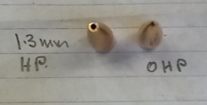

Post by Oldbloke » 14 Oct 2023, 8:38 pm
Blr243 wrote:What bullet is it ? And what is it for ?
Tipped sierra2121. 125grMatch King HP. (500 very cheap)
My usual 130gr SP is currently unobtainamle. still have a few tho.
But HP is about 0.2mm, tiny.
Have discovered MK tend to act like FMJ on game. Once tipped a 1.3mm HP is exposed so hoping they will work ok.
Intended use fox up to fallow.
Ill just sell them if i cant make it work.

Oldbloke wrote:As I will be away camping needs to be very portable, light weight.
In that case let your ballistic medium walk itself into the bush. Shoot a deer, pig, goat, etc then shoot your test rounds into the thickest parts of it and recover them for evaluation, shoot downwards so your bullets are stopped by the ground if they do pass through. If you want to see how they perform at range you'll have to load some reduced loads for testing as well to replicate the velocity remaining at 100m, 200m, 300m etc.
I had to shoot a cast sheep five weeks ago, so I checked out the remains the other day when I was up in the same place. Nothing left but the spine with ribs still attached, about 20m from where I remembered (I photographed it so have GPS coordinates to put me close enough to sweep the detector around), and the wool has all blown another 30m across the hill. The skull is missing. I'll have to take a metal detector up there and see if I can recover the bullet on the ground. Unfortunately I had taken my extra ammo out of my kit while moving to the second property and had left it in the vehicle or I would have tried some subsonic 145gn SP and some high-velocity 100gn HP on it as well to recover later.

Post by Oldbloke » 15 Oct 2023, 12:00 pm
Blr243 wrote:Tipped like that I think u got nothing to worry about.
Yeh, Its more about confirmation.
Cup thickness is abt average for a hunting bullet.
Lead is about average BHN for a hunting bullet too.

Post by Oldbloke » 19 Oct 2023, 3:05 pm
John v
If u dont mind?
1. What is the HP diameter?
2. What is the cup thickness?
3. What is the BHN of the lead core?

Post by Oldbloke » 21 Oct 2023, 10:34 am
JohnV wrote:The Core BHN is close to 5 , the meplats outside is .055 it's too hard to measure the hole .
Cup thickness no idea never measured it . Think the CH jacket is fairly parallel inside and .021 thick near the base but the J4 Jacket is very parallel and about ,018 thick . It's for target bullets but once it is core bonded the jacket thickness is less relevant .Cup thickness is not a parameter I need to model a bullet .
Sorry should have said jacket, not cup thickness.
BHN =5 pure lead
Jacket= 0.021"
HP= abt 0.80"
The 125gr Im toying with after tiping are:
Weight=124gr
BHN =7.6
Jacket= 0.30"
HP= 0.050"
Have since loaded up some to test.
HP = 0.079"
Everything Ive seen & heard strongly suggests they will work fine.

Post by JohnV » 21 Oct 2023, 11:06 am
They look like they will work fine to me . My Corbin presses can't handle much over pure lead , 7 would work but be pushing it and placing more strain on the dies and press . If I had a larger Corbin CSP2 Mega Mite press with bigger dies I could use harder lead alloy . It's not worth the investment for me now as what I have works fine and makes really nice accurate bullets . If I could find a reliable supply of quality jackets I might buy bigger presses and supply the forum with some bullet but it's too expensive now buying in small lots . It's hard to make a decent profit selling at the same price as commercial bullet makers and people can't see much difference in the product especially when all kinds of wild claims are made about brands with dubious BC's quoted . Also people are impressed by boat tails and I would need extra dies to make rebated BT's . Never mind the fact that the World 1000 yard benchrest record was broken a few years back with BiB flat based bullets .
My 180 grain corbonded bullet will perform just as well as a Woodleigh , it's made the same way but with more care than mass production can supply . Heat Core-bonding does cause a slight loss in group accuracy . However I discovered a little trick to reduce that effect which I am not going to share because it makes my bullets better .
When I look back at old bullet specs I see I have made meplat's as large as .093 . From memory I think I closed them up a bit because the ejection pin was going down into the lead core and leaving a mark . Probably would do nothing negative but I did not like it .

Post by Oldbloke » 21 Oct 2023, 1:47 pm
I did some measuring a few weeks ago and these are the results. I cant swear to the measurements being precise but they are very close. I'm playing with bullet 1. Bullet 2 is the bullet it will be replacing and worked well when I shot a fellow in April.
In any case just comparing them gives the strong impression they are in the " ball park" and should work OK.

Post by JohnV » 21 Oct 2023, 2:29 pm
It's very hard to compare bullets unless you have very expensive equipment . Just a different ogive shape can throw out the BC and affects the trajectory compared to the other . I tend to model anything new in JBM Point Mass program . However it took quite a bit of research to understand all the many inputs and that was years ago and I might have forgotten some of it but I ahve it written down someplace . Like who the hell knows what an RT/R ratio is ? If the ogive is slightly secant, the number has to be less than 1. If it calculates to 1, it is tangent, but if it calculates to .5 it is completely secant. In other words, .98 is slightly secant. So I just enter 1 for a Tangent ogive . I have tried going each side of 1 and it makes SFA difference to the calculated BC's once the list is averaged .
I don't think you can really compare an Interlock or Partition bullet with a cup and core flat base or with a boatail bullet . Drag functions would be different and terminal ballistics quite different . From what I can see your bullet should be close to the SPEER .308 CAL 130GR VARMINT HP in ballistic performance . This is where you can model your bullet and work out it's BC but it's hard to use .https://jbmballistics.com/cgi-bin/jbmmpm-5.1.cgi Make sure you select Point Mass trajectory and include Coefficients at the bottom . Many of the inputs are in calibers not actual measurements so everything in those boxes needs to be the measurement divided by the caliber Ex. meplat diameter .055 -:- by .308 = .1786 . However the smallest that you can enter is .250 which is strange so for bullets like ours just enter .250 . I talked to James Brad Millard about that and never got a straight answer . Get back to me because your going to go nuts .
