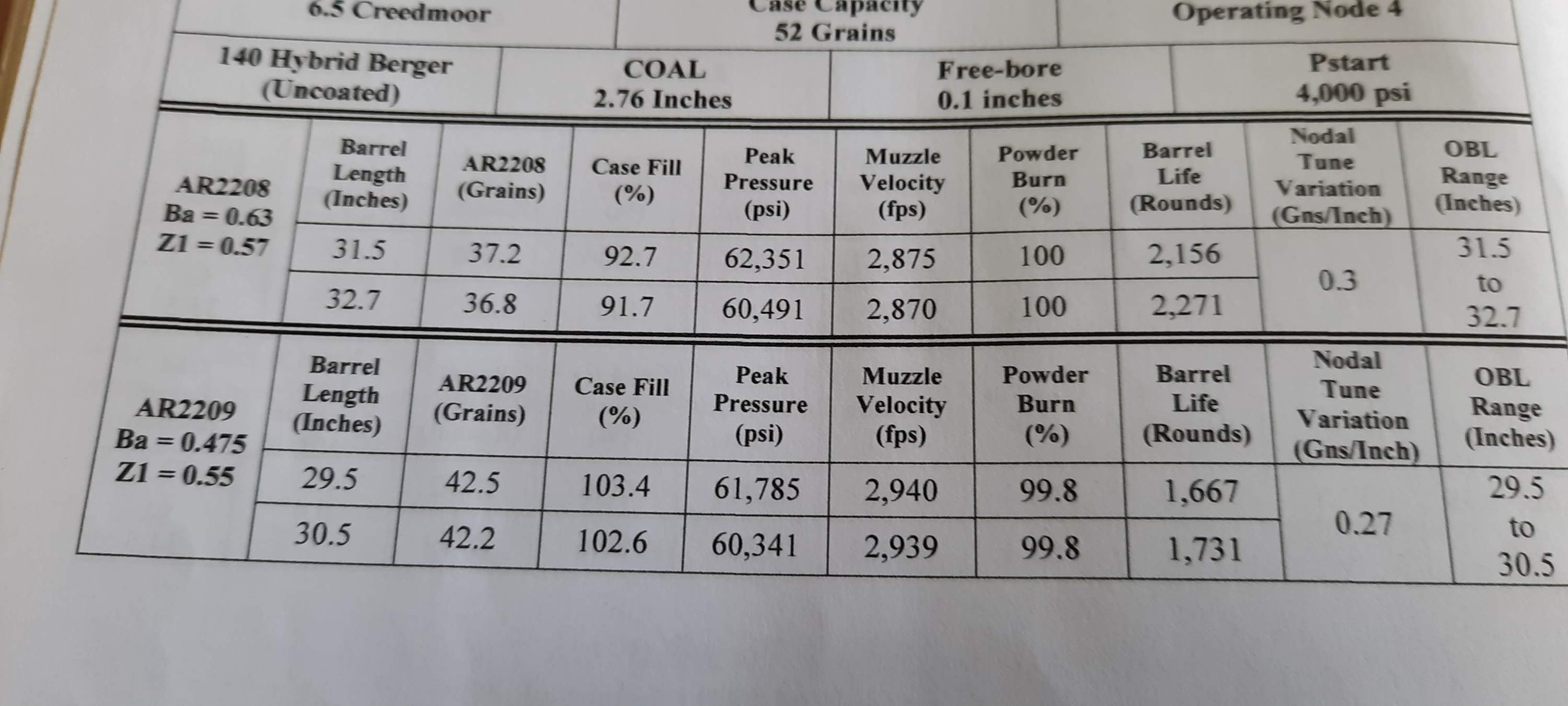

Post by Wyliecoyote » 28 Nov 2023, 10:16 pm
Comparison of 2208 and 2209. Velocity gain may not be worth the barrel life where this data confirms what i have seen over many years and dozens of barrels, 2209 is the most erosive powder in mid sized cartridges. Reloder 26 in my own experience is showing better barrel life and speeds comparable or exceeding this data but in a 26 inch barrel. The pic is from a manual listing many long range cartridges with data taken over several years from numerous shooters in Fclass mainly and compiled by a respected Aus shooter.
In a 24 inch barrel take off around 200 fps min using either of those powders. The loads listed are not necessarily max loads but are known accuracy loads again sourced from many notable shooters both here and overseas.
