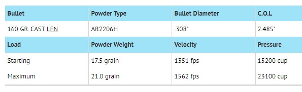

This is ADI's Cowboy load with AR2206H in .30-30 with 160gn cast bullets.
Screenshot 2023-11-13 173538.jpg (24.51 KiB) Viewed 15132 times
I would load one up on 15gn and chrono it in your rifle - with the suppressor, then move up or down from there until you get where you want to be, then start loading to find an accurate load. I use the Berry's 150gn for these, as I said, they are not going to deform at these speeds but they give good enough accuracy for head-shots out to 50m or so. I also use the 100gn semi-jacketed RN Plinker as it's also cheap and uses a significantly smaller powder charge. The more powder you're burning the louder it will be. BM2 I'm sure would work but I've never used it.
Pistol/shotgun powders also work well in reduced loads but are very hard to find currently. Stripping powder out of 12ga. shells is your best bet there. You could also use the lead shot to cast your bullets. CBE do some nice heavy moulds. Use soft lead and the bullets should hit very hard. https://www.castbulletengineering.com.au/products/rifle-moulds/30-cal

This is very interesting
But its 308. About 30% of the max load, not 60% as suggested by ADI

Oldbloke wrote:This is very interesting
That's because the "60% rule" has never been an actual limit with AR2206H.
