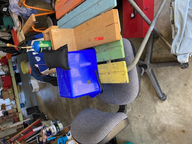

Post by Wm.Traynor » 11 Dec 2023, 2:04 pm
As promised but very, very late I have pleasure in presenting my annealing contraption, in glorious Technicolour
I sit in the chair holding the drill etc, resting on both the upturned bucket and black pillow. The folded jeans in the fore ground have been hosed and put on a milk crate and at the right time, the drill is emptied on to it.
Project No. 1.jpg (142.56 KiB) Viewed 5545 times

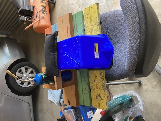

Post by Wm.Traynor » 11 Dec 2023, 2:11 pm
Project 46.jpg (128.52 KiB) Viewed 5544 times
A side view but a bit closer, revealing the intricate Carpentry of the gas bottle retainer.

Post by Wm.Traynor » 11 Dec 2023, 2:13 pm
Project No. 1.jpg (142.56 KiB) Viewed 5544 times
