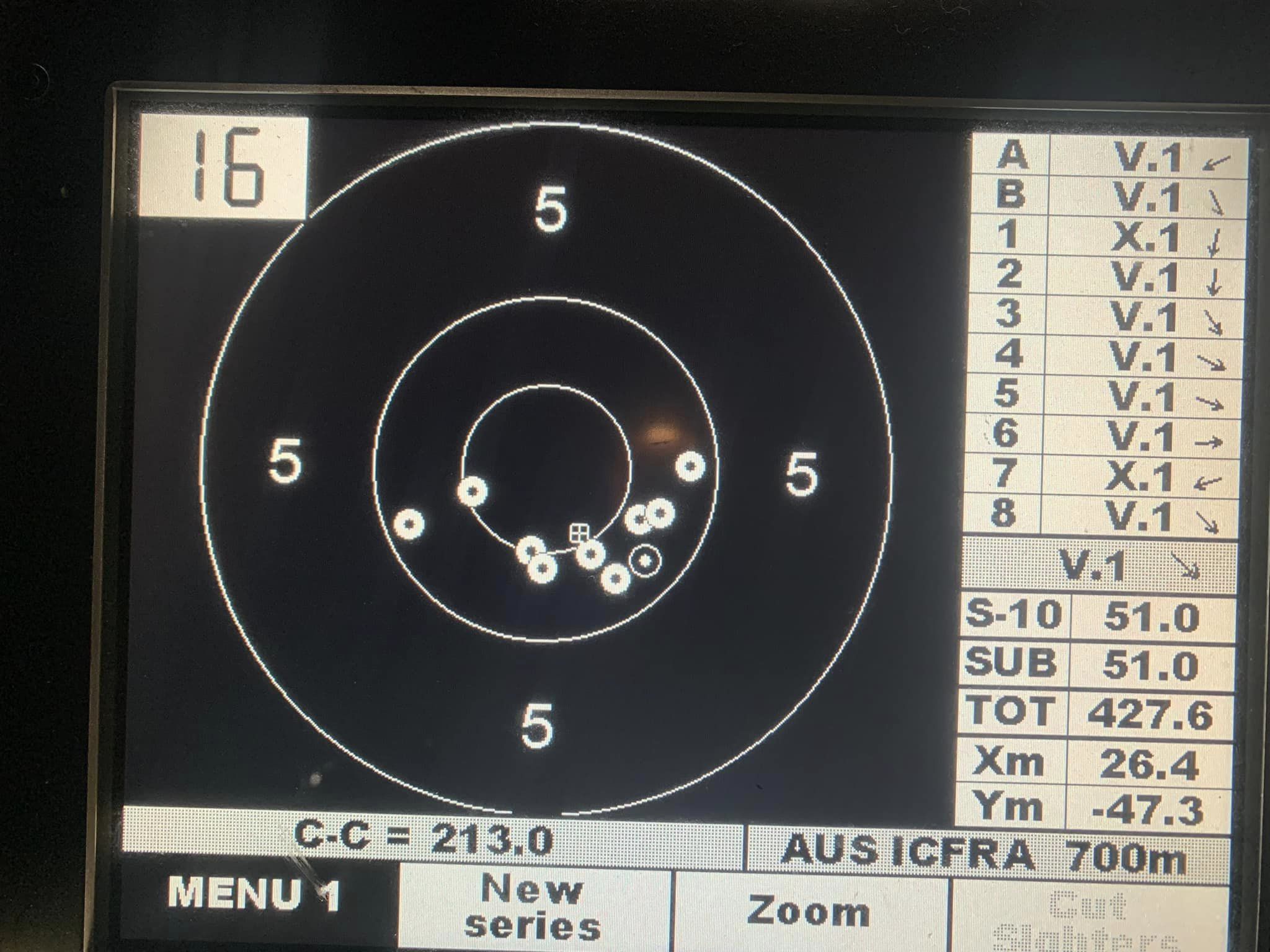

Post by in2anity » 12 Jan 2024, 2:54 pm
I don't shoot F, nor do I talk much to F class guys. But the majority of TR shooters I rub shoulders with, simply anneal and FLS. Shoulders are kept bumped to prevent galled lugs, and cases are trimmed. Doesn't need to be overcomplicated.
With good projectiles and a strong emphasis on precise seating depth, this is the outcome out of the TR sling with a Barnard (i.e. not rested on anything):
SHOT FROM THE TR SLING
Thats a 51.00 - maximum possible score for TR. It's also an F class possible as well, because their integer starts at the V ring. It's a 60.2 in F scoring. Note the waterline is from the wind, not anything else. It's 1moa horizontal at 700m, less than 1/2moa vertical.... with a basic lee FLS die.
As I said, reading the wind correctly is IMO more important than going full tacticool-tard on your ammo. Reading the wind is a skill in and of itself that takes years of refinement. Just use high quality consumables like Bergers and Lapua brass, and learn to read the wind, and you can theoretically go 1/2moa.

Post by straightshooter » 12 Jan 2024, 3:41 pm
I don't want to take the wind out of your sails because that is an impressive target for a TR shooter by any measure, but the width of the center bull is approximately 1.25 moa on the 700 meter target with the super center half that.

Post by in2anity » 12 Jan 2024, 4:18 pm
Yes you are right SS, I stand corrected. My point was, look at what basic reloading practices with quality consumables can do!

in2anity,
That is excellent elevation.
