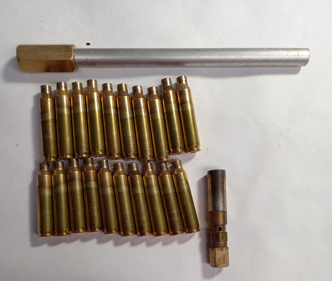

Wm, I just held the drill when I used it. A battery screw driver will works too provided the socket fits. Aim the flame at the case shoulder.
But last few times I just did it manually with a handle of ally tube (old tv aerial) pushed onto the "case holder" the SIL made for me. (Top left of pic.) First time a bit of wooden dowell with a hole drilled in the end to take the case. Lol
Works fine and I now excusively use the small "pencil" torch in the pic for both 30.06 and 223.
Edit: the small diameter of the ally tube makes turning it very efficient, and it's very light weight. It isn't rocket science.

Found the pic I was looking for.
"Case holder" with ally tube.
223 cases and "pencil" gas tip.
The smaller tip does take a bit longer, but, gives greater control IMHO.

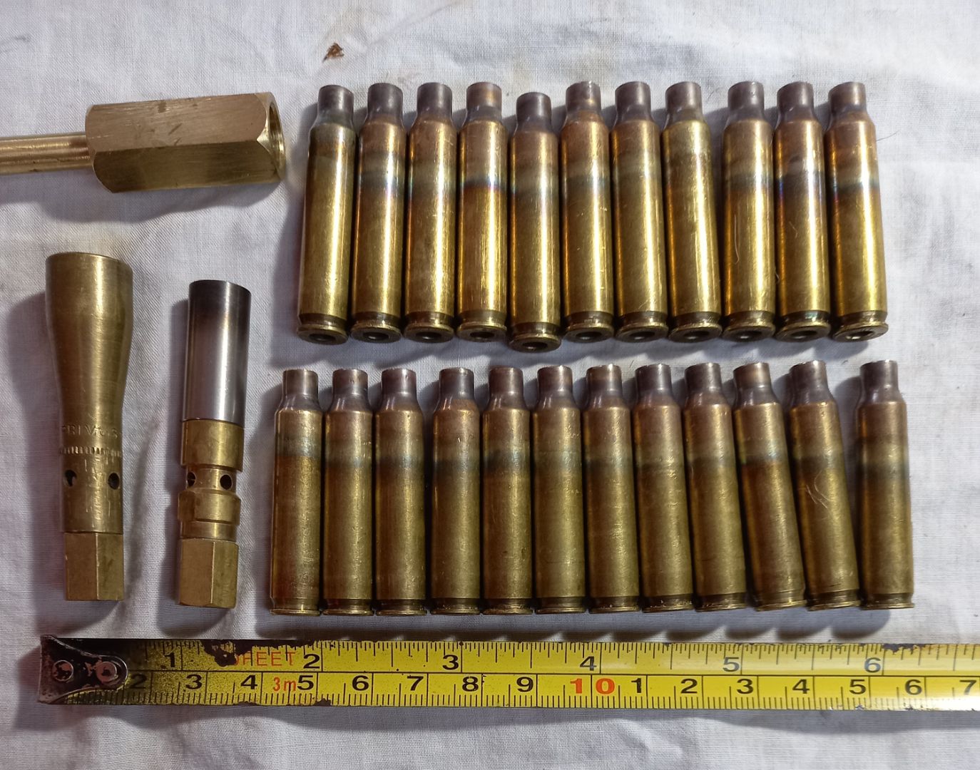

I was getting the nice coloring exactly like ADI bought ammo but I think you do need to get to the cherry red stage to bring the brass back to it's original softness after work hardening.
I still avoid bright red but you want more than just a bit of blue.
I think that 2nd pic from Old Bloke shows an under-annealed batch.
If it was FarceBook I would see 50 posts calling BS but I am pretty sure its the truth of the matter.

My under annealed brass. ??? Perhaps. Hard to say. In any case will get done again after 3-4 fireings. So no big deal.
