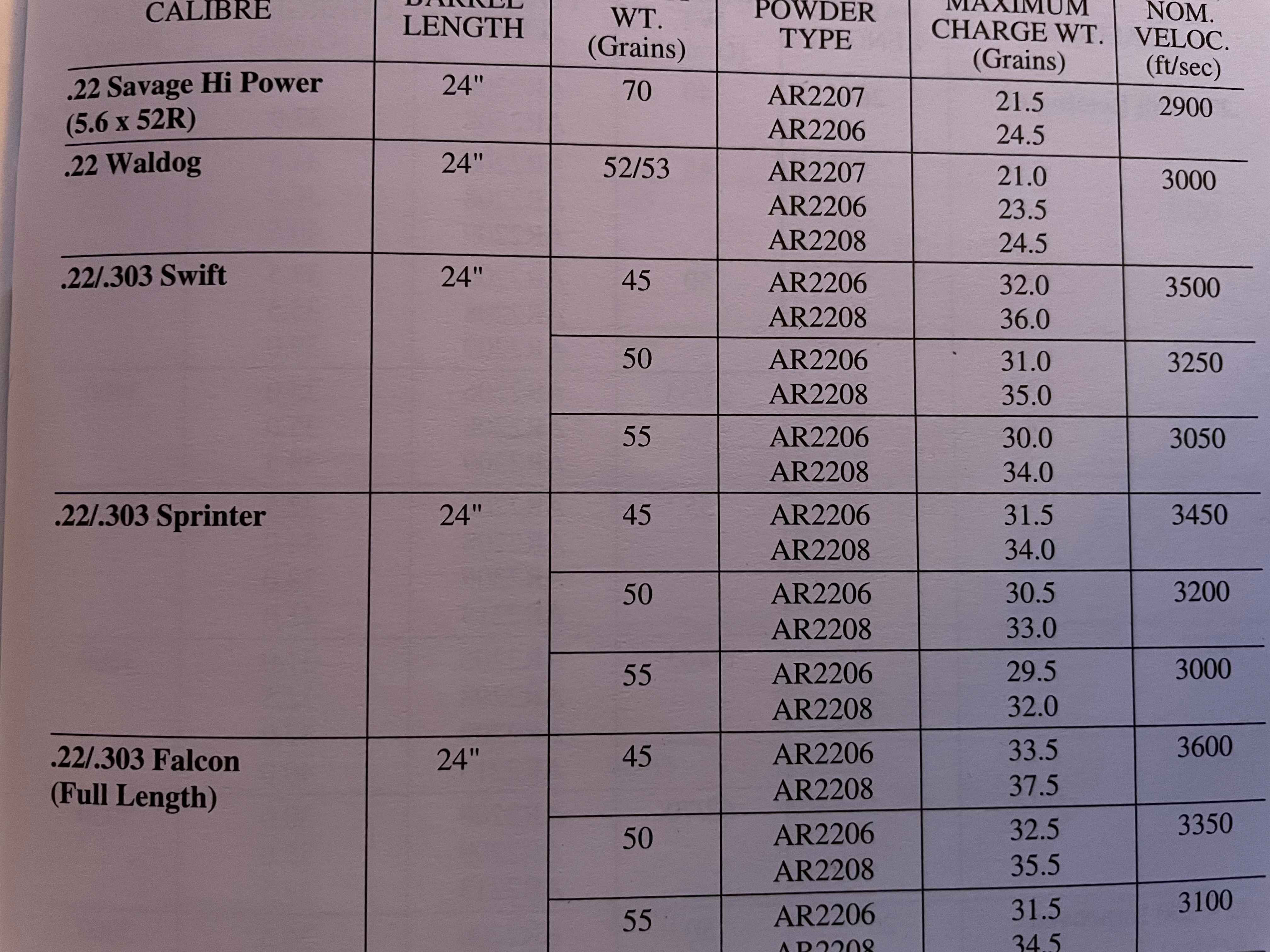

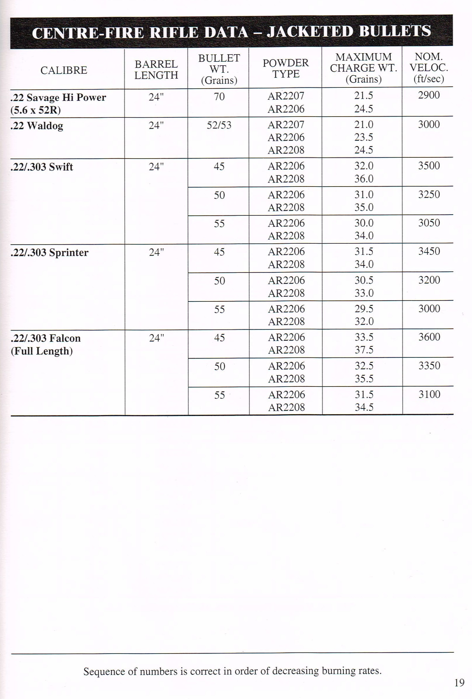

Does anyone have any load data using ADI powders for this caliber
I KNOW there are several variants of it , I KNOW
I am notsure what oneit is, I am in the process of dertimining what it is
Any data to start will be appreciated
The only inf. that Ihave been abletofind is an old Nick Harvey data,it`s 32gr of 2208 for a 55gr projectile
I willprobably go with that, butI would at least like to know what else there is

G'day mate, until you know what version you have it is going to be impossible to suggest data, I would recommend you start with Sprinter data until you are certain you have a Falcon, and not one of the many "one off" gunsmith specials.

What is the case length or case capacity?
early ADI data

Post by 6878mm » 02 Dec 2023, 12:23 am
Thankyou very, very much
Thisis exactly what I wanted
This looks like itcame out of an ADI book,what year was it
I have the latest and an earlier version, printed in 1996 and they do not list them
Thanyou again

Post by Pendous » 02 Dec 2023, 7:33 am
1st Addition ADI,1996 copy is the second.
Heres a better copy/scan to print/save.

Post by 6878mm » 02 Dec 2023, 9:59 am
It`s the 2nd edition that I have

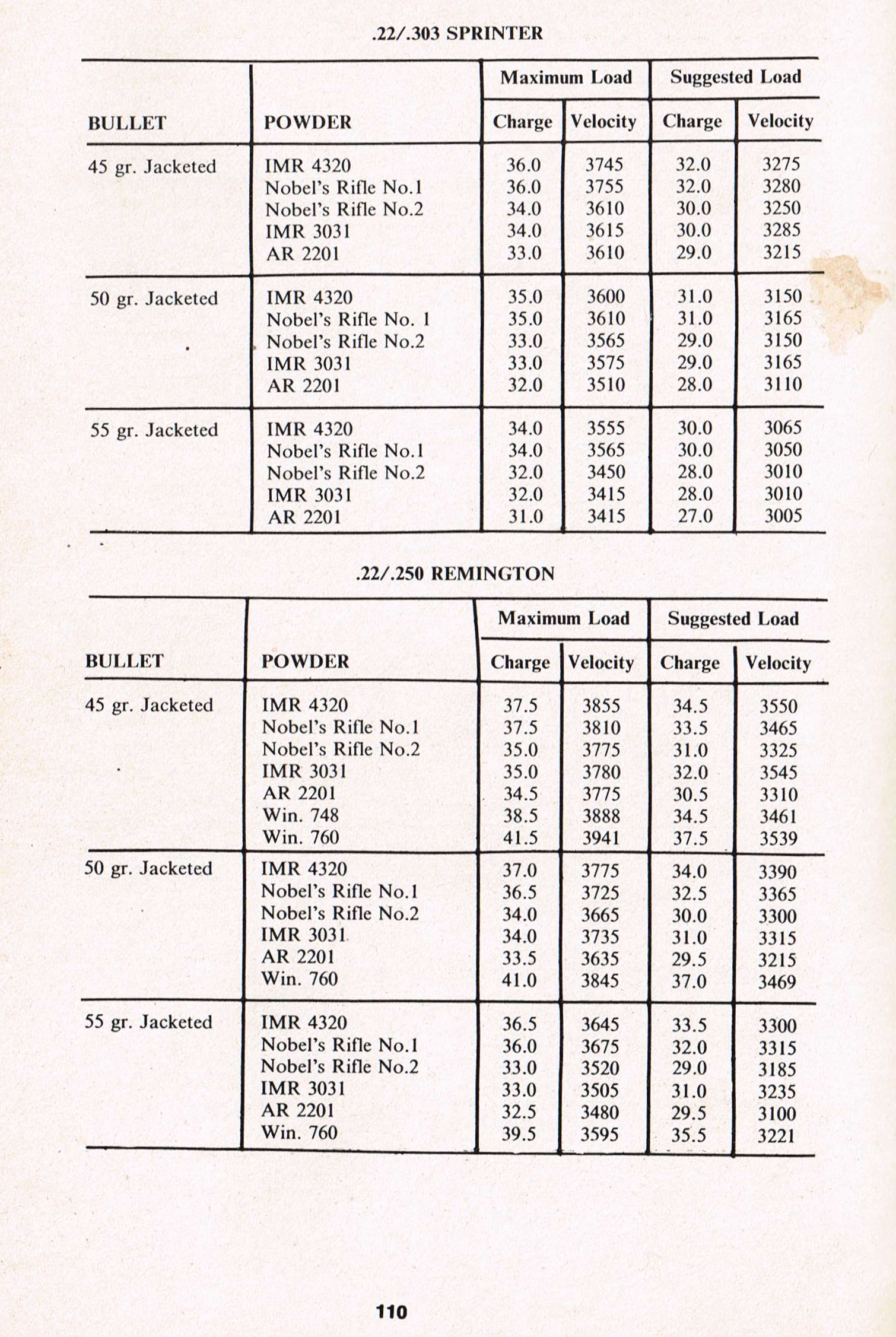

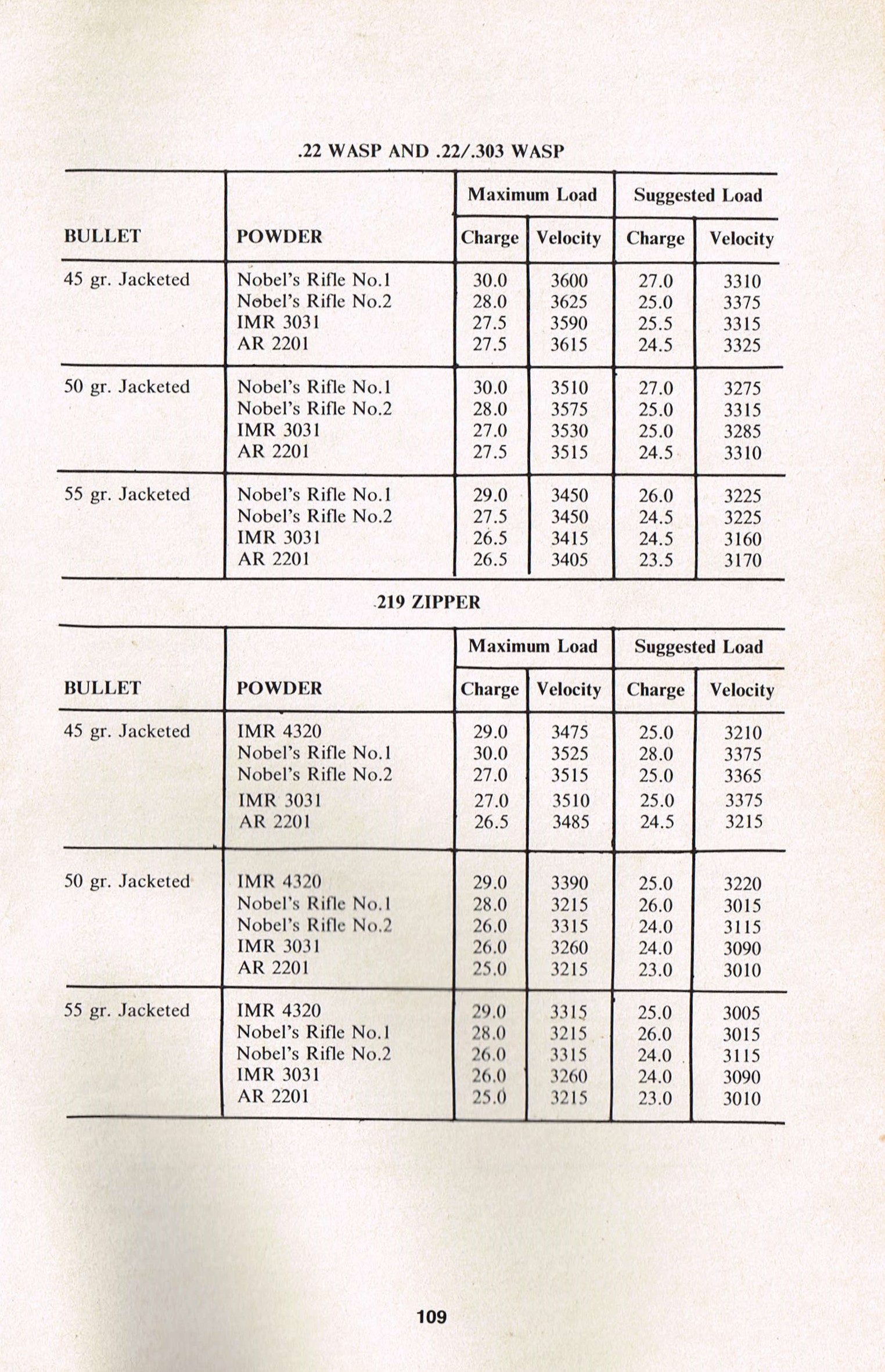

Post by straightshooter » 05 Dec 2023, 6:57 am
Waterworth.pdf
(540.03 KiB) Downloaded 414 times
Here is some additional info from a 70's version of Reloading Simplified by Cyril Waterworth.
You might have to do an internet search of burning rate tables to establish equivalent modern powders.
As for the various names applied to a 22/303 I believe the only real issue is whether your case is simply a full length 303 necked down to 22 or a shortened case.

Post by Pendous » 05 Dec 2023, 9:13 pm
Scan_20231205 (2).jpg (740.55 KiB) Viewed 5463 times
