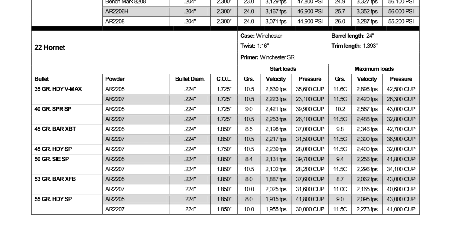

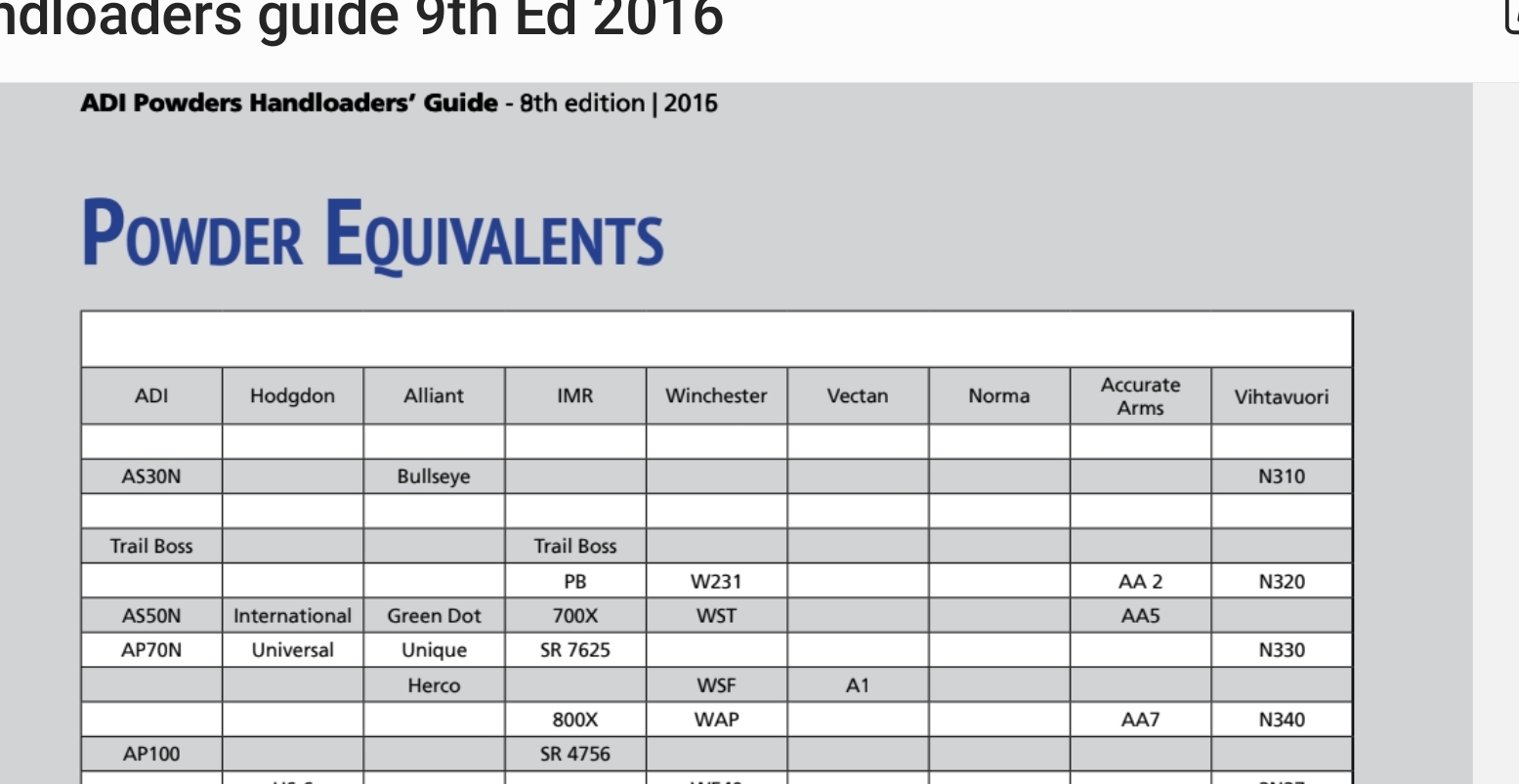

Re: Looking for powder to suit 22 hornet
Post by JohnV » 28 Dec 2023, 2:03 pm
AR 2205 is a Hornet powder but AR 2207 is not that much slower and can also be used and sometimes gives better velocities . http://www.adiworldclass.com.au/data-rifle/22-hornet click on the warning link . If AR2207 is all you can find then it is usable .
These Powders are said to be burning rate equivalents to AR2205 :------ H4227 / H110 , IMR 4227 , W296 , R-123 , AA 1680 , N120
These Powders are said to be burning rate equivalents to AR2207 :----- H4198 , Reloader 7 , IMR 4198 , W680 , Tu 2000 , N200 , N130
Any of those powders could be used to carefully work up a load in a 22 Hornet .
Hodgdon H4227 is in fact ADI AR2205 .
Hodgdon H4198 is in fact ADI AR 2207 .
CFE BLK would work also .

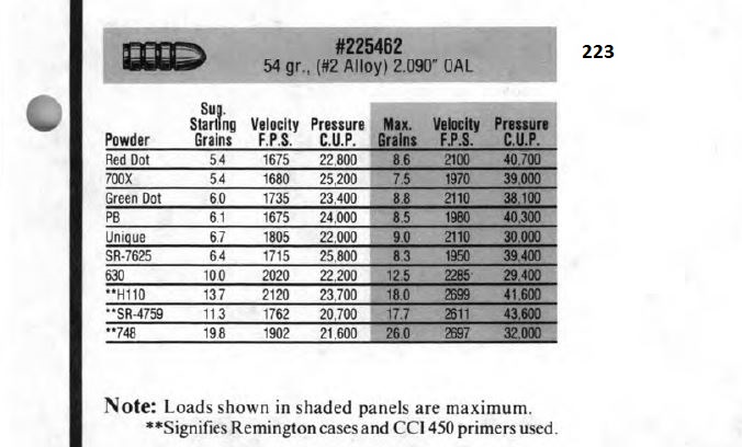

Post by bladeracer » 28 Dec 2023, 3:10 pm
Hogking wrote:The only one I've got my hands on is 2207, it's too damn slow. So anything in the 83-88 range should be more suitable. I'm using 33 hammers, I'm told w296 is good and then little gun and 2205, but there are others out there suitable too. Appreciate any help, can return favour with advice on south Island hunting, in nz that is.
Cheers Dusty.
You're going to have to use whatever you can find. Some sort of pistol powder if there is any in NZ, there hasn't been any here in Oz for three years outside of a few small imports of Vectan, Lovex and Vihtavuori. AR2207 is your most likely choice, otherwise start stripping 12ga. shotshells for the powder.

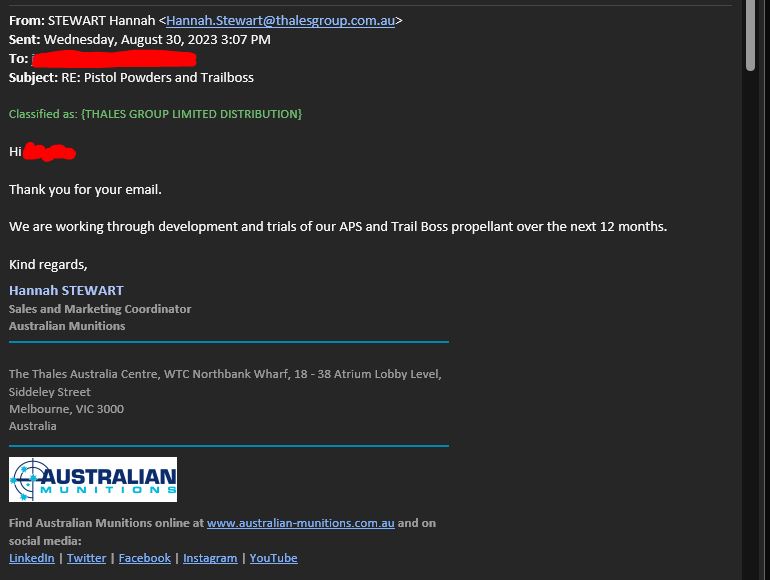

That’s great news blade regarding testing new pistol powders and trsilboss. First time I heard that. I was thinking never again and I was not happy about it. If I’m careful my stash of unique ap70 red dot and trail boss will last me till 2026 but Only if I’m real carefull . I’m just so glad that there is finally some light at the end of the tunnel.

Post by bladeracer » 29 Dec 2023, 7:45 pm
Blr243 wrote:That’s great news blade regarding testing new pistol powders and trailboss. First time I heard that. I was thinking never again and I was not happy about it. If I’m careful my stash of unique ap70 red dot and trail boss will last me till 2026 but Only if I’m real carefull . I’m just so glad that there is finally some light at the end of the tunnel.
One of the members here posted his communication with ADI a few months back - I saved it.
I emailed them just before that and got a similar response.

Attached: of equivalents that you MAY be able to use.
Attached: example 222 & 223 loads from Lyman Reloading Handbook 48th Ed

Obviously check equivalents carefully and double charging is the main risk due to cases often being less than half full.
Lyman 48th squib 223 55gr.JPG (79.59 KiB) Viewed 18874 times
222 Cast Bullet squib loads.JPG (114.58 KiB) Viewed 18874 times
