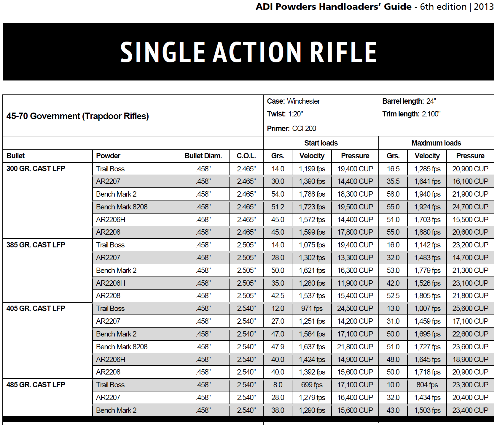

Hi all
I have a h&r trapdoor 1873 little big horn model in 45/70
I am wanting to use cast 500 grain projectiles and 2207. Powder
I've been using 2207 with 405 grainers at 29 .7 grains but wish to use the 500 grainers
I K ow loads are available for black powder but really want to use smokeless
Powders o. Hand are

You might find this of some use.
QuickLOAD 500gn data seems to agree with ADI
Interestingly, the on-line ADI data no longer shows anything for 45/70 in the "Single Action" listing.
Usual proviso - caution.

I just made a few Sierra HPFN 300grains with 30grains 2207 for the next outing, I'm sure the Sierra's will expand and work well even at that speed. Will post back when I get a chance to shoot it
I guess not much to go subsonic from here, keep in mind the Trapper is a short barrel so you would loose some speed

Post by zbenga » 18 Feb 2024, 7:22 pm
I tested 30 grains of 2207 with 350 Hornady FN core locked and was very unburned, might need some filling under 30 grains
30 grains on marlin trapper gave me: 995.0fps, SD 16.5 and spread of 40, might increment a little to see if I can reduce the SD and burn better and keep it under 1100 fps
