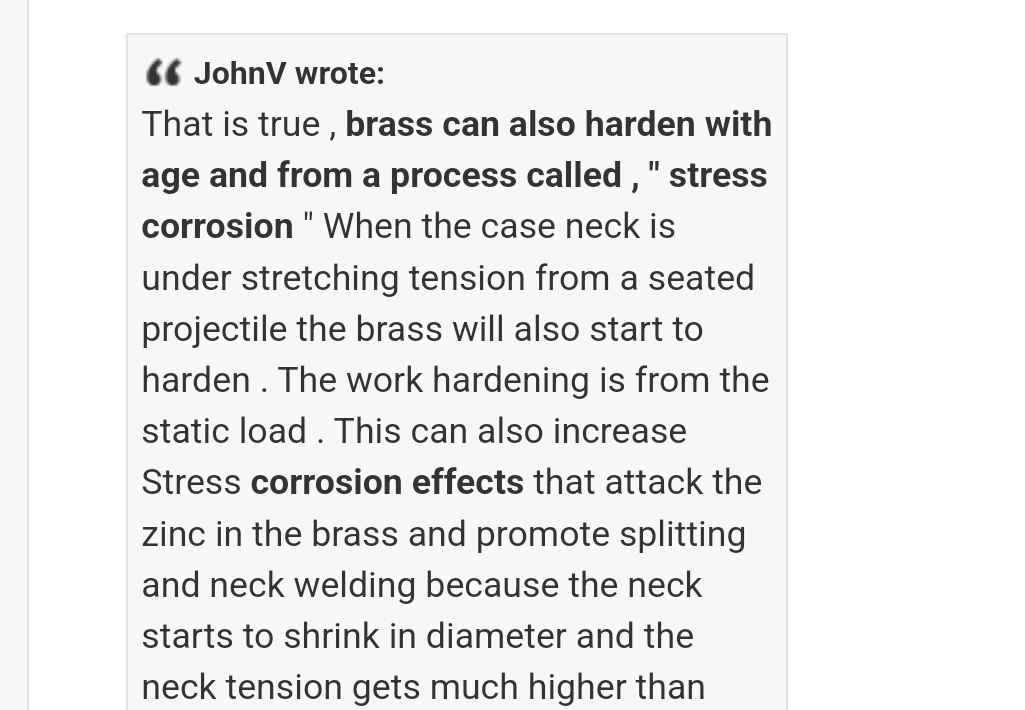

Post by Oldbloke » 30 Jan 2024, 5:18 pm
Sounds to me your saying it gets older with age
No mention of it being work hardened or corrosion due to chemical attack.
Screenshot_20240130-181539_Samsung Internet.jpg (178.89 KiB) Viewed 6192 times
Has nothing to do with age.
It's poor annealing combined with corrosion. Simples.

Post by JohnV » 31 Jan 2024, 6:22 pm
Oldbloke wrote:Sounds to me your saying it gets older with age
FFS sake read properly " AND from a process called stress corrosion " . TWO separate statements about two different things .

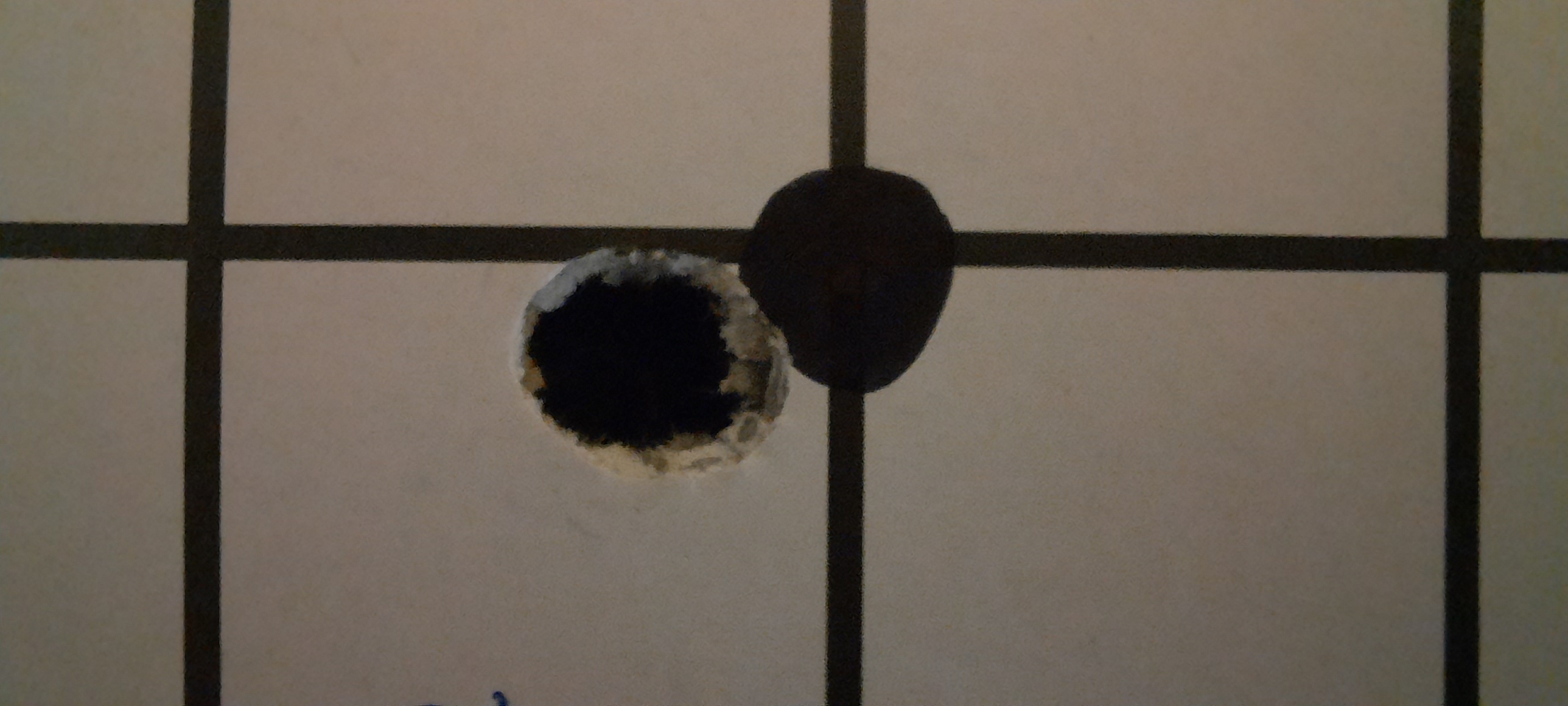

Post by Wyliecoyote » 03 Feb 2024, 6:36 pm
Anyway guys, the main benefit of annealing is case life, specifically the necks. The other benefit is easier sizing and bullet seating.
I shot a benchrest match today, just a club match getting ready for the upcoming season. The 30BR i shot today has a 3 groove Krieger 17 twist in it that is relatively old in age but low in shot count. The load is known but the cases were annealed using the AMP where in the past these cases or others were never annealed and usually tossed after 10 firings. It shot like a dog, all vertical with the two groups we shot at 100m going 6 and 7mm, both vertical slots. I struggled to hit a dot at the Hunterclass stage in light winds and overcast skies. Then at 200m two groups at 20 and 13mm, again vertical slots. There were no dots hit at 200m in the Hunterclass stage.
Sooo, after the match i dug out some cases that weren't annealed, loaded them and shot a group of 3mm and the other looks like a single bullet hole that is in the high zeros. The point here is i changed one thing in the process, namely annealing, because I'm lazy and wanted to extend case life where 30BR cases take a lot of work to form and 6BR cases are expensive and hard to get these days. While i anneal alot, the 30 BR was never subjected to this process as we only get one or two matches a year if lucky. Somewhere in that process something has changed and is giving me vertical which is usually associated with not enough powder. Now I'm not saying annealing has a bad effect on this rifle, I'm saying it needs adjustment as the neck tension is not quite enough allowing it to realease the bullet just slightly earlier and off it goes from there to not competitive. Hunterclass which those that shoot it know is not about the score, it's the dot count that seperates the top end. 250s are expected at both ends these days.
Photo below shows the last group fired, 5 shots with my own 116 grain 8 ogive bullets on one inch J4 jackets, 34 grains of 2207 and 205s in unannealed Lapua cases.
