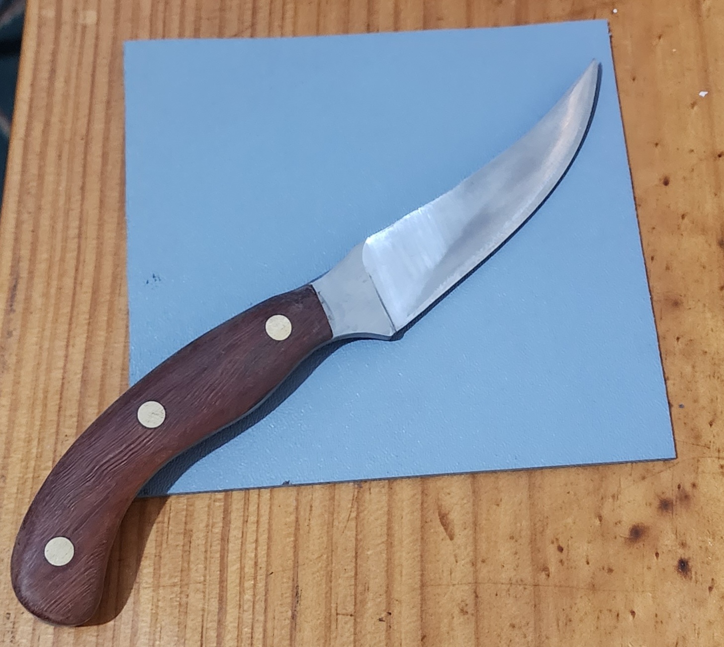

Re: Lee "Perfect" Powder Thrower
Post by Lazarus » 27 Feb 2024, 8:54 am
Don't get too excited, I'm not one of the guys that make artwork pieces.
I make no fuss tools that do the job without pretensions.
Mind you, if you want pretentious I can etch designs on them, but it's a fiddly fukkery.
This is a sticker for a crazy pig stabber, he wanted big, he got big.

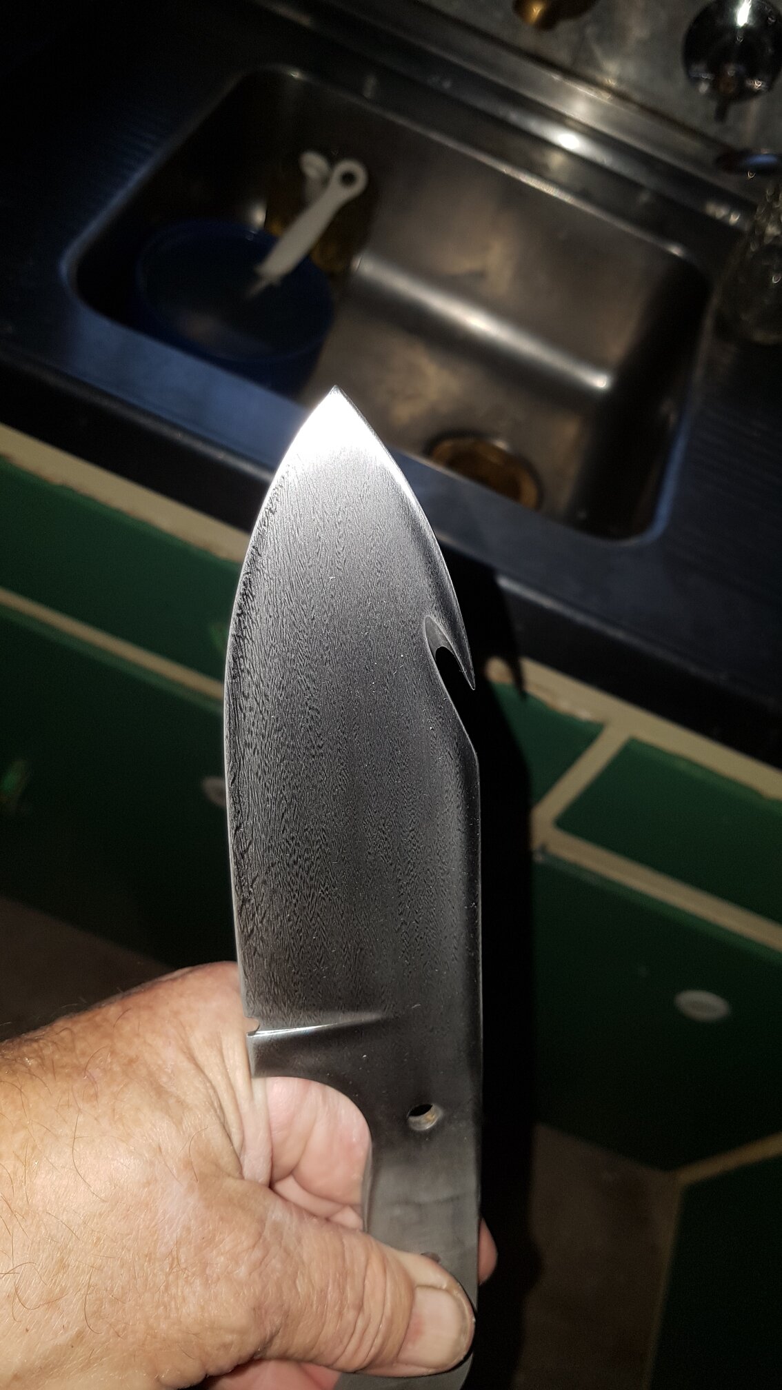

My first attempt at a guthook

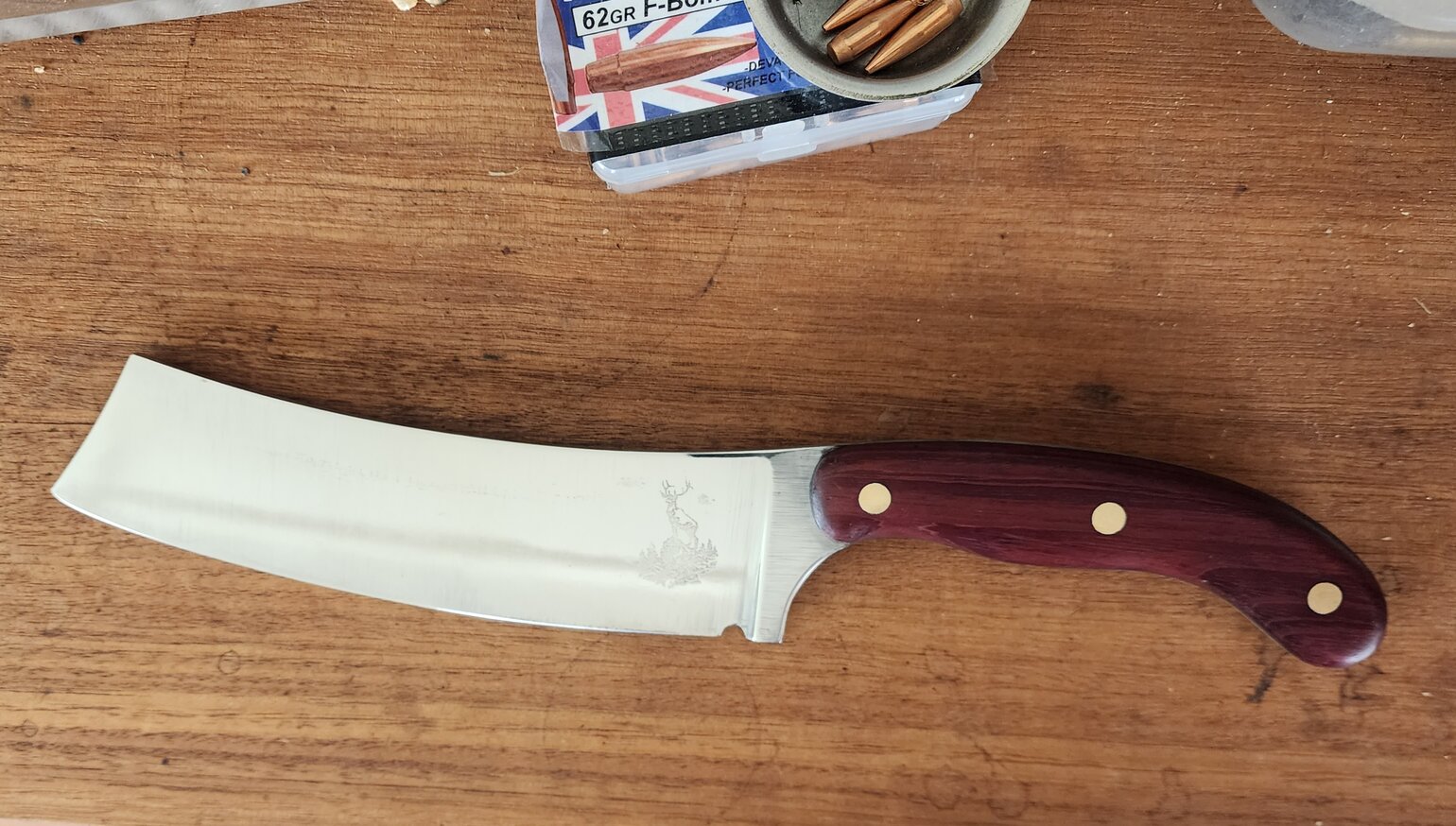

Two cleavers made from a large "harvester" saw bar

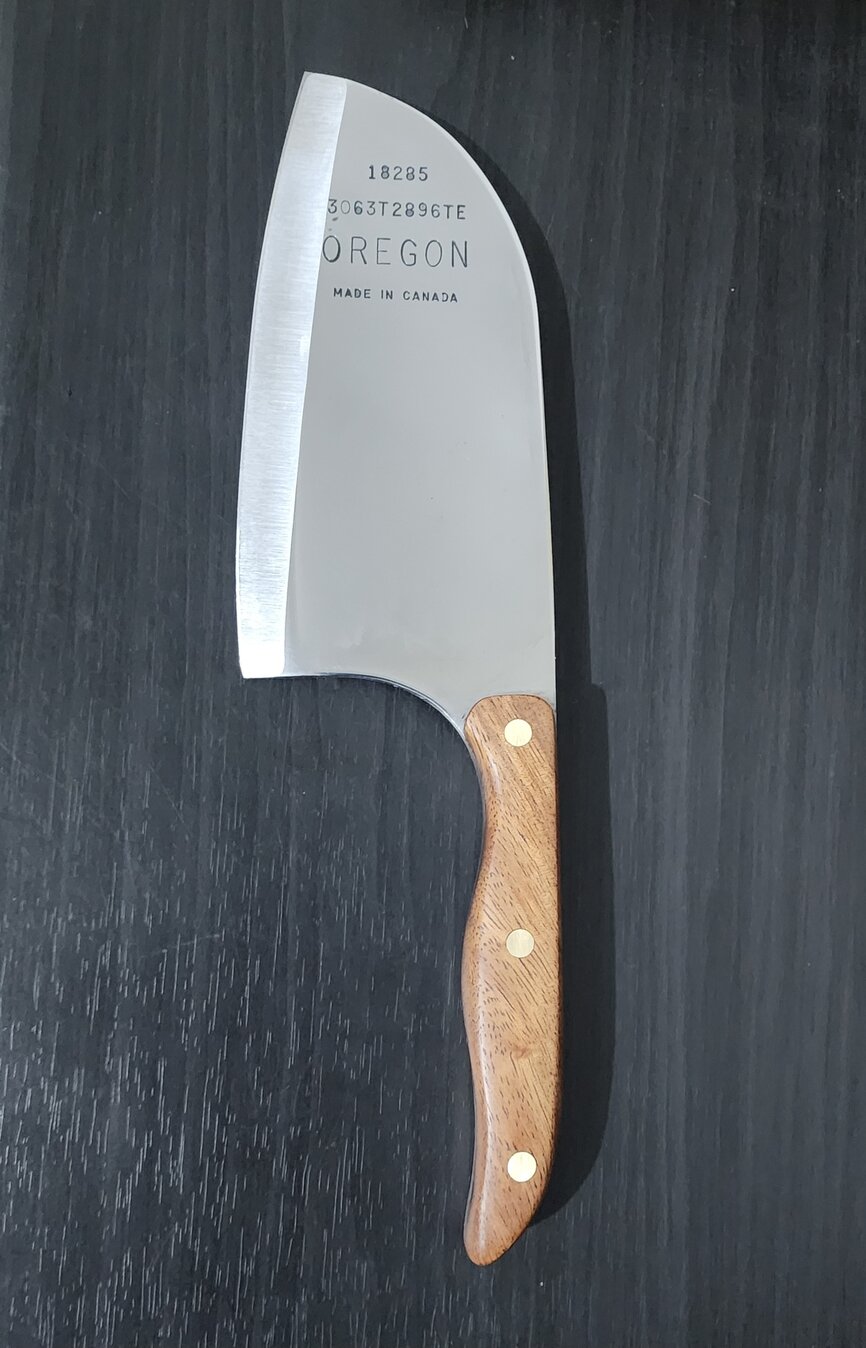

The most popular has been what I dubbed the Sweeney Todd razor, slices like nothing I've ever used

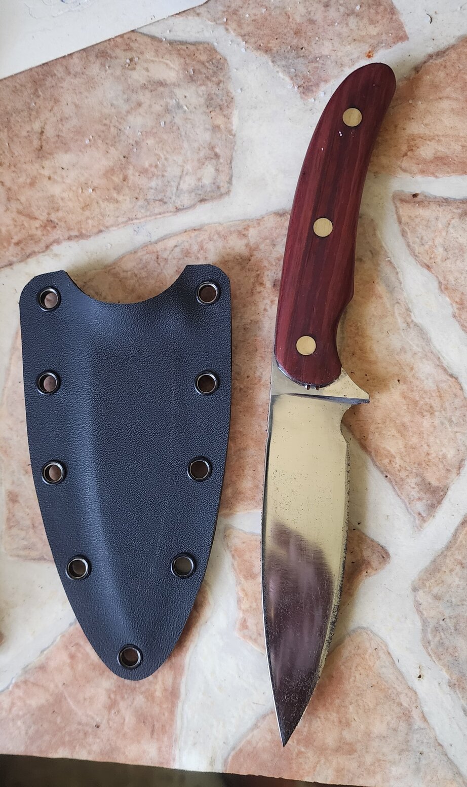

I just added this small drop point hunter

Being already hardened and tempered, they're tough as hell on grinder belts, as you can imagine.
The upside is that with careful handling you can make a really tough blade that you don't need to treat, the downside is more work than necessary to achieve a decent finish.

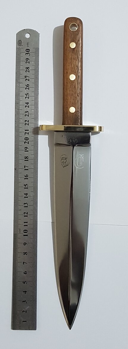

Since I'm showing off, this is a small "Sharp Finger" I do, also from saw bar.
The owner is among other things a contract butcher, when I saw him several months later, he said he'd processed 250 sheep and 60 cattle and hasn't needed to touch the edge yet.
I'm using 1075 now, what a nice change, before it's hardened, the big grinder eats it like cheese.

Well, my Lee thrower is doing OK. I think techniques has a lot to do with it. And of course your expectations ans budget.
Hey, Laz, knives look pretty dam good to me.
IMHO the drop point shape is a bitter too pointy. Should be more like the puma pal.
Horses for courses tho.

Post by Lazarus » 28 Feb 2024, 6:50 am
True OB, the point can be vulnerable, but I make them from 4.2mm stock, to make them as sturdy as possible.
Boy does it disarticulate a critter in quick time, though.
