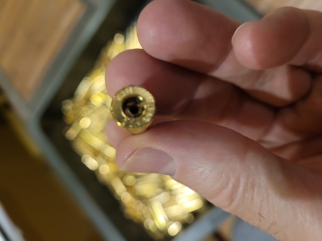

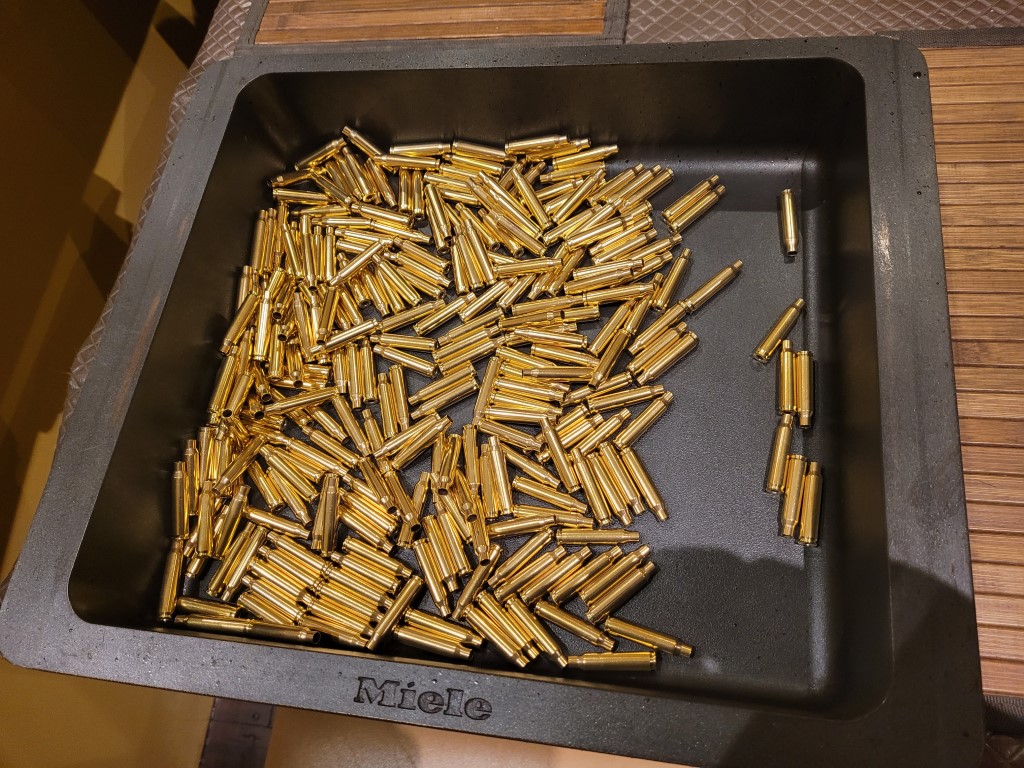

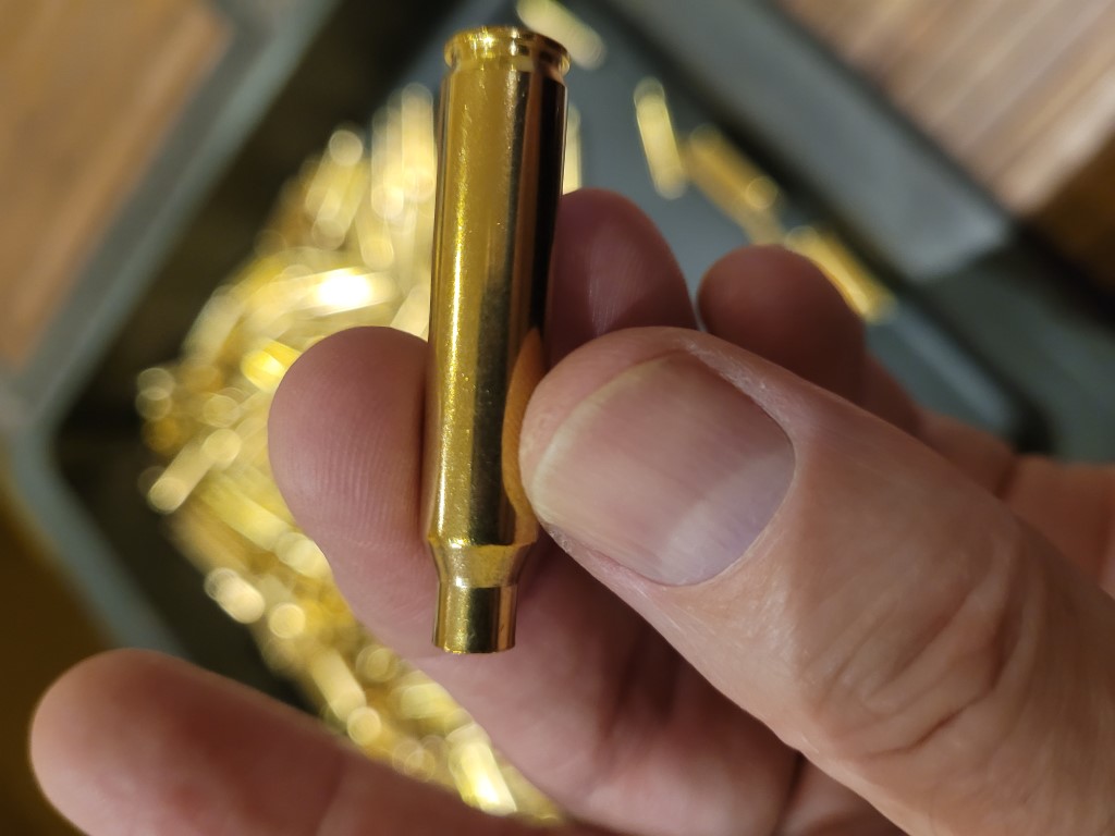

Post by mchughcb » 08 Mar 2024, 7:45 pm
Here is the first 250 of 1100. The large pockets get cleaned out well. The smaller ones not so well but not too bad.

Post by wanneroo » 09 Mar 2024, 12:35 am
That's what we want to see, nice clean shiny brass.

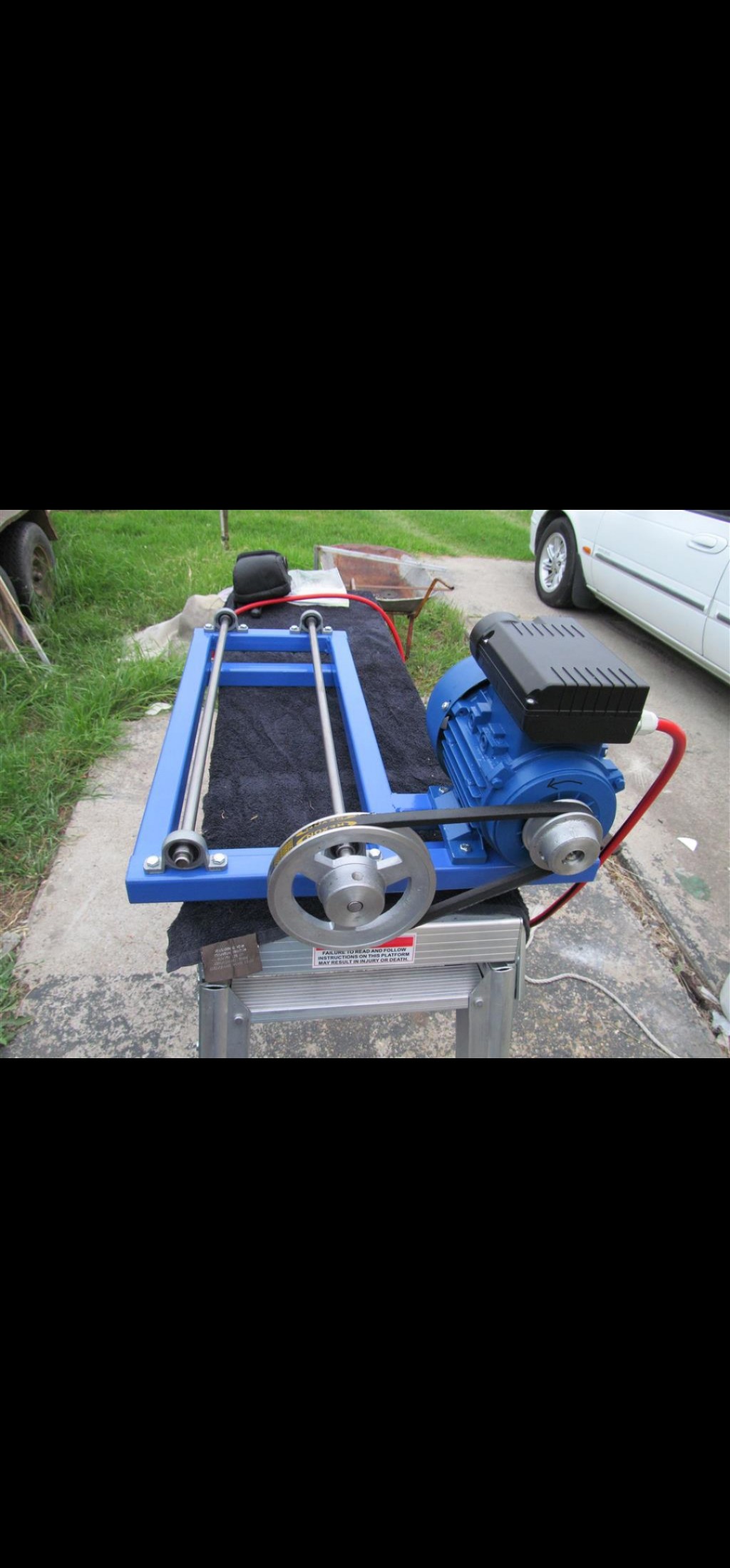

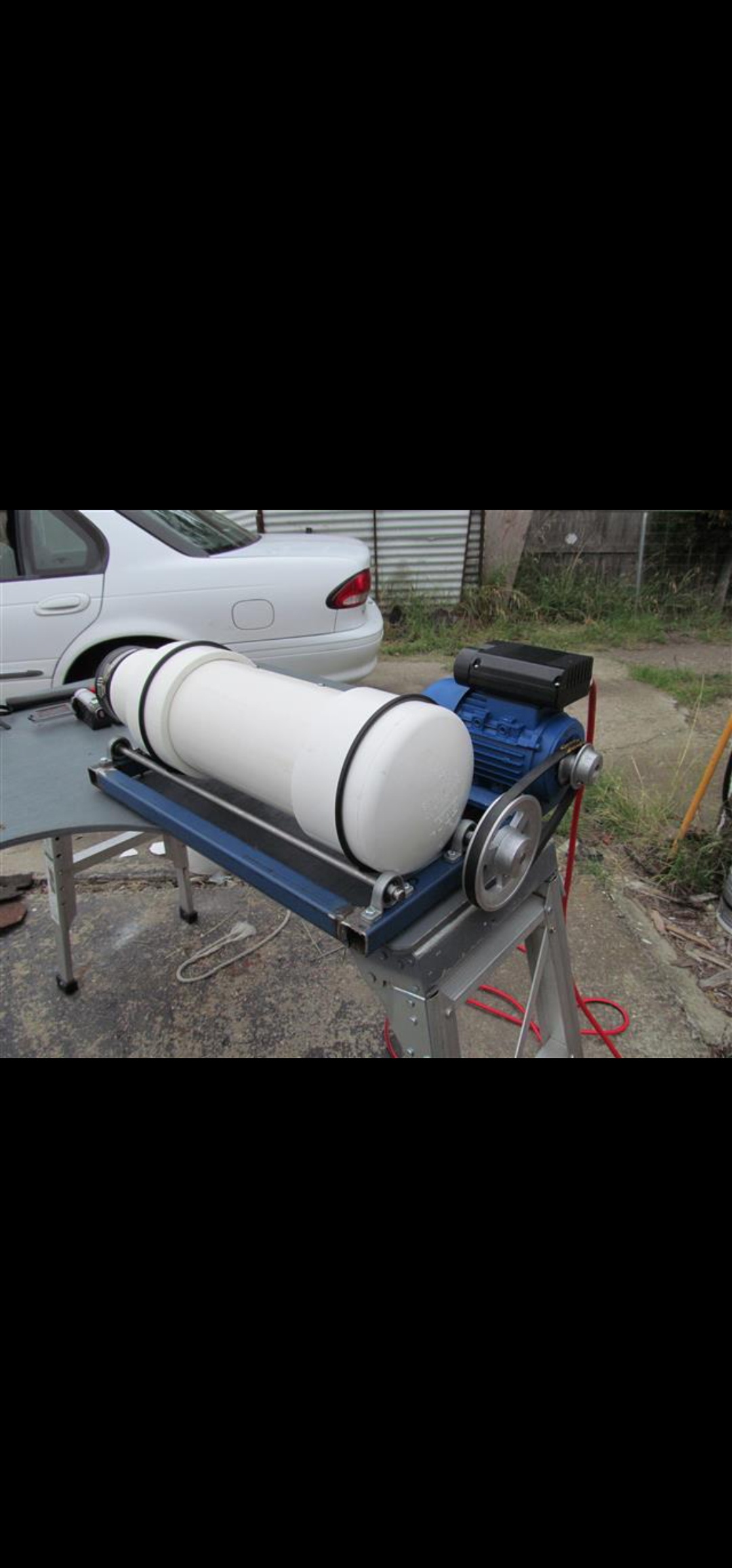

I used to wet tumble I even built one to do a decent amount.
But now I figure it APITA to do and I have not found ant change in accuracy so I don't bother.

Post by Jorlcrin » 10 Mar 2024, 5:42 am
deye243 wrote:I used to wet tumble I even built one to do a decent amount.
Where did you get the big-arsed O-Rings??
I reckon I've got all the other gear, but I'd only ever thought to put rubber on the shafts themselves.
Hmmm.... Food for thought!

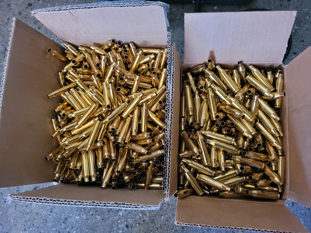

Post by mchughcb » 10 Mar 2024, 10:44 am
Another 1500 rounds cases cleaned. Frankford tumbler is not bad for batches of a few hundred at a time.
