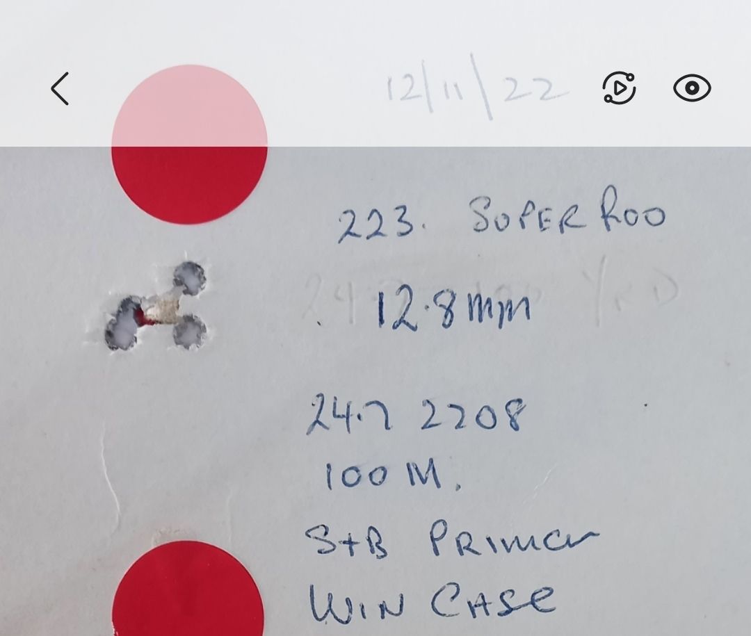

Post by Oldrooshooter » 15 Sep 2024, 7:29 am
Oldbloke wrote:AR2208 does it for me. Like 2206H, very versatile.
What powder load and COL are you useing for 55gn super roo projectiles? I have plenty of them but so far have just loaded to the specs if Nick Harvey’s Ike manual??
