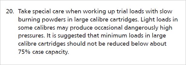

Post by Oldbloke » 06 Nov 2024, 7:33 am
If you look at the Hodgden Web site they recommend subsonic loads using 2206H with heavy bullets. (H4895) These loads are as low as about 30% of the max, not 60% that ADI talks about.
Surprising isn't it!
For sometime now, ADI states in their manual any powder can be loaded to 75% of max. This is typically well below starting loads. Look it up.
ADI 75% Minimum load.JPG (38.18 KiB) Viewed 1604 times

Post by Oldbloke » 06 Nov 2024, 8:06 am
My attachment also from the ADI manual.

Post by No1_49er » 06 Nov 2024, 2:01 pm
Oldbloke wrote:If you look at the Hodgden Web site they recommend subsonic loads using 2206H with heavy bullets. (H4895) These loads are as low as about 30% of the max, not 60% that ADI talks about.
Down loading a 7mmRem mag with 2217 might be might be another matter.
I think you have made a serious error re' the 75%.
ADI quite clearly says "should not be reduced to below 75% OF CASE CAPACITY.
It DOES NOT say 75% of maximum (recommended charge).
No1_49er
Posts: 929
Re: 30-30 level loads in 308
Post by Oldbloke » 06 Nov 2024, 2:28 pm
Your right, what's the difference?
1 grain, 2 grains?
Edit: it's a vague term IMO.
Is capacity:
To the base of the neck?
To the top of the neck?
Some max charges are compressed.
Posts: 13399

Post by bladeracer » 06 Nov 2024, 5:14 pm
How do you work with case capacity? Case capacity is measured to the case mouth, in grains of H2O, not grains of whichever powder you are using.
You can load AR2206H as low as you want to. The most that will happen is you'll see inconsistent burn and if you keep going down eventually the bullets will stop in the bore.
AR2213SC, AR2217, AR2225 are all slow powders and should not be reduced by large degrees in very large capacity cases. A few grains below starting loads is fine.
