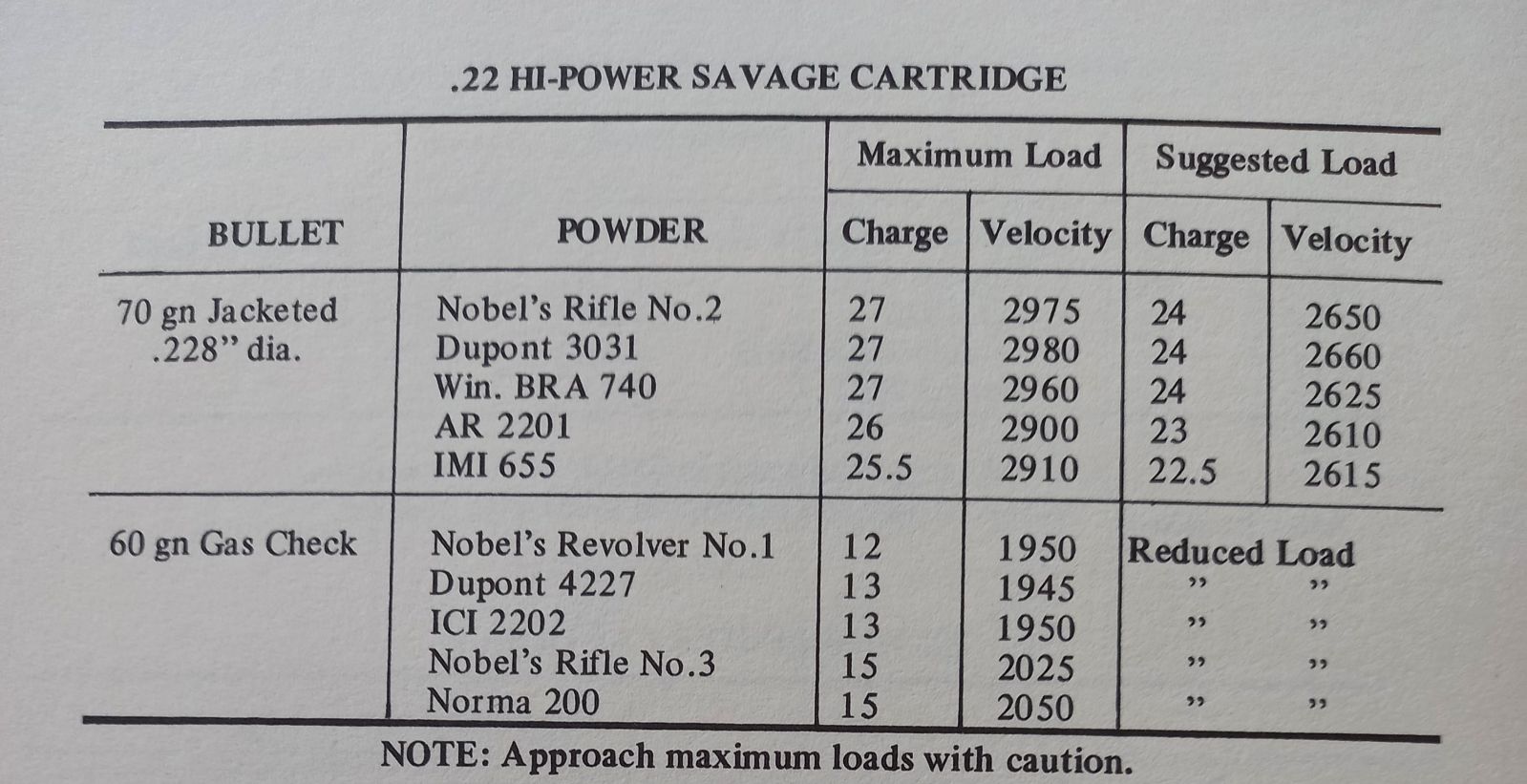

Wonder if someone could post the data page from Nick's book please on 70 grn bullets

Post by bladeracer » 13 Dec 2024, 3:07 pm
JGR1949 wrote:Wonder if someone could post the data page from Nick's book please on 70 grn bullets
JGR
Re: Nick Harvey 22 hi power
Post by JGR1949 » 13 Dec 2024, 3:27 pm
Many thanks, what volume book is that from? I thought his latest book would have more ADI powders. 3031 has always been the best powder for my rifle but can't get it here anymore

Post by bladeracer » 13 Dec 2024, 4:08 pm
JGR1949 wrote:Many thanks, what volume book is that from? I thought his latest book would have more ADI powders. 3031 has always been the best powder for my rifle but can't get it here anymore
JGR
First edition, 1980 I think. I don't have any of his later editions.
H4198 is AR2207,
H4895 is AR2206H.

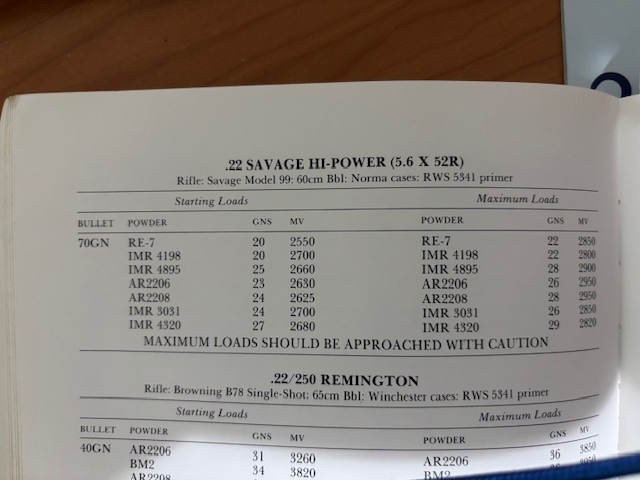

Post by bladeracer » 13 Dec 2024, 9:02 pm
A guy on FB sent me this from the 9th edition.

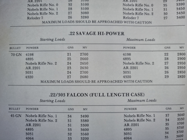

Post by bladeracer » 13 Dec 2024, 9:05 pm
And from the 6th edition.

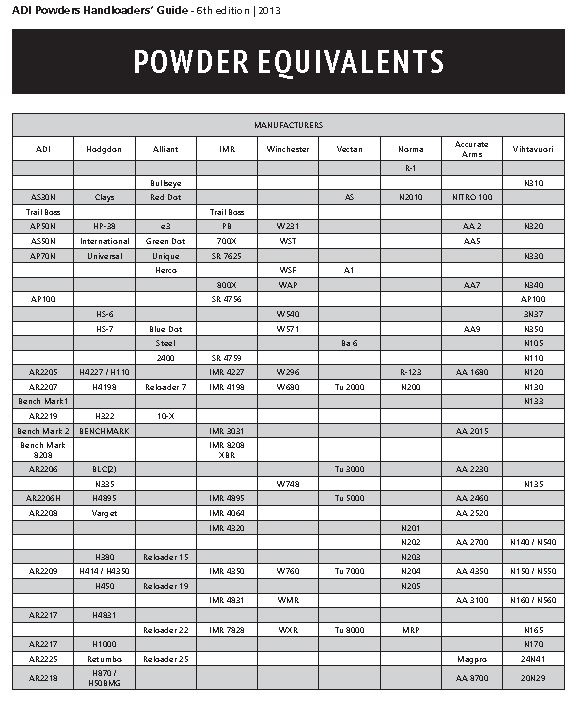

ADI Equivalents 2013 6th Ed.JPG (103.28 KiB) Viewed 9566 times

Post by JGR1949 » 13 Dec 2024, 10:47 pm
Good stuff, I threw the post up on a face book forum also and got that load from his last book its close to the Hornady book from memory for RL 7. One of those times I wish I hadn't given away all my old loading books i'm sure Reloading Simplified had a good few loads in also
Post by Over The Hill » 14 Dec 2024, 10:24 am
Another version taken from his 1993 book. The original book from 1980 was "Reloading for Rifle and Handgun" He printed a new book in 1993 "Nick Harvey's Practical Reloading Manual"

Many thanks I wonder if one could substitute 2206H for 2206 as a straight swap? ive still got a bit of RL-7 left so will sort something out. Its really only for shooting paper now anyway maybe the odd fox around the farm

Post by bladeracer » 14 Dec 2024, 1:21 pm
JGR1949 wrote:Many thanks I wonder if one could substitute 2206H for 2206 as a straight swap? ive still got a bit of RL-7 left so will sort something out. Its really only for shooting paper now anyway maybe the odd fox around the farm
Yes, you can, check the ADI FAQ.

Post by Oldbloke » 14 Dec 2024, 3:23 pm
Just keep in mind it is a tad slower.
Screenshot_20241214-162217_Samsung Internet.jpg (153.78 KiB) Viewed 9226 times
