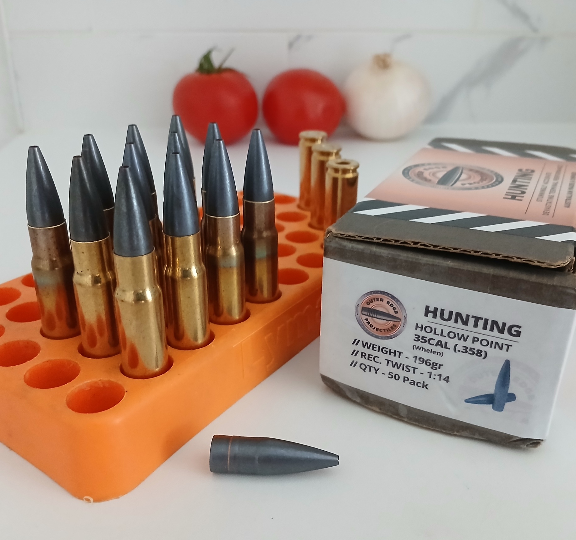

Just a quick post about the Legendary 358 Winchester cartridge and a new load I'm working on.
Aussie made 196gr 358 Outer Edge projectile with a case full of 2207, maybe just a little compressed....... :drinks:

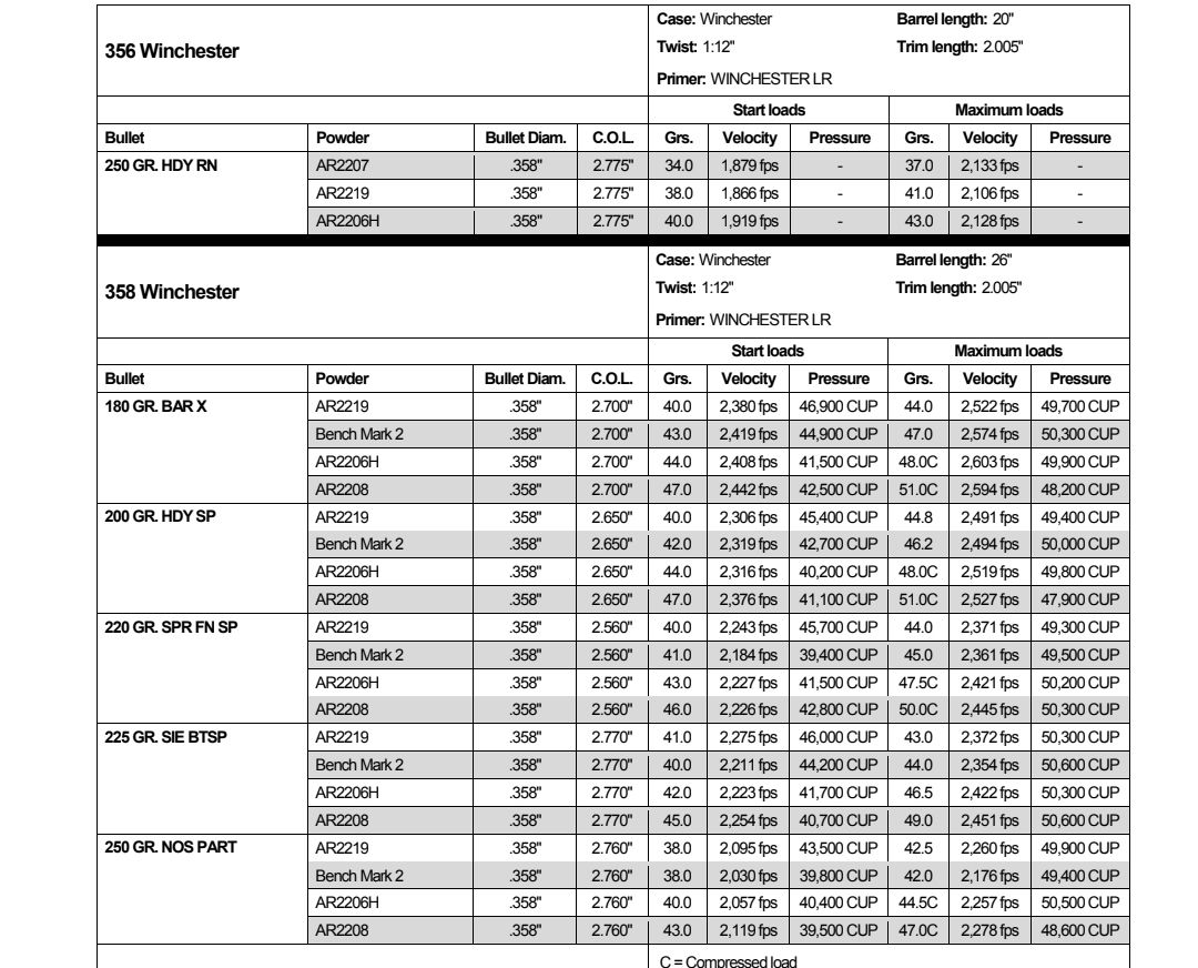

Mmmm, interesting cartridge. Would be great upto abt 200yards I guess.
Why the 2207? ADI lists slower powders.

Oldbloke wrote:Mmmm, interesting cartridge. Would be great upto abt 250yards I guess.
Previous experience with 2207 and 200gr projectiles so I already know 2700fps plus is achievable with a 20 inch plus barrel, this rifle is a Ruger Hawkeye thats been cut back to a handy 19inches, longer projectile is robbing a smidge of powder capacity so Im hoping 2600 fps is still possible.......
I do have some Reloder 10X on hand if I really want to ramp it up :wtf: :drinks:

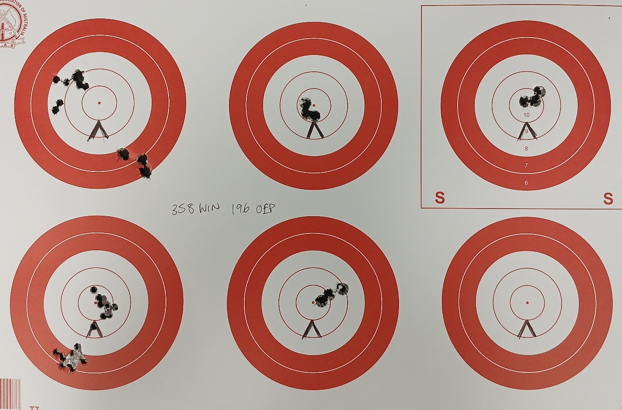

Post by Billo » 16 Jan 2025, 12:00 pm
Pretty happy with the range session at 50m, the Ruger seems to shoot 1/2 inch groups so happy days, loads were on the milder side with speeds of 2530fps recorded, I should be able to stick a bit more powder into the case just not sure I'll get the 2600fps I'd like, a mate suggested trying 2219.....

Post by Oldbloke » 16 Jan 2025, 4:48 pm
Billo wrote:Pretty happy with the range session at 50m, the Ruger seems to shoot 1/2 inch groups so happy days, loads were on the milder side with speeds of 2530fps recorded, I should be able to stick a bit more powder into the case just not sure I'll get the 2600fps I'd like, a mate suggested trying 2219.....
Yeh, you had me. Simplistically looking at ADI data 2600 seemed very optimistic. 30.06 won't do much more and a big difference in case capacity.
Yep, perhaps try 2208 or 2206H. Plenty of 2208 about.
