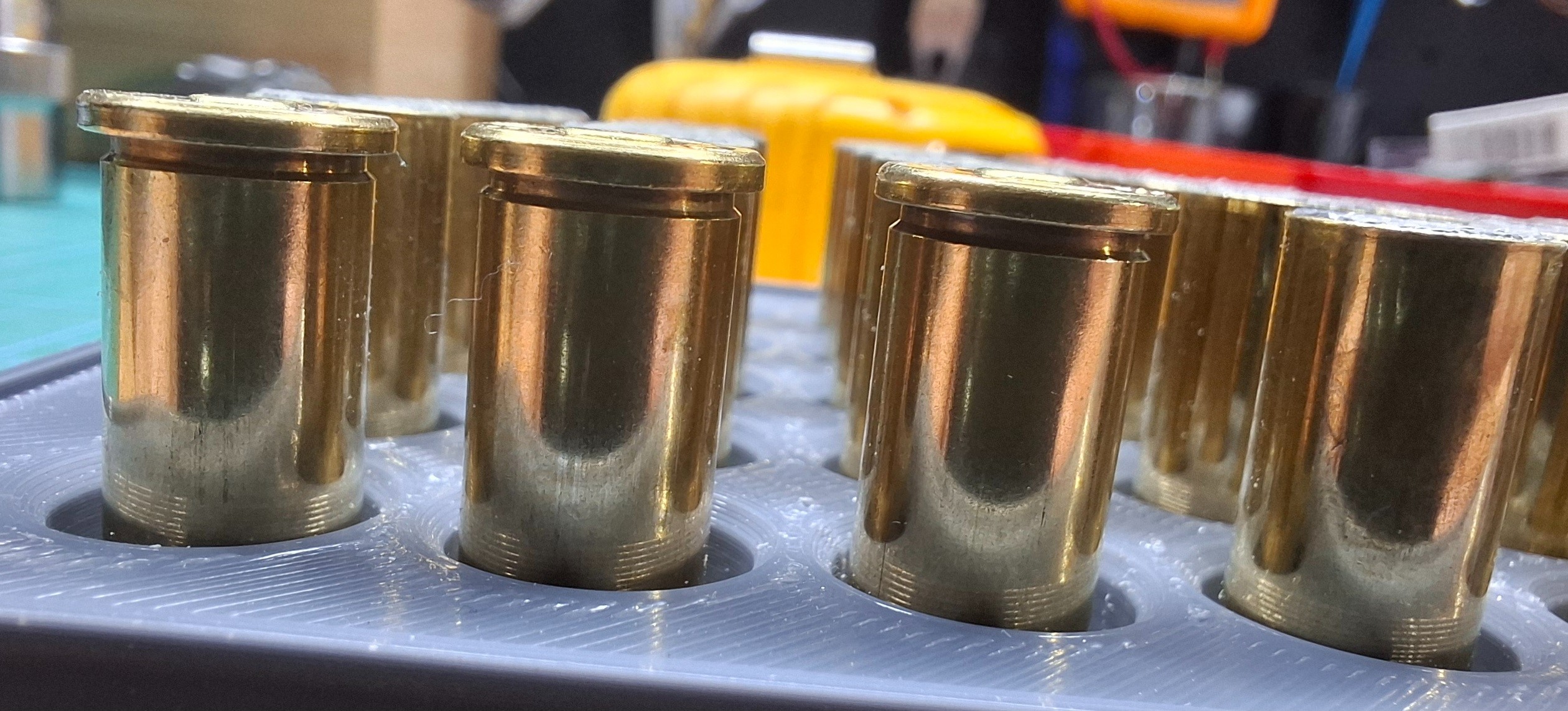

Hi all is it just me or these Bosnian Ginex primers don't sit flush with starline brass? Some of them do but rarely, and most of them you gotta push real hard on the press to seat, I can't imagine how hard would be on hand priming tool. I did measure them with caliper and it seems to be within spec? Should I be reaming starline brass?
edit - it's 38SPL using Lee challenger press. Seems like these primers are overprice POS junk

Have you taken the edge off the pocket so they can funnel in?
Even better, use a pocket cutter to cut all the pockets to consistent depth and diameter and put a square corner in there, then chamfer the edge.

I have used over 3000 spp and a couple of times had difficulty seating them. I deprime all my brass, ultasonic clean, use a primer pocket tool, then load. No problems since.

Like White River, Ginex are known to be a bit on the tight side.

They are pistol primers but like others have stated because I use press I just push over the thing like theres no tomorrow and it will go in, but in my case the primer doesn't sit flush with base of the rim somehow, luckily my colt python allows me to cock it with not so flush rim, but I did have some clearance issue when primer was sticking out a bit too much. At least all of them went bang :P
I might give that a shot as starline pockets might be shallow?

They do look like they are protruding a lot.
Perhaps try a claw hammer. :lol:
But this would seem a better solution:
"Even better, use a pocket cutter to cut all the pockets to consistent depth and diameter and put a square corner in there, then chamfer the edge."
