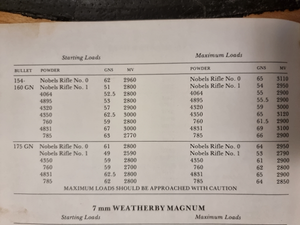

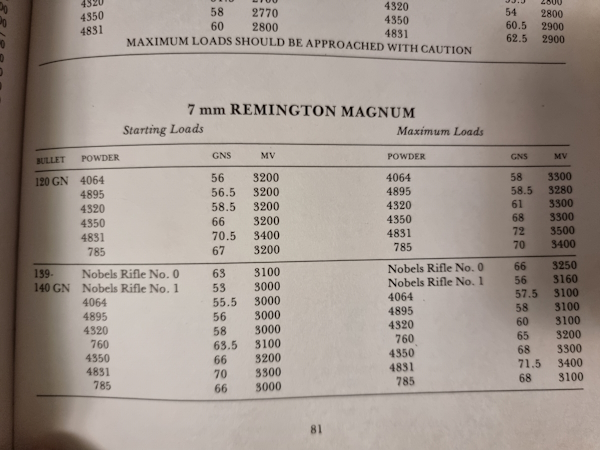

Hi, I have some ICI Nobel No. 1 rifle powder and was wondering if someone could assist with some data.
Would it have an equivalent ADI powder?
Would it be suited to be used in my 7mm rem mag?
I noticed on another forum ‘NZ hunting and shooting’ someone had an old Nick Harvey reloading manual and it had some data relating to the .223 for Nobel No 1 rifle powder.

Nick's First Edition has Nobel No.1 loads.
