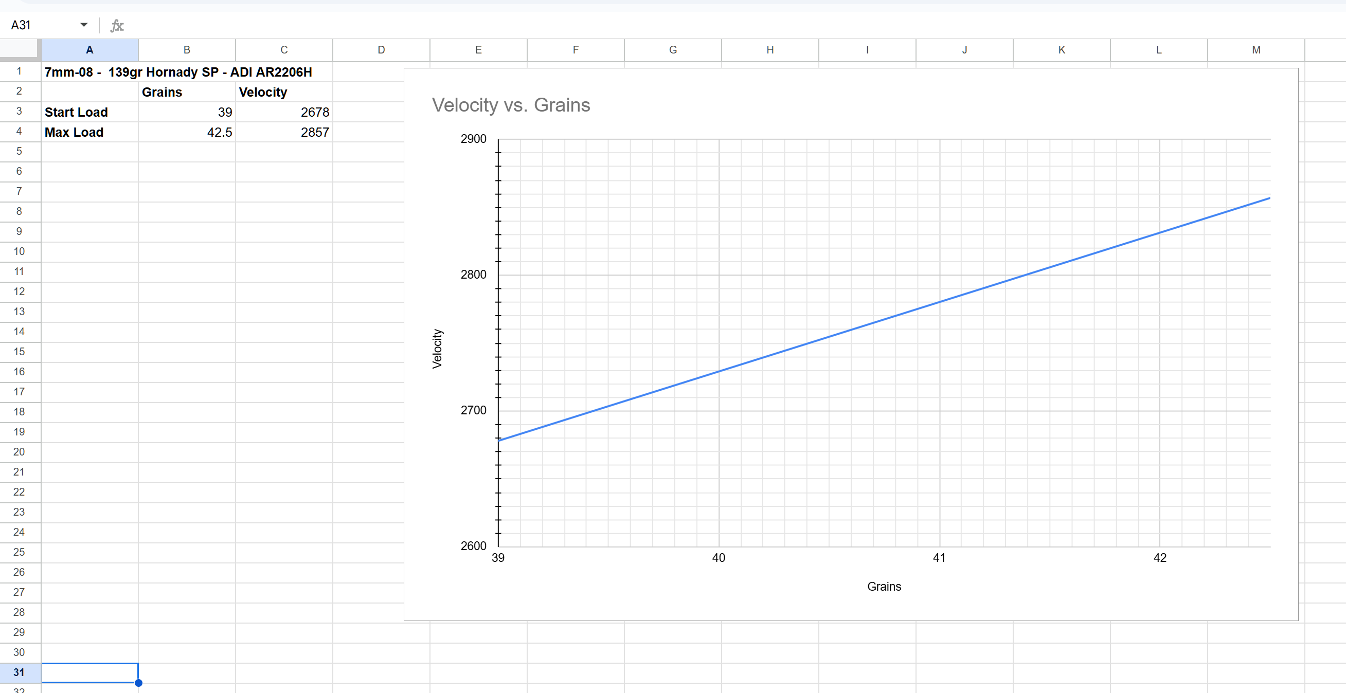

Im starting my reloading journey and im trying to simulate a Hornaday 139gr Whitetail 7mm-08 round using ADI AR2206H. Looking at the ADI data, it shows your Starting load and the Max load, is this data linear (or logarithmic)? So if I wanna hit 2840fps as per the box, I would be (based on the info) _around_ 42.15gr? Based on my calculated linear chart of the low and high attached.
Yeah yeah I know I will need to work up and test/chrono, im just curious how this matches others. I've read some people just "pick the middle" of Starting and Max, but they dont mention if their velocity matched etc.

jezzab wrote:Im starting my reloading journey and im trying to simulate a Hornaday 139gr Whitetail 7mm-08 round using ADI AR2206H. Looking at the ADI data, it shows your Starting load and the Max load, is this data linear (or logarithmic)? So if I wanna hit 2840fps as per the box, I would be (based on the info) _around_ 42.15gr? Based on my calculated linear chart of the low and high attached.
Jez
No, pressure builds additionally as you reduce case volume by adding powder. Work with a chronograph if you need to replicate an existing load, you will have to chronograph the factory load in the rifle first to know what velocity it makes. And keep the brass the same, ie - all fire-formed or all full-length-sized.

Ok, so its logarithmic. You could never "assume" that (Start load + Max Load )/2 (ie half the both/middle) will be half the velocity?

jezzab wrote:Ok, so its logarithmic. You could never "assume" that (Start load + Max Load )/2 (ie half the both/middle) will be half the velocity?
I would say no. If you increase from say 20gn to 21gn you'll see an increase in pressure and velocity, if you then increase to 22gn you will see an increase that is greater due to the decreased volume. As you approach the pressure limits (where you start seeing signs of excessive pressure), say 25gn, just a tenth of grain more might push you into high pressures. I don't load anything as hot as factory ammo, except the .204, but it doesn't give me any pressure signs and still has good case life.
Don't get too caught up in chasing velocities. The difference between a starting load and a maximum load might be 150fps or less, which might equate to you being maybe 50m closer to the target, or less, for the same terminal velocity.

The answer is they are not linear between min and Max and you can verify measuring the velocity versus grains. I just did this he other week and a log best fit will give a more accurate curve.
