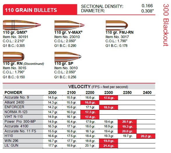

Hornady Black V-Max 16" barrel ballistics chart indicates Muz Vel of 2375fps.
Here's some additional powders from the Hornadys reload manual based on a 16”, 1 in 7.5” Twist rate. 2400fps is a stretch.
