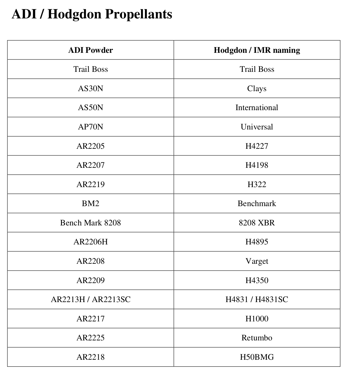

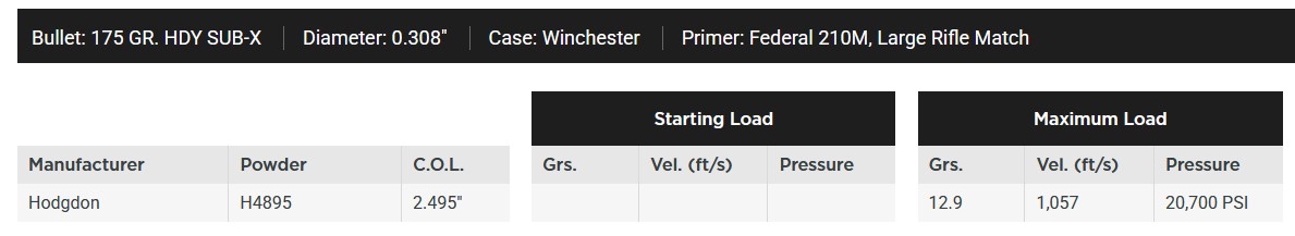

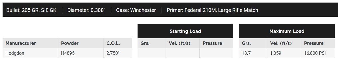

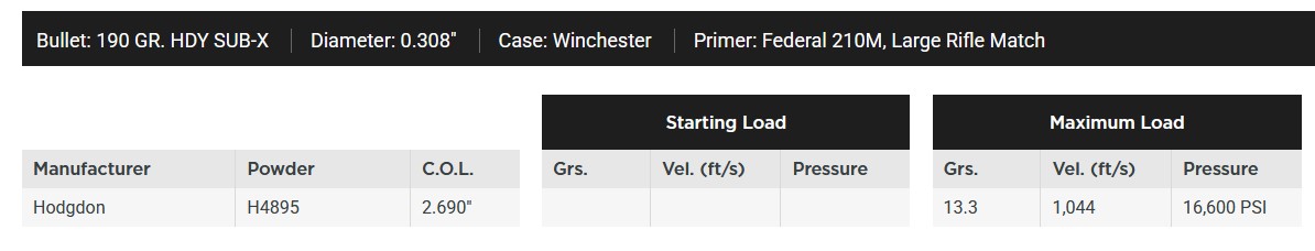

Regarding load data with AR2206H and 125gn, with the bullets seated as deep as possible, I would start with around 20gn over a chronograph first and work down until you find where you want to be. Then I would load ten at that and shoot them for groups as well as over the chronograph to see if they're accurate and consistent. Barrel length will play a very significant role if you want all your shots to remain subsonic so chrono the load in any other rifle before assuming it will be subsonic. If you expect to ever need to use the load with a suppressor I would drop the the velocity further, to around 1050fps, to ensure the suppressor doesn't punch it up to sonic velocities.
I just had a Google, this guy tested subsonic H4895 behind 190gn jacketed bullets - https://ultimatereloader.com/2023/08/18/amazing-308-subsonic-loads-and-fun-too/ He went too low though and got poor results, but doesn't seem to have tried to improve the load at all. He used Hodgdon's data, with an expected velocity of 1044fps, but it only gave him 802fps and he left it at that. I think he let himself down by not doing any further testing with it. He went with Trailboss instead, which is my first recommendation, if you can get it.
Hodgdon claims 24" barrel length for this data but I don't believe that. Start high (especially if you have a long barrel) and work down, or take a rod with you to punch the bullets out of the barrel. I doubt shooting subsonic loads has any detrimental effect on the brass (quite the opposite I reckon) but I like to keep my subsonic brass separated from my high-velocity brass just for consistency. I figure if I work up a load that is just subsonic, then fire a full-noise charge in that case the case will probably expand more, increasing its volume so when I then load subsonic I might see a discrepancy - I like consistency.
