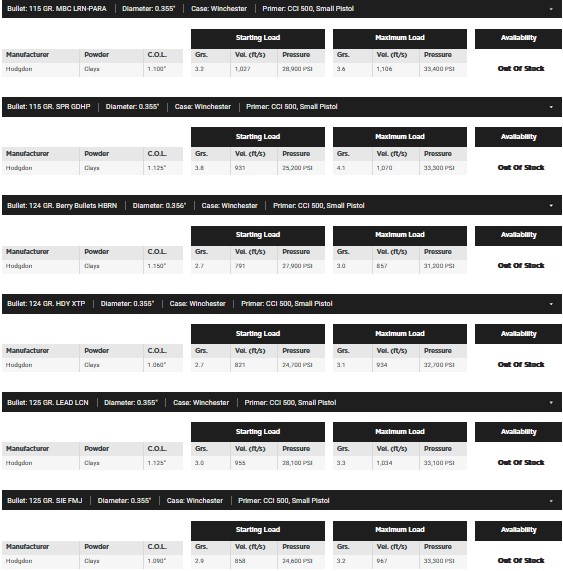

AS30N was sold in the US as Hodgdon Clays so you could look for Clays data. I haven't seen the APS-series showing up in the US yet so don't know what they'll be calling them.
A quick search brought up a thread here where 3.2gn of AS30N ran fine for two shooters with 115gn bullets.
https://enoughgun.com/forum/viewtopic.php?f=3&t=14868
This is Hodgdon's Clays data:
Screenshot 2026-02-08 184949.jpg (85.66 KiB) Viewed 40708 times
Screenshot 2026-02-08 185015.jpg (72.57 KiB) Viewed 40708 times

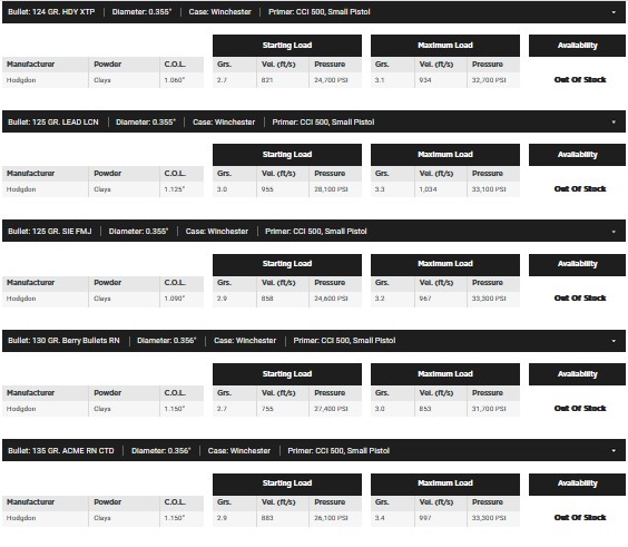

They go up to 4.1gn for the Gold Dot 115gn so I would just increase the load further. Do you have a chronograph? Did you actually chrongraph that 115gn factory ammo at 1330fps in a pistol? That would be a PF of 153!

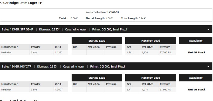

This is their Plus-P data, which would be over 130PF so would be pretty hot stuff:
Screenshot 2026-02-08 191525.jpg (46.67 KiB) Viewed 40708 times

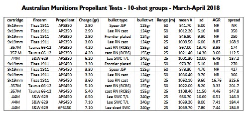

However, this early test of the new APS350 found that 2.9gn ran just fine with 125gn bullets (cast and jacketed). This was 2018 though, before the 2019 problems appeared - they may have changed the formula before APS350 was re-released last year.
https://www.adiworldclass.com.au/wp-content/uploads/2019/03/17-2019-australian-new-zealand-handgun-new-propellants-from-australian-munitions.pdf
Screenshot 2026-02-08 192817.jpg (65.11 KiB) Viewed 40708 times

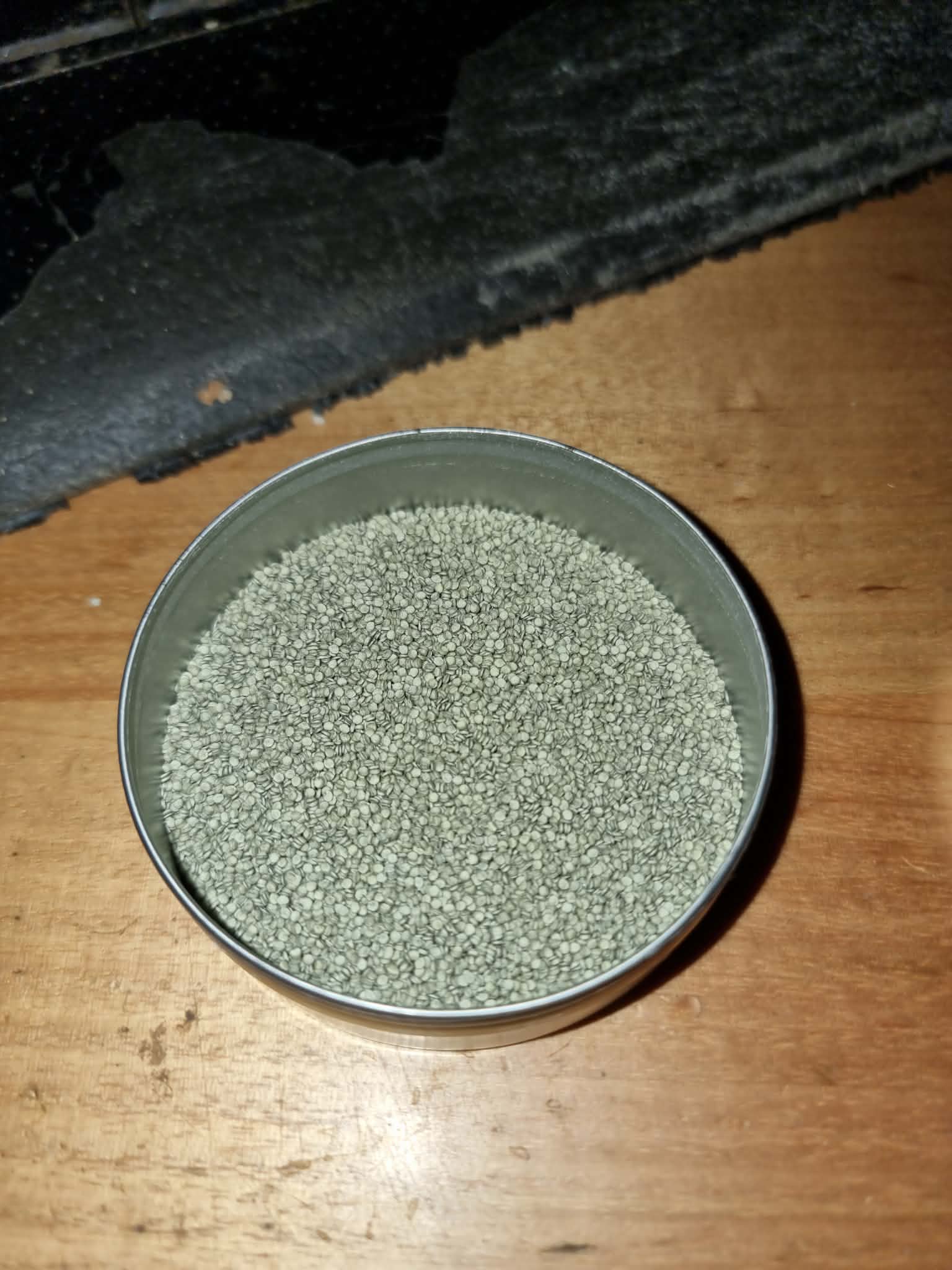

No worries. A mate has given me a small amount of APS350 tonight to test so I'll try to find time to load some 3.2gn rounds and see if they cycle the Hi Power, and what velocity they make. I'm loading at 1.090" with the 115gn bullet, .40-thou deeper than you so I would be making more pressure. If you seat yours down to 1.090" you'd be getting more pressure out of your 3.2gn loads.
The powder he's given me is quite grey and closer to a ball powder than a flake like the AS30N. I hope he's given me the right stuff, is this what yours looks like?

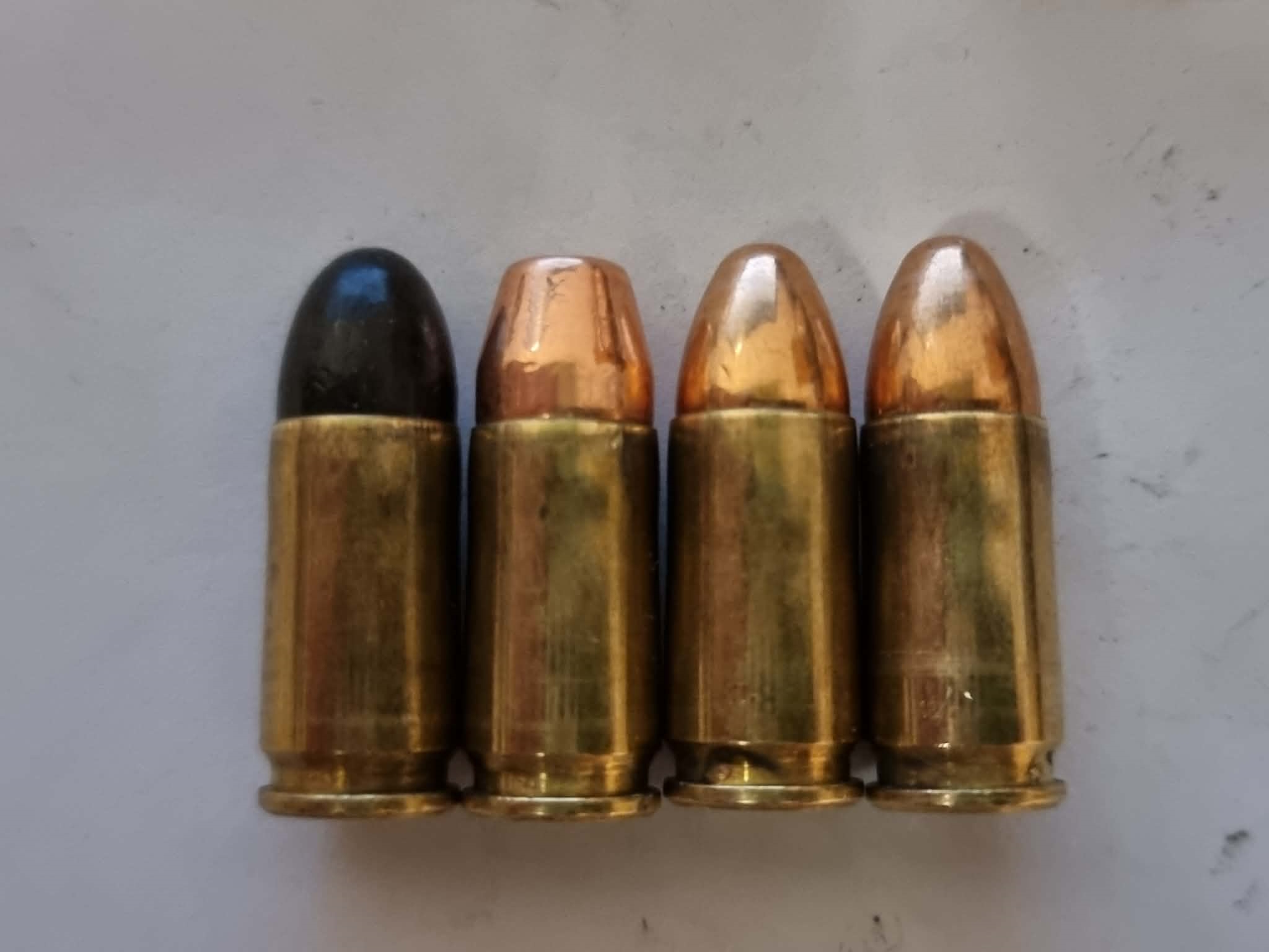

Re: Q re ADI powder specs
Post by bladeracer » 10 Feb 2026, 4:00 pm
9mm test loads 3.2gn APS350.jpg (436.22 KiB) Viewed 40381 times
Got some loads to test tomorrow.
115gn HRBC cast RN at 1.100"
125gn Berry's Copper-Plated flat-nose .358" pushed through the .356" die at 1.080"
124gn Winchester FMJ at 1.129" and 1.100"
The FMJ has such a long ogive that I can actually seat it right out to 1.268" in the Hi Power.
All on 3.2gn of APS350.

bullet length is .600..your powder looks the same as my 350
I only chose the length of the rounds because its the length of the factory ammo which has cycled faultless-ly..
I'll take your advice though and seat them slightly deeper tomorrow with some 3.4 loads and see what happens..
I might look around and get some 115 projectiles to try as well..honestly didnt think I'd actually enjoy the handloading side of things this much..Though I really should get a chronograph at some stage soon though.it would be even better if we had a range that was open on weekdays as well....but then again I'd probably end up divorced if I shot even half as much as you do...

deye243 wrote:Br where did you get the Berry's Copper-Plated flat-nose reason I ask Darren down in South Australia is not doing boss component bullets anymore
Cleaver had a deal on them a few years ago so I bought heaps (the plastic boxes are great too), as well as the CP HP ones and their Hardcast 158gn bullets. I like Berry's as they shoot very well for me in everything, but I'm using HRBC now, got another 30kg arriving from Les this week. Early last year I was ordering 5000 Berry's from Cleaver but they were stuck en-route for weeks, so they offered me a great price on Boyne Bullets, of which I still have a couple thousand left for the .38's for Cowboy. But I need a wadcutter now for ISSF matches, so Les has done me a batch, as well as some 240gn .44Mag semi-wads sized down to .428" for the .44-40's for ISSF Classic Pistol matches.
Post by bladeracer » 10 Feb 2026, 10:57 pm
fnq22 wrote:bullet length is .600..your powder looks the same as my 350
I might look around and get some 115 projectiles to try as well..honestly didn't think I'd actually enjoy the handloading side of things this much..Though I really should get a chronograph at some stage soon though.it would be even better if we had a range that was open on weekdays as well....but then again I'd probably end up divorced if I shot even half as much as you do...
I rang him today and he confirmed it was definitely APS350 :-) I think I like it as it's not very dense - 3.2gn more than half fills the case (the S&B brass holds 6.2gn level to the top), so a double-load should be obvious from the spilled powder during loading. I'll have to get some more and do some testing with it, it might work well with the 100gn wadcutter .38's.
I figured your 125gn bullet would be fairly similar in shape to the 124gn FMJ (which is .592"), so seating them at 1.129" gives me the same combustion chamber volume as you, but pressure won't be the same, because jacketed versus cast. If you want I can still load some 125gn .358" FPRN's to give the same case volume, but they'll be way too long for the Hi Power. I didn't measure how far out I can seat them in the Chiappa adapter but I could cut a groove around the bullets to stop them digging into the rifling if it's a problem (which would also allow me to shoot them in the Hi Power barrel).
I would load ten rounds with the 3.2gn but seated at 1.100" or so, and manually run them through the pistol to ensure they feed okay, then shoot them. If it's still not cycling reliably then up it to 3.4gn.
I've found the chrono much more useful for pistol loads than for rifle loads. It's handy to know how fast they're moving, and for comparing with other loads. In pistols the velocity is more important to know, for Power Factor reasons at least.
