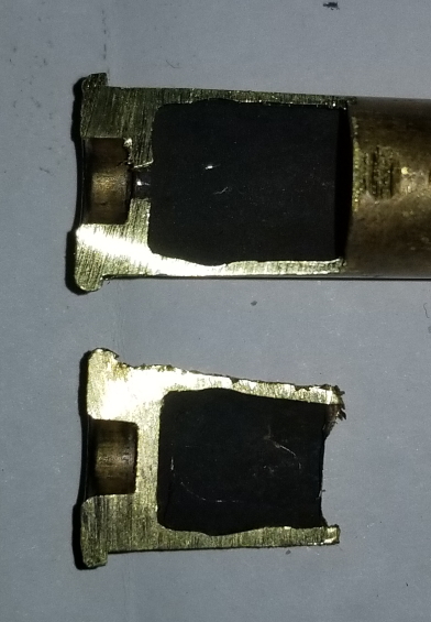

Annealing can definitely be useful, either to have consistent neck tension, or to extend the life of expensive brass. I only do it for forming one case out of another case. I don't run most of my brass hot, not even close to factory levels so it lasts a long time. Even my .303 necks last to within a couple of loads of case separation so there's no point in annealing, annealing won't prevent separation. When the necks split, sectioning the case shows it only has one or two more loads left in it.
